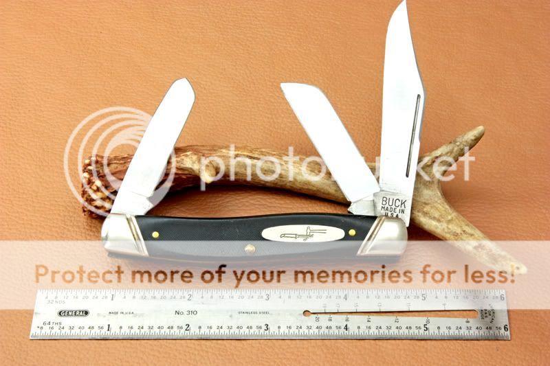

This one throws a wrench in the pattern as it's a 1999 Camillus made Buck slip lock and still has the full flat grind. DM
Hate to throw a wrench at your wrench, but if that's a #334 Millenium Trapper, (smooth black scales tells me it is), according to the database provided by 300bucks that model was made by Buck, not by Camillus. I can't upload the pdf of the document here, but I checked the entire spreadsheet and that's what it says about that model; perhaps 300bucks will pipe in and confirm? I know that they used hollow ground blades on other Buck-made Trappers, ie; #312 & #314, but they obviously used flat ground on that knife. On the spreadsheet the #334 was listed as one of "Chuck's Bucks".
The #329 Trapper was made by Camillus, but it was an SFO for SMKW, and was never in the Buck catalog.

Thanks for the save 300, I only know what I read in the database. The #334 is listed as made by Buck on the document titled: "Buck300ListD"; I will make the necessary correction on my copy to avoid future confusion. At least I identified the knife in the photo correctly. Thanks again 300, (or should we call you Yoda?).
Saying, '--those 334's with serial numbers stamped in the bolster, Buck's Limited Edition emblems and the inked wording on the blades are complete and correct.' Complete in the manner they came forth from the Camillus factory. Those lacking any of these items are to be looked upon as parts made by Camillus then sold as parts after they closed their doors in 2007 and later (possibly) assembled by someone else. DM
Since, we don't know if these above mentioned 334's were unfinished knives, rejects or parts assembled later. They still should be viewed as Camillus made knives. This is a odd example but 'these type knives' were covered in a discussion on the 307. As some of these appeared later in the same manner and were considered as Camillus made. DM
Here's another 334 from parts. As you can see didn't get the emblem but it had been already cut for it.
