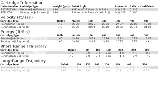

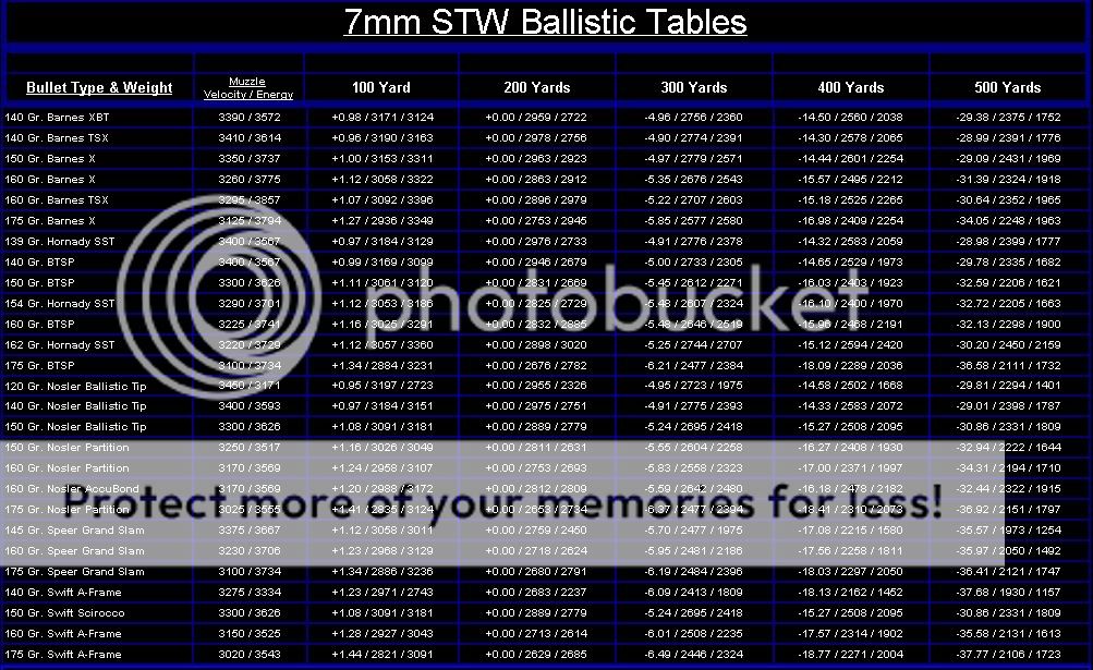

My vote will go for the 7mm STW. Why? Because even if you don't hit the thing the boom and thunder rumbling through the hills and valleys will scare whatever your hunting, and everything else, away:D
No, the real reason is because its what I have:p Even better right:eek:
Remington's Ballistics for 7mm STW
If you haven't yet and you are interested in Remington's ballistics check this out.
http://www.remington.com/pages/news-and-resources/ballistics.aspx
