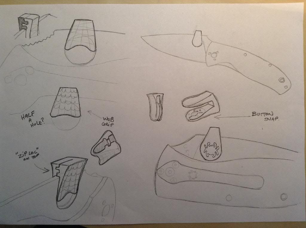

Hey there , recently i was wondering if a custom
Wave mod add on could be printed ?
Just thought id share my thoughts .
Maybe it would connect through the spydie hole like a
Button snap ?
Or connect above the spine with an interlocking " zip lock" type
Connection ?
I was thinking the finished part could flare out either side to provide
Nice thubstud effect . possibly with some texture. And hopefully wave nice ?
Just thought it might make a interesting discussion ?
Also if anyone has a printer and would like to try making one .
I could try designing one with cad ?
i thought about adding a curve , it might well need it , but noticed how a cable tie protrudes sideways and catches quite well .

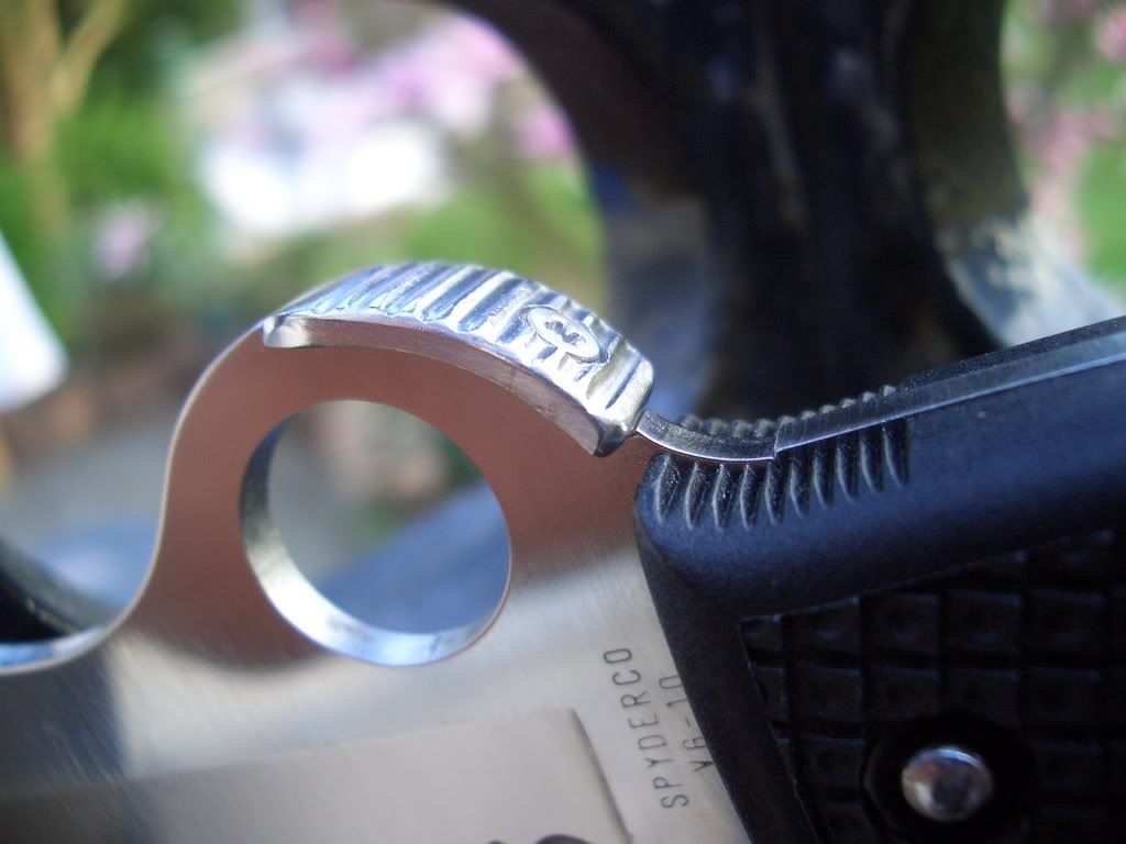

Either the spartan, ak-47, or espada. While those do work well in my experience, nothing waves like an emerson
I have access to a printer but I'm not seeing from your drawing how the "zip lock" would work. If you can design it in a CAD program I can have it printed.
Also please leave the spyderco logo off, I know its cool, and if it was a private owned printer I'd be cool with it, but its not my printer, I just have access, so I'd rather it not have another companies TM.
Hey sure sounds great , really just thought this up . Very much a concept stage.
Didnt really figure out the ziplock aspect , i thought some type of barb ? Maybe a mushroom
Shaped peg and a hole ? Not sure what would work best really .

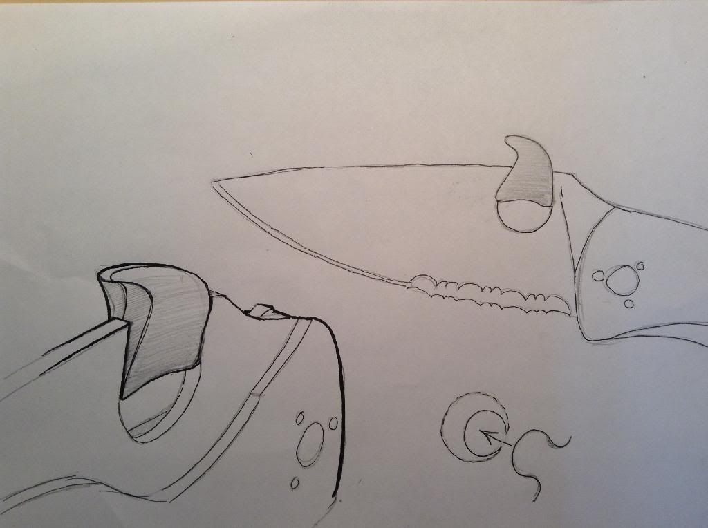

I think the ideal option would be a hybrid of the spyderco Cobra hood, with an extra protrusion forming the wave hook:
It would then be either hot glued or epoxied directly onto the thumb ramp.
Just made another quick sketch , maybe it would lock together
With a mushroom peg in to a hole ?

At the part that rests inside of the hole, that your thumb would hit if you intended to open it by hand, i would put a shelf, or stepping, or just more of an edge vs smooth so you can open it better.
your drawings are very useful, However I wouldn't think you would need such a large hook shape, rather just a straight edge closer to the spine at an acute angle would catch really well, or maybe keep the hook but shirk it ever so slightly.... just some thoughts.
I think your right pete , i might scale back the hook a bit .
A bit more edge inside the hole might be a good idea also .
