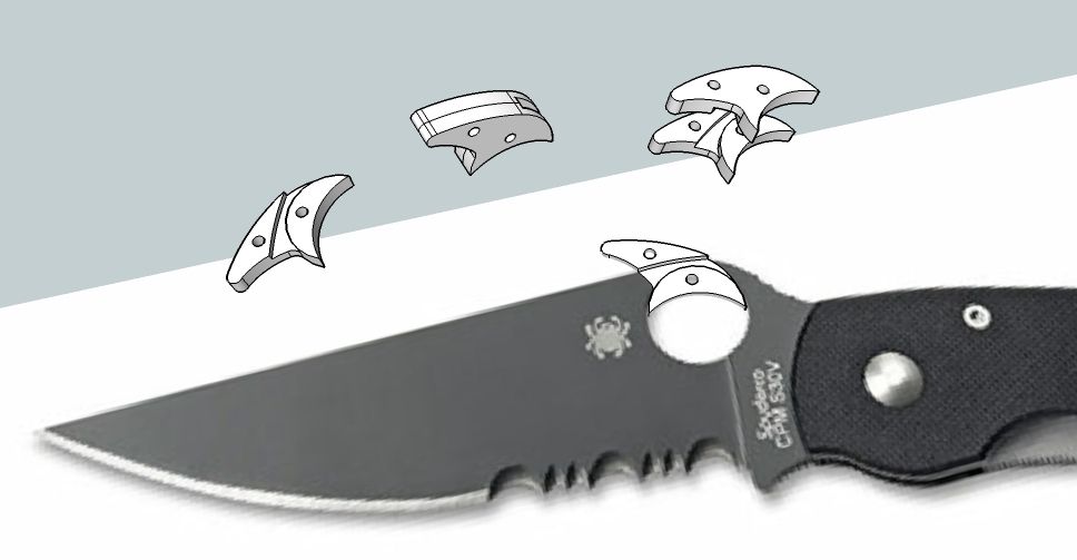

3d printable wave mod
Looks very Effective, How robust will the plastic be with regular use?
I have no personal experience with 3D printer plastic, honest question.
I am sure though, a similar design CNCd out of Aluminum with a screw fastener would be plenty strong.
Not very, unfortunately. 3D printer plastic becomes progressively more brittle over time. As neat an idea as this is, I think a thick leather one would be more durable if you'r looking at a snap as a fastener. My $0.02.

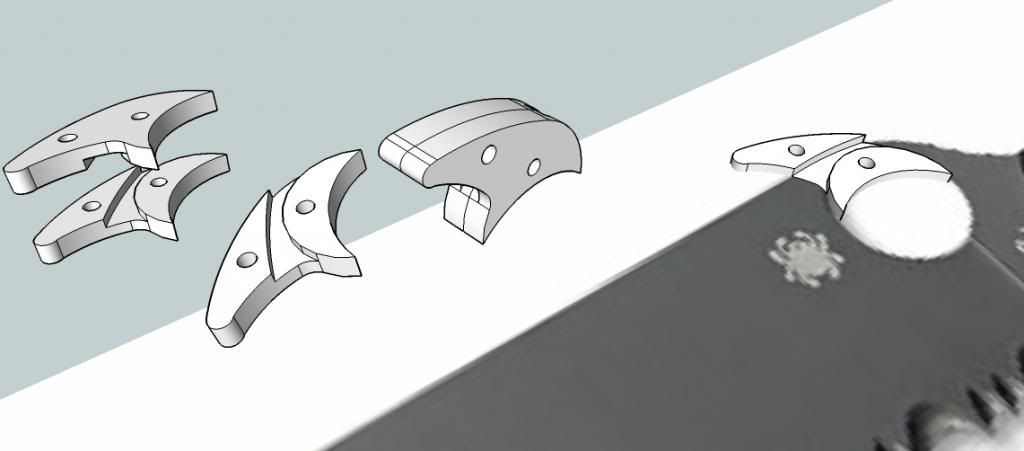

bit of modeling
I would put a rounded but textured edge where your thumb will contact the wave when manual opening

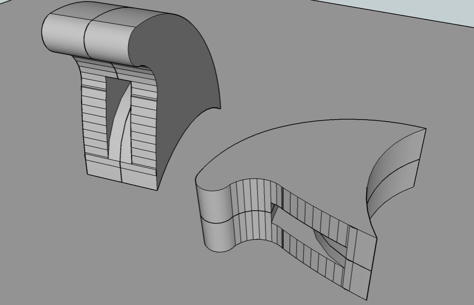

bit of modeling

You would need to custom make these for each model since all the holes, material left around the hole, and thickness of the blade are all different on each model.
Cool idea though.
Sorry if this has been covered, I admittedly didn't read the whole thread...
Cool idea though.
I was waiting for someone to point this out. I'm not much into waved knives but this looks like a fun project. Maybe screwed together with spacers is an adaptable idea.
You have a good point there , i think if the concept worked the numbers and values could be re tweeked for any knife
With a hole . The beauty of printing is the lack of re tooling .
Ive based this deign on the tenacious being so popular , im kinda hopeful it might fit on other modles ?

i rustled up a sketch that would fit on the military 2 also suggested a couple of screw locations for some T6's .
Sazbo has a very round part there , looks like it would have
To be longer for that knife . So it wouldnt slip back ?
Looks like every case is different .

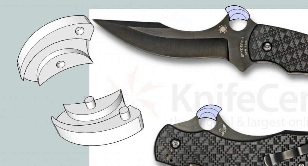

Seeing this made me think of my own design for a pocket opening device make of steel, clamped on both sides allows holes to line up and a steel pin gets inserted to hold it together... Not that it makes sense without illustrations and not that it would be practical, BUT it would not be an Emerson Wave. :)
As far as I know all the printer plastic is the same and has a tendency to become brittle with time. Idk that for a fact though. It's my dad's word on it, as he does 3D printing at his job, but I have no first-hand experience, so fwiw...
I don't know why you couldn't put them to a DXfile and have them laser or waterjet cut out for you from titanium, or aluminum or G10 or Carbon Fiber for that matter.
