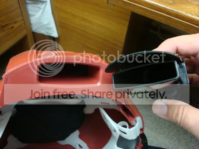

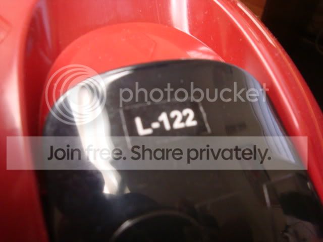

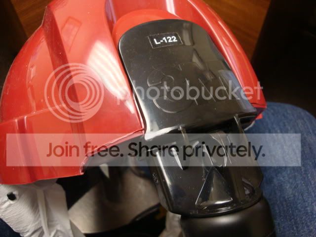

Here is the part I was talking about above. The hose snaps into the helmet in the back if you have the same helmet as mine.
The part is labeled L-122 hope this helps
Ed, I'm not sure. I've looked up the part number of the hose required for the helmet I bought, and it doesn't look anything like that. I'll have to see when the helmet and unit come in. Anytime you need anything out at the shop...give me a call! I may just suck it up and buy a forge rather than build my own. I really, really like the look of Darren Ellis' 8-HT forge. Then I can build up a PID controlled system for it.
--nathan
I think that you are right now that I've had a second look.

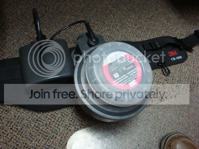

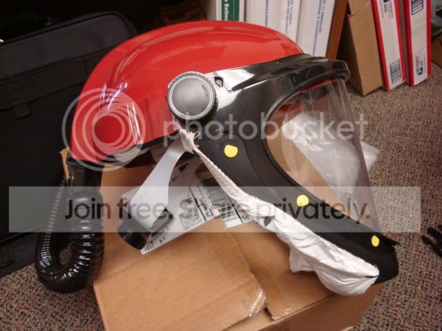

Heres the rest of my rig.
Oh yeah, you have the GVP series PAPR. A little bit different design to do the same thing. Looks like a great unit. I like the idea of only buying one cardridge instead of three.
--nathan
