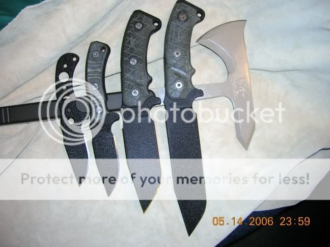

Here is the 4 that I have...note that the larger handled knives are shock proofed with a rubber insert between the scale and the tang.:
I guess to answer you question as to why more companies don't use it. I suppose because it is kind of hard on the machines and grinders, it can't be differentially hardened, and its not a stainless steel, but if you keep them clean and lubed then not being stainless is not a problem to me.
