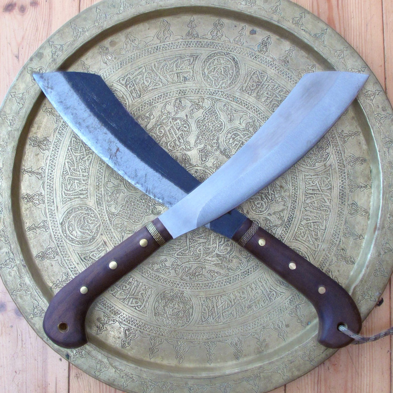

My newest chopper is a Condor Mini Duku in 420HC. Here it is with the original in 1075:

Yeah, Condor makes good use of 420HC in their stainless versions of their chopping tools. The original Matt Graham Primitive Bush Knife (with the wood scales) was 420HC.
