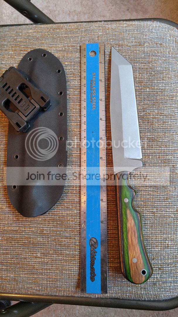

I make stuff at exactly that price point... This one is A2:
