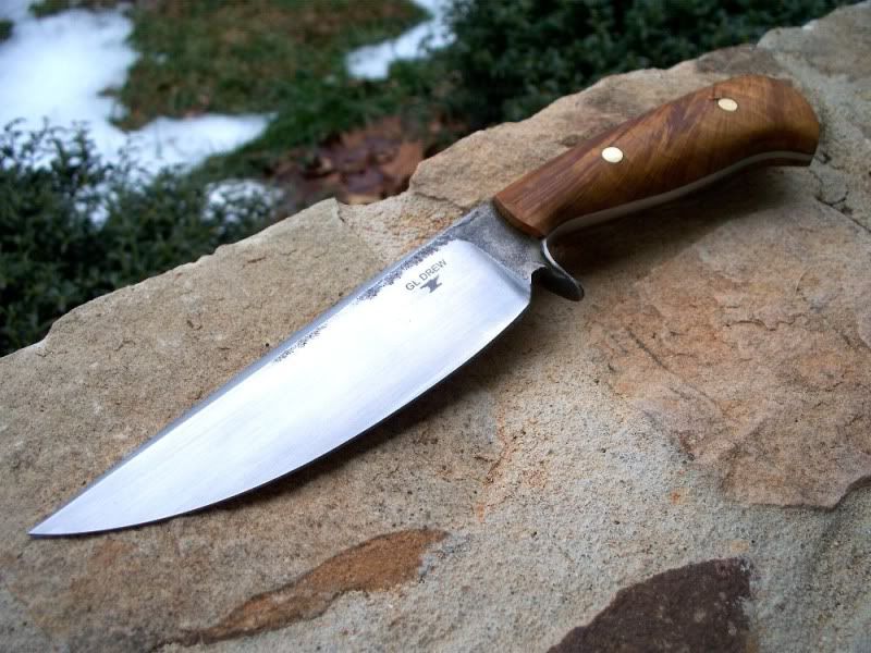

I salvaged some crotch crab apple from my son's fish smoking wood pile. A very dense and hard material. This wood has been drying for over a year and was stabilized in my shop with a mix of linseed oil and poly in a vacuum jar.
Forged from 1/4 inch 5260
Flat grind
Distal taper on the tang and blade
Hand sanded to 600 grit
Forge marks on the flats
Integral Guard
Crab apple handle
Overall length: 10 3/4 inches
Blade: 6 1/8 inches

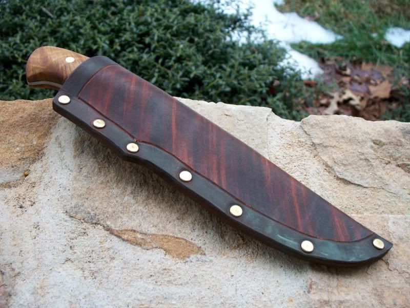

Riveted leather scabbard
$165 -----SOLD----delivered to the US or Canada. My PayPal account is gldrewknives@yahoo.com I will also take a USPS money order a check with time to clear.

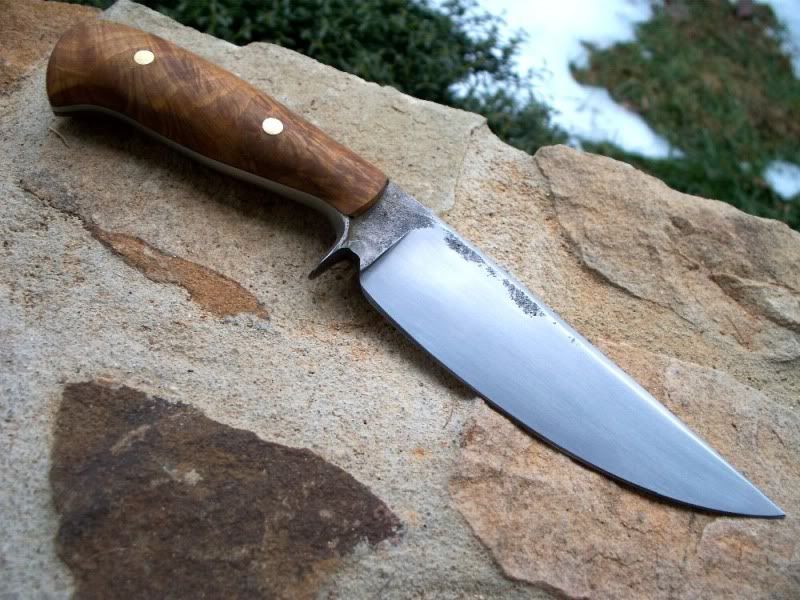

On the second photo, next to the back pin, is that either a mark on the photo or something on the knife as opposed to a crack?
