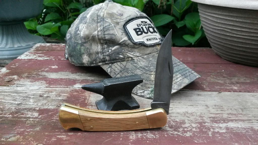

My 5160 102 has a nice patina forming. I’ll dig it out later and snap a pic.

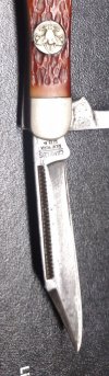

2 days. I washed it with rubbing alcohol first. I didn’t want to smear the lines so I stuck it in and left it alone for 2days. I used a Vidalia the double center was just lucky. The big knife in this picture spent 2 days in a Spanish onion.

Yes that’s the picture when it was new and shiny. That is the meal that gave it the patina it has now. About 8 servings over the course of a week last March. The first picture I posted was taken a week after this picture was.
I’m already thinking about which knife to use next March.
Looking closer at the picture I realized the blade already has a patina starting. The picture was from the second day of the process.
The key to an even natural patina is to wipe the juices over the whole blade otherwise it will look splotchy.
