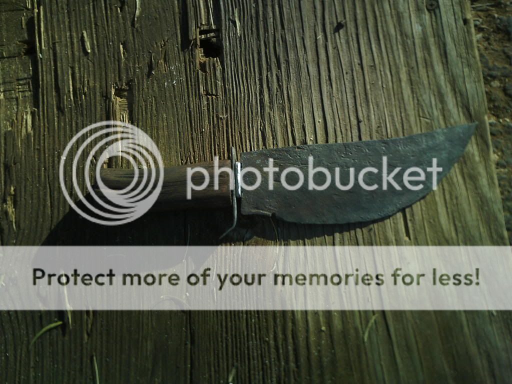

Ok.. here some photos and video's of the progress on the bowie which has come a very long way thanks to the help of my beautiful wife who was not filled to too much pride to let me video her not all dressed up. LOL
She didn't give me permission to post the video of her making the handle, but I am doing it anyways.
She's working the handle here.
http://www.youtube.com/watch?v=KCzcIXJZoW4
Here is the handle she chiseled out we are drying the midwax mahogany coat, and will be putting on the protective coat when it dries.
http://www.youtube.com/watch?v=w8eyDwFaZzg
Here I am normalizing to north as you can tell I was explaining to my wife with my hand gesture pointing to magnetic north. I used my cell phones digital compass, but am going to be ordering a survival compass soon enough.
http://www.youtube.com/watch?v=NcMfV6X_CRk

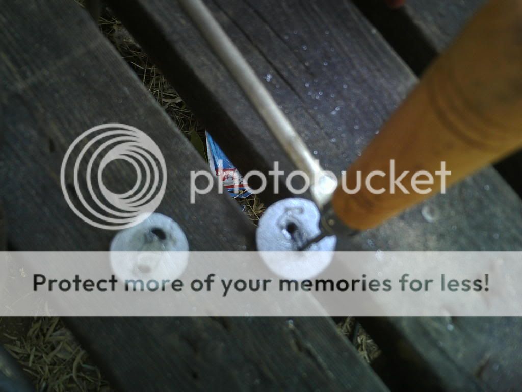

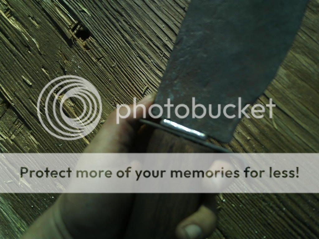

Here I am putting on the ingut I sawed, and filed to fit good and tight.
Notice where the ingut meets the ricasso. I recessed the ingut into it for a nicer fit much to the same Tim Lively does his knifes.
http://www.youtube.com/watch?v=aLVkgG2U52c

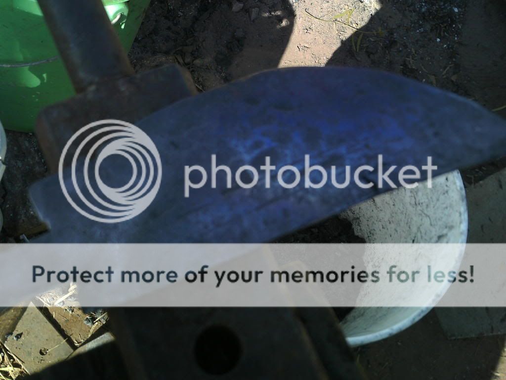

Normalized the first time.. blades pointing to magnetic north.

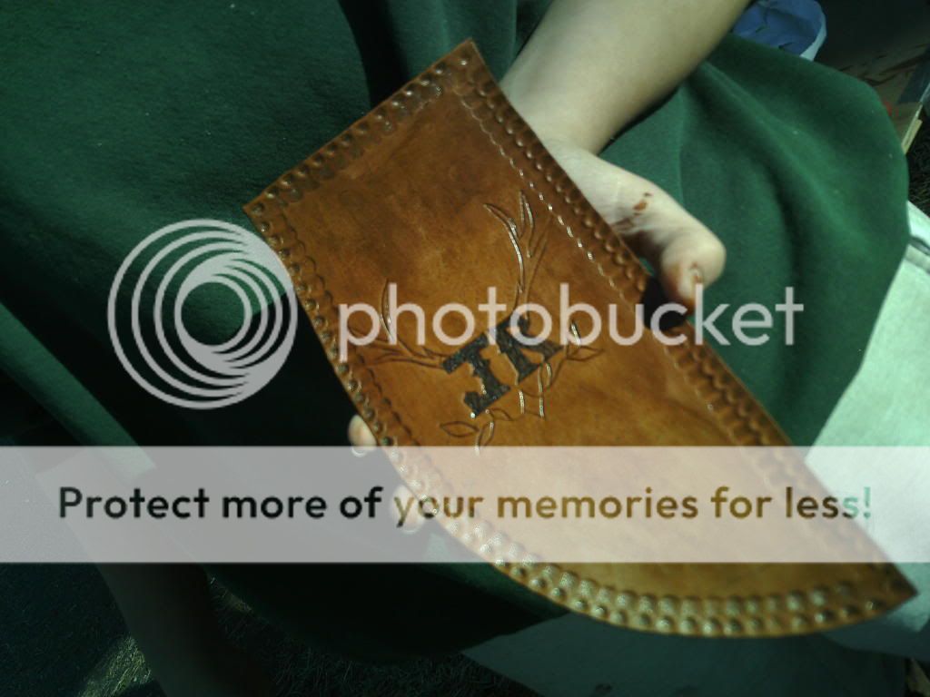

Leather kit we bought at Tandy Leather. This way my wife works the sheaths, and saves me a whole lot of time.
codyoebel
/LeatherKit.jpg[/url]
Here is my wife working on the sheath.
Here she has about finished the tooling. I drew the JR, and the antlers to give her something to tool it in. It came out nicer on the leather than I had penciled it in. The JR stands for my brother in law Jason Ridgeway, and the antlers for the hunting ranch he manages.
Here I am sawing the ingut to get enough room for filing it out.
Here I have put together the ingut, the guard, and the handle to get an Idea of how it's going to look.
Ok.. TOMORROW is the BIG DAY! Right now I have normalized the blade 3 times to magnetic north, got it up to non-magnetic for a 4th time, and it's sitting outside under coals which I have been feeding for the past few hours and will throw some on top before hitting the sack tonight. Im anxious because I have screwed up and burned blades.. but tomorrow I am going to focus.. using that magnet I am going to ensure each time that I'm at the right temperature.. just a little over non-magnetic, and will dip it into transmission fluid.
For those of you who might have been looking for a container deep enough to quench even a 18" long bowie I found the solution. At walmart in the kitchen area there is stainless steel pots and so forth I found a stainless steel cylindrical cookie jar looking container for 8$. PERFECT for a deep big blade quench! I will have pics or video's of it tomorrow from the hardening process!

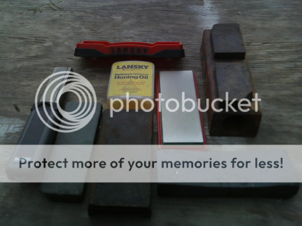

I'm knife sharpening hone collector crazy
WOOOOOOOOOOOO HOOOOOOOOOOOO 30 minutes of
sharpening, and it cut me twice. So I went to test the edge
on paper and VOILA BABY SHE's RAZOR SHARP. I took a
video I was going to shave the back of my head, but after
cutting myself so easily twice and feeling that edge and heavy
weighted blade on the back of my neck I stopped feeling
uncomfortable LOL.
