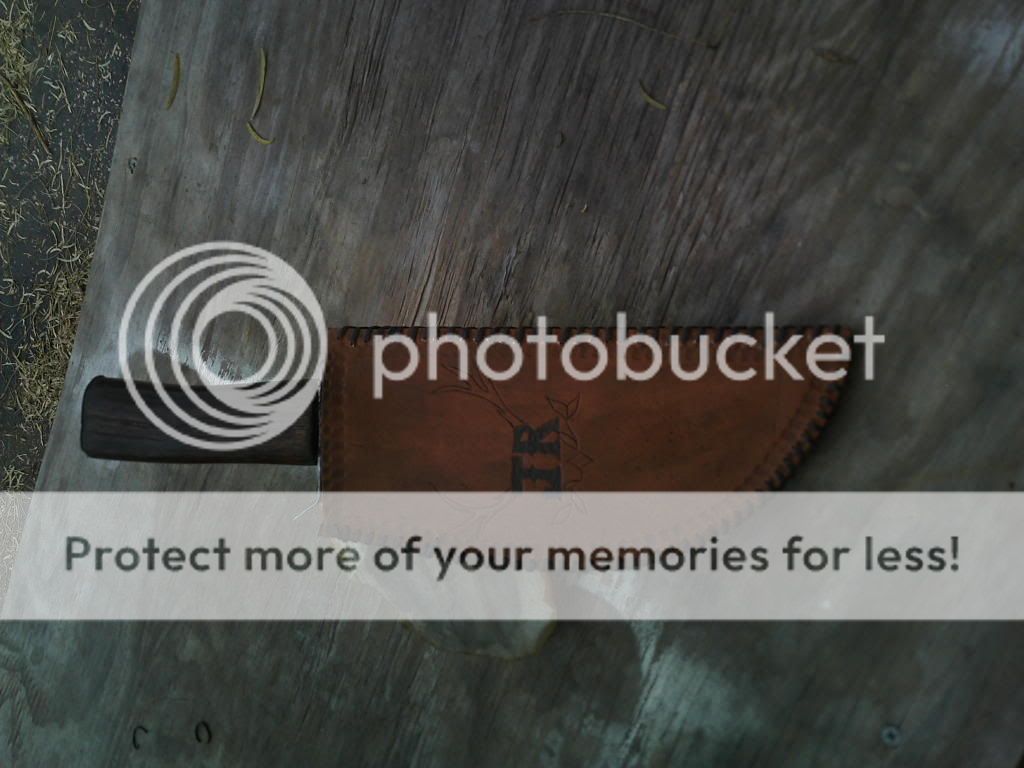

---FINISHED UP THE BOWIE HERE IT IS FINALLY COMPLETED---

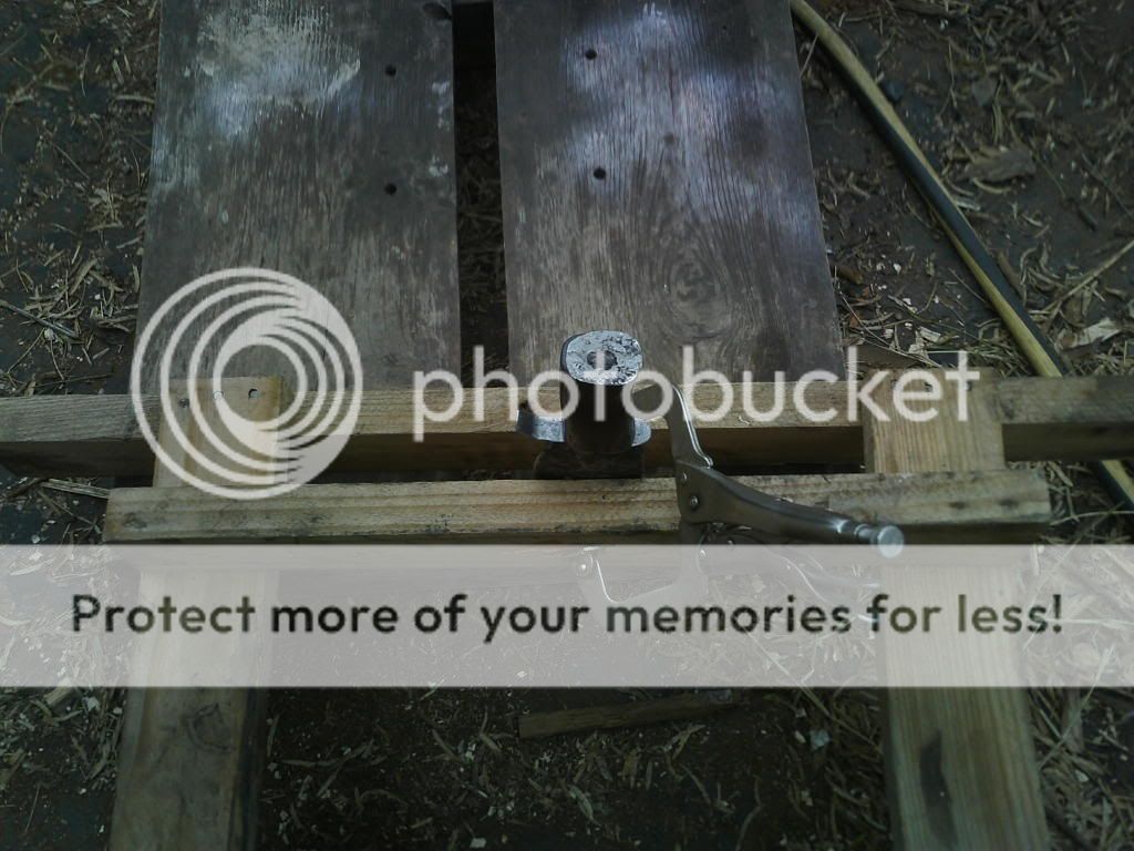

(Im buying a vice today - searching craigslist, because I'm not pinging
another knife over using vice grips unless absolutely necessary as with this project)
Wifes the one who made the sheath :). "keep your eyes on the sheath LOL".
YouTube - SheathOnWifesHip.avi
YouTube - SheathComingOffHip.avi

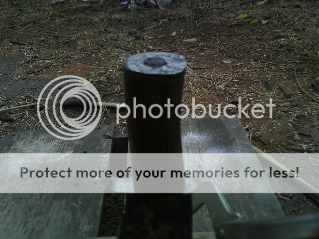

Note: I used MidWest snips to cut the thickest stainless steel spoon I could find to shape.
Then hammered out the center, and used small files for precision.
YouTube - ButtCapVid.avi

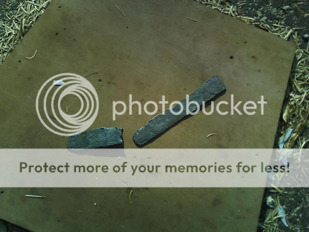

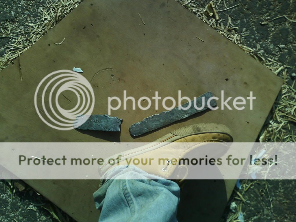

After looking around for a file my little boy snatched up I found this peice of 5160 bar that I had melted in half because I didnt watch it enough, and had got side tracked from my kids. The longer of the two peices is a good 8", and so if I can get this bowie mostly done by the end of this weekend. It gives me a week to possibly forge another knife. However.. I may not have time to make a hollow wood handle like the previous one, and might just do a hickory split handle, screw holes through the handle. Take some 16 penny nails in an annealed state. Cut them to length put them through the drill holes, and ping them down as well as 3ton glue the handle.
We will see if I get to this point during this week as I also have limited coal.
