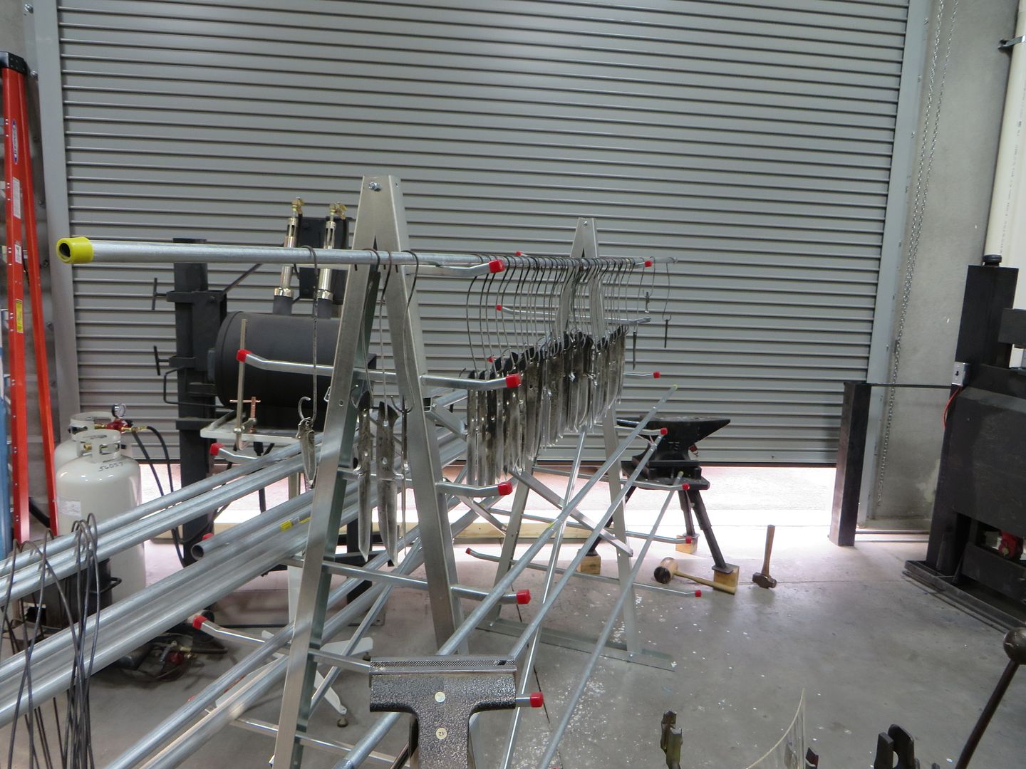

I heat treated a large batch of 50 knives in my salt pots using Aldo's 52100. I did all the thermal cycles mentioned above 1650, 1550, 1400, stress relieve, 1550 and mar quenched in low temp salts at 400. They all had a Rc of about 64. I tried it at first at 1475 with some test pieces and didn't even register 20 on my hardness tester. I had to take it up all the way to 1550 before I got decent hardness. I ran close to 15 test coupons before I had it dialed in.
Just because a temperature works well for someone else doesn't mean it will for you and the only way to be sure is to test a bunch of pieces and test them. Every thermocouple reads a different temperature than another. Usually not by much but the do. Also if someone has cut and stripped the wires on the thermocouple by as little as an 1/8" it can throw the temperature read by a 100 degrees. Every connection all the way if not tight will throw your readings off a little. Every kiln, forge, salt pot, etc will be a little different in temp even if they are all reading 1500. Depending on how old, connections, maintenance will determine how different they are. So when someone tells you to take it to say 1500 that is 1500 on their equipment not yours. You just have to keep testing till you get the results you want then stick with that until you change something, then start over.

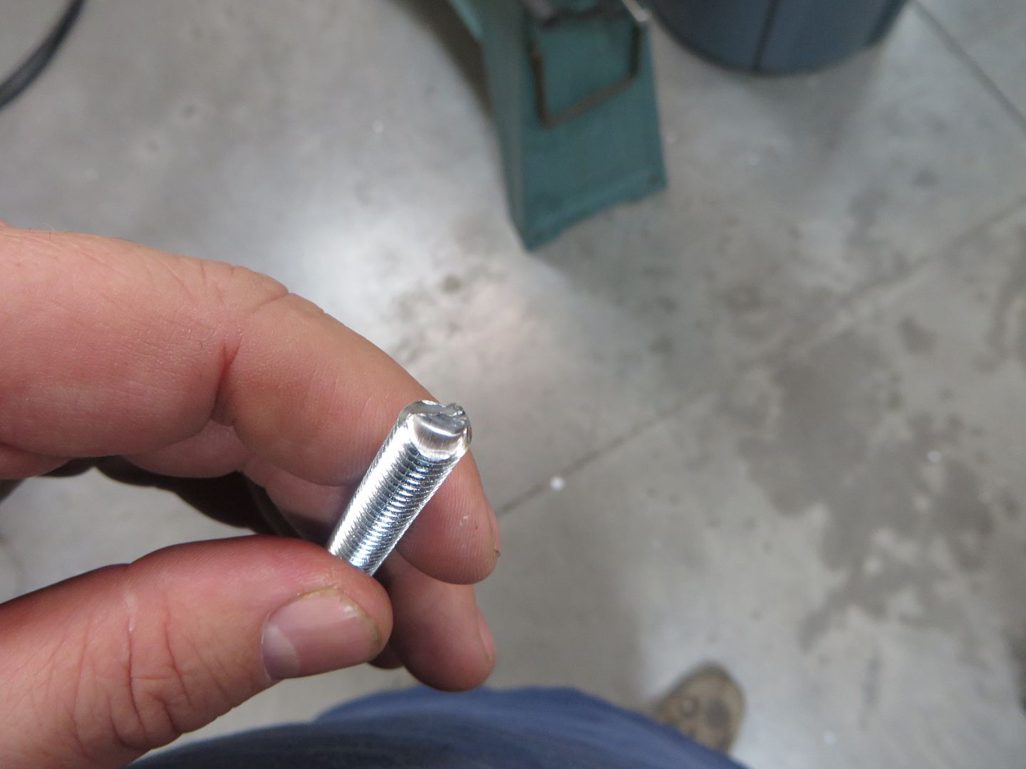

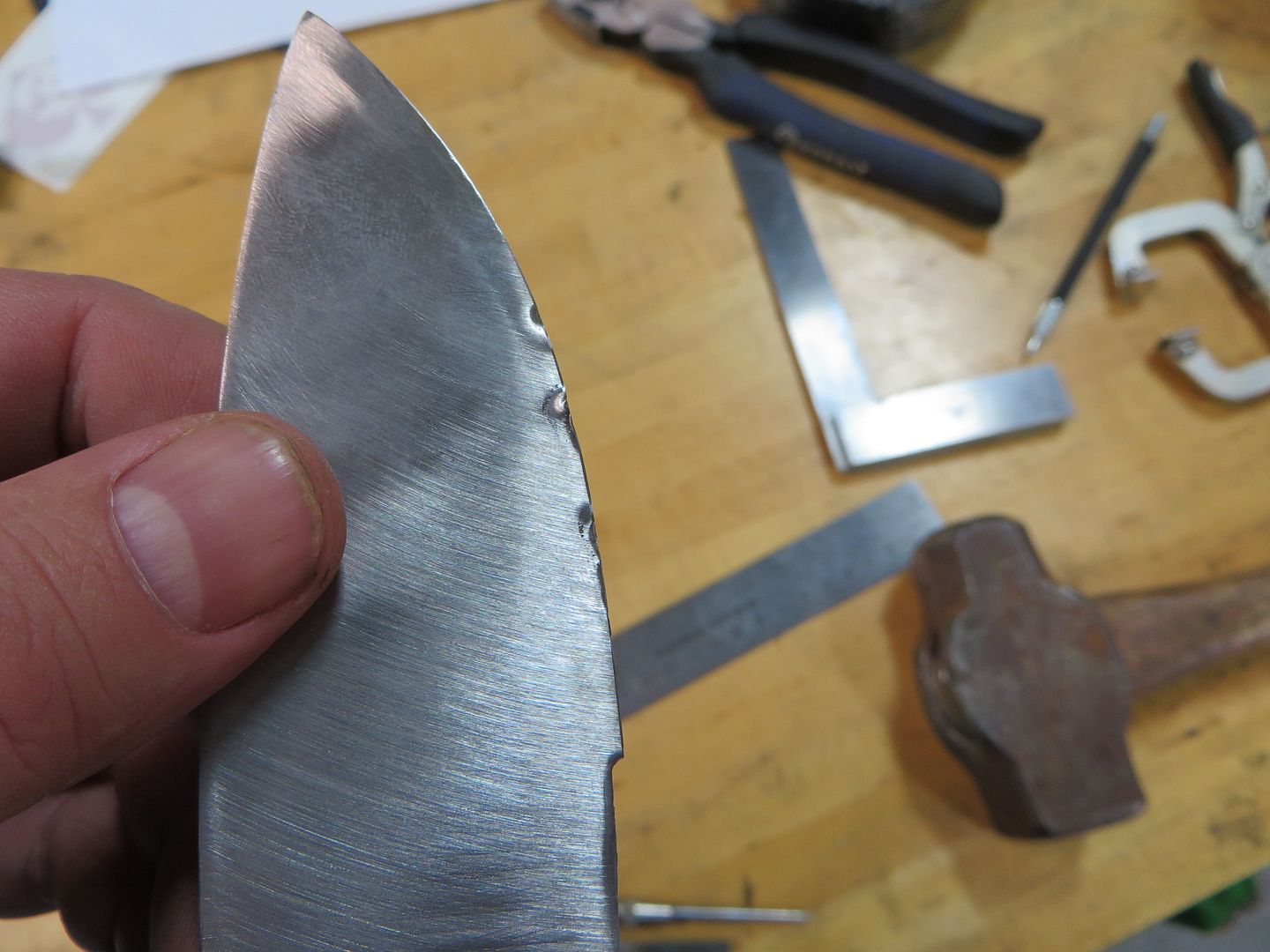

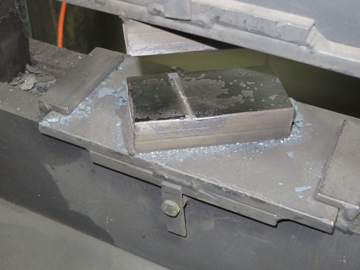

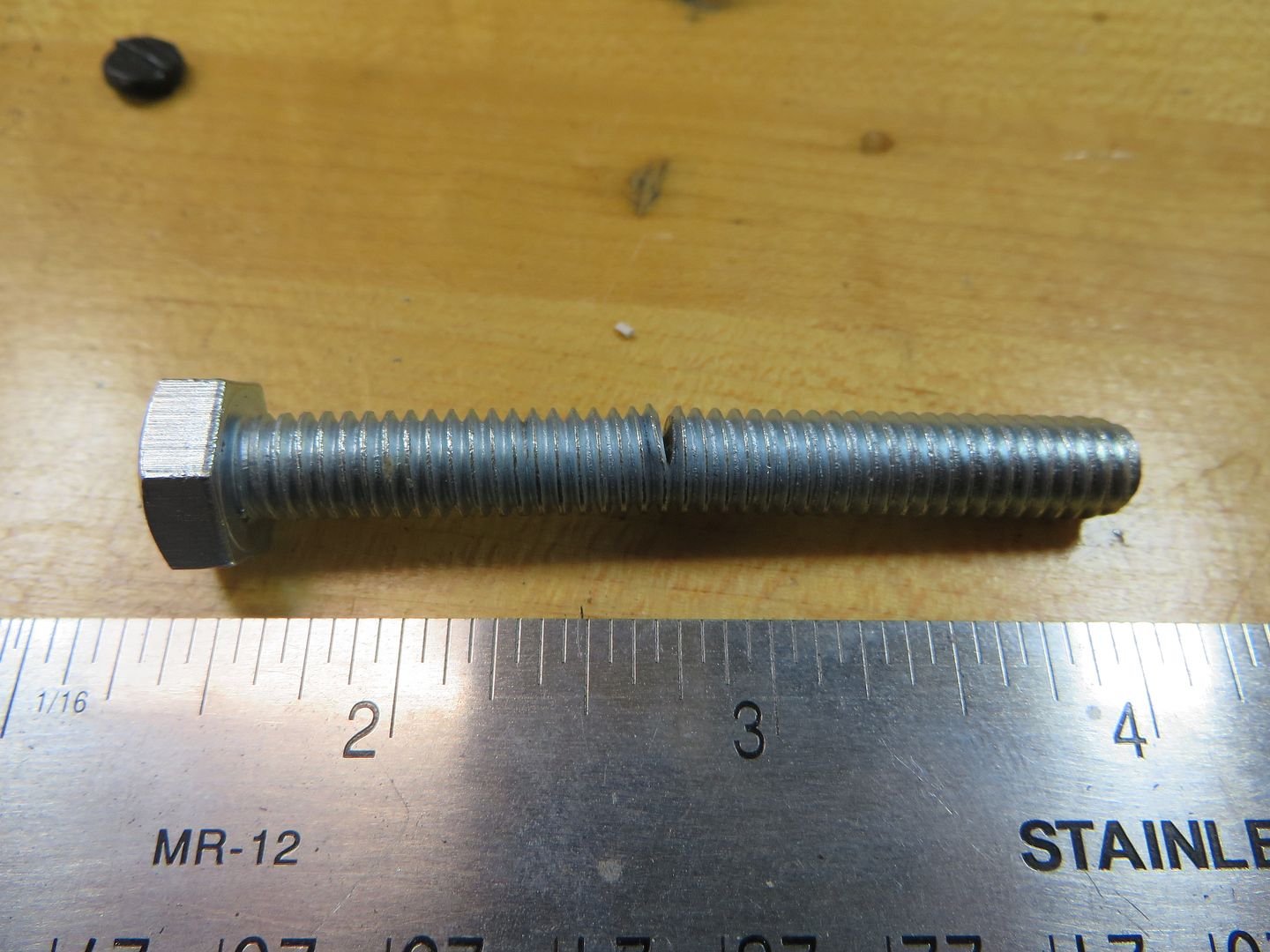

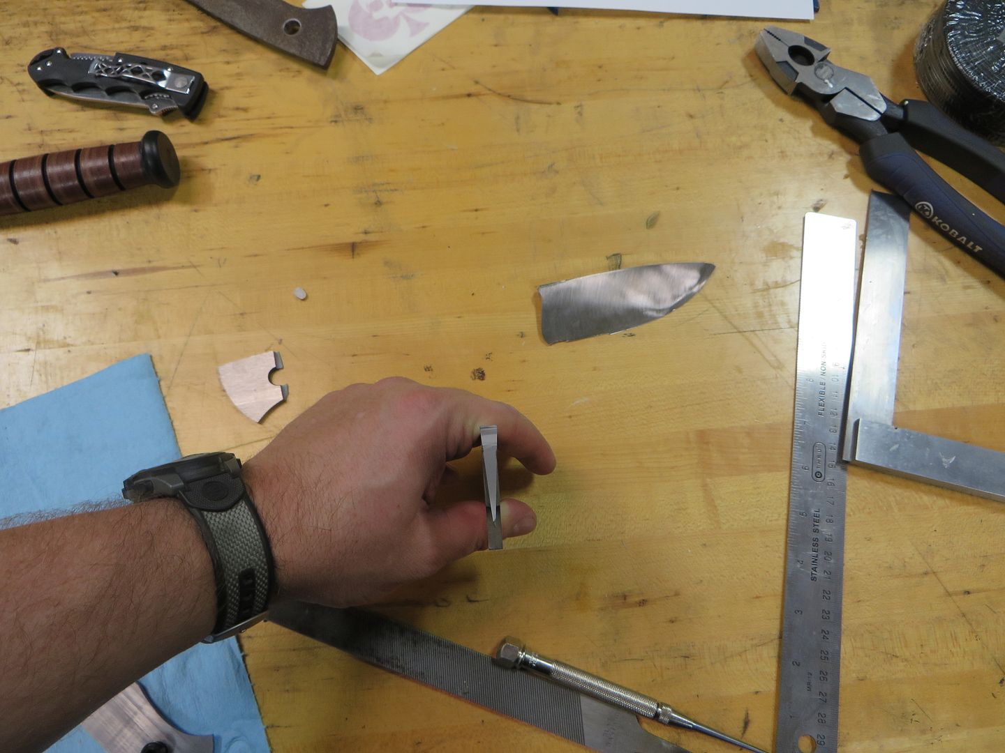

Here were the knives I heat treated.
The bit into bolts and cut them quite well.
I learned not to do this in my hydraulic press as the knife edge was so thick that it would shear the bolt about half way through and bit deeply into my bottom die causing me to replace it.
Still very fine grained.
edge rolled but did not chip at a Rc of 62 even though I lowered the Rc to about 59.
I'm not going to claim to anyone that 1550 is the magic number it's just what I settled on with my setup. I'm going to do another large batch soon and am using the same steel and will do more experiments and will not decide on based on a number but by results. And unless you have the exact same setup with the exact same thermocouple, in the exact same state of decay then you will have a different temp reading than me when you do yours. You can only tell if it was good enough by testing your blades and adjusting accordingly.
