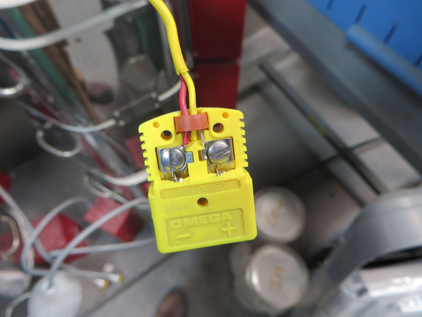

Jimmy- one question though: what did you mean about stripping the wires on a thermocouple? My thermocouples have a quick-disconnect, so I think that's probably why I'm not visualizing that.

On the side that does not disconnect and goes straight to the controller. Those wires are supposed to be calibrated by the manufacture to give a certain reading based on the resistance. They usually only have a little bit of wire showing so sometimes to get a good connection you have to strip the wire a little. If you cut the wire you have changed the resistance, and thus your readings. I screwed up the first time I was changing thermocouples in a GE frame 7FB gas turbine and stripped and cut what I thought was just a little amount of wire and put in the new thermocouple. Later we could not bring the unit online as the temperature differential between that one can and a few others was to much and it's automatic trips and safeties prevented it from coming on line. They finally called out a real electrician and I showed him what I had done. As soon as I told him I cut the wires he told me to stop that we had just screwed up big time. So he had to go to the controller and recalculate all the readings to reflect the new resistance of the wires. A few hours later we were online. The next outage we changed out all the wiring and went with thermocouples that were quick disconnect so no one else would make the same mistake.
You cant cut any wire at all on this side without it affecting your reading. Now if you have a controller you can communicate with you can re-zero it at the new resistance like we did.

Here's a better picture. My units only came with the bare wire and no thermocouples. Since they seem to run like a champ I can only hope that they programmed the controller with the proper resistance for the wires and didn't just cut some wire and screw one side in and say that's good enough. On some wires when you are trying to get them through the plastic and very small holes you sometimes mangle the ends and people just cut and strip a little more wire so they can get a good connection. Since their quick disconnect I only have to do this once. The old style you would have to do this over again every time you changed your thermocouple.
