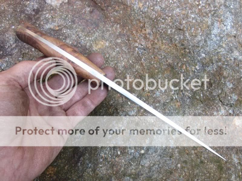

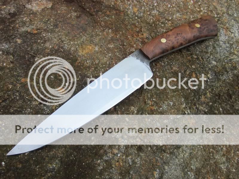

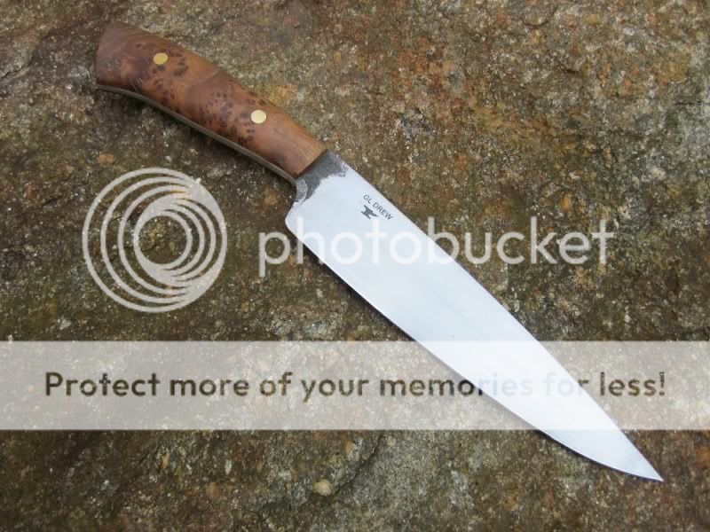

I have resisted using 52100 because of the extra time needed to heat treat using Ed Fowler's method. Three quenches with 24 hours between, a soak in the freezer for 8-10 hours and three tempering cycles is tough on someone like me who wants immediate results. However, I have heard so much good about the steel I had to give it a try. This is my second 52100 knife.
Forged from 1 inch 52100 round stock
Flat grind
Hand sanded to 600 grit on the grind with some hammer marks on the flats
Distal tapered blade and tang
Professionally stabilized (WSSI) ash burl handle
Overall length: 11 1/2 inches
Blade: 7 inches

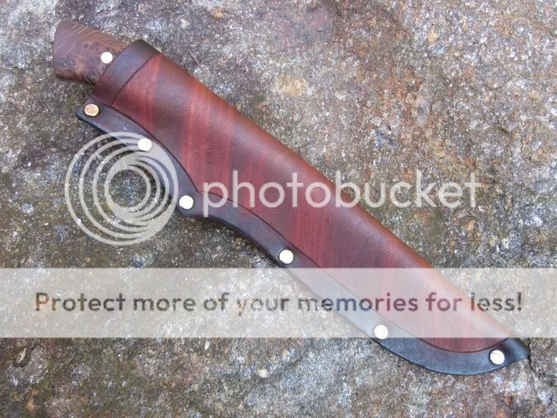

Riveted leather scabbard
$220 ----SOLD---- delivered to the US or Canada. (sorry for the high price but it just takes a lot of time to pound out and heat treat) My PayPal account is gldrewknives@yahoo.com I will also take USPS money orders or checks with time to clear.
