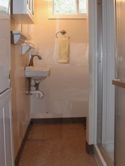

Here's a shot from the realtor website for the house sale, of the bathroom as it was
Notice the large faucet and how the sink is at an angle, it literally was just hanging from a metal bracket on the wall.

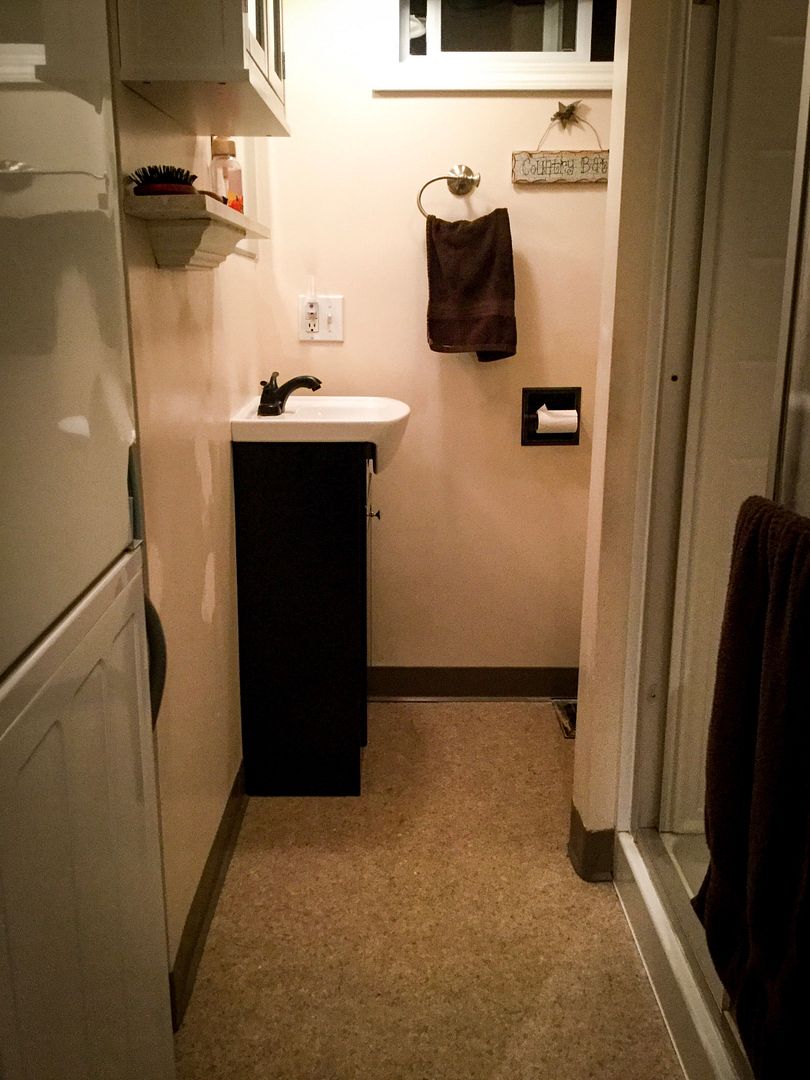

And today I put this one in along with a matching toilet paper holder
IMG_0158.jpg~original
Still pretty small but better than the one that was hanging on the wall
Also a new smaller faucet too

Nice! looks like a LOT of work had to be done to support the new stuff, but necessary too !
And the cabinet/sink we got from Valu picked it up there, brought it home, opened the box, the sink was stuck inside the cabinet and on it's trip from the orient, it proceeded to bust up the bottom of the cabinet !!! drove back and had them open the other two boxes, they were in WORSE shape ! so they said we could take their floor model if we want, it was a little dirty but not overly so and we were stuck so yeah, we took it, should have asked right then for a discount but you know how that goes. They had a white one they were going to open up to see if that was damaged too and send all of them back to the distributor, looks like they packed them upside down so that heavy ceramic sink was just banging away a the bottom plate as well as the sides of the cabinet, ugh.
Then, with the piping being different than the hanging one, I had to trim the drain pipes to fit, ended up with a leak at the bottom of the sink but got that handled now, removed the door so as to have full open access was key, remove the screws from the door itself and leave the hinges in the cabinet.
Also I knew there was some solid wall where the old sink was hanging from, so I took a lag bolt and a piece of metal to clamp the back of the ceramic sink to the wall, "GENTLY" so as not to fracture the ceramic but to make it so it would not want to pull forward if someone banged into it.
also ran some silicone along the top edges of the vanity and along the back of the sink as well so it would be more fixed to the vanity.
And the vanity cabinet came with two screws and plastic anchors to fasten it to the wall, but there is a gap between the wall and that strip of wood so I got some wedges from Home Depot to slide in and then when I screwed the cabinet to the wall it would not be putting untoward pressure to the sides of the cabinet where that wood is fastened. After seeing the damaged ones, I didn't want to risk tightening down and pulling or breaking that bit of wood, the wedges worked great and made a solid feel to how the cabinet was anchored to the wall.
All in all a very handy little sink vanity, not the most expensive but for our needs, " It will Wash " said in my best "Forged in Fire" voice :)
