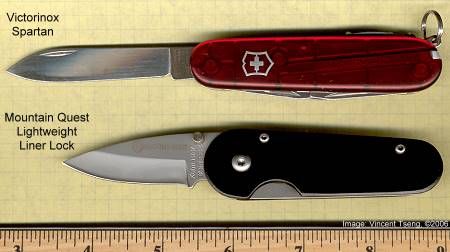

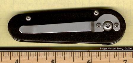

It's real neat -

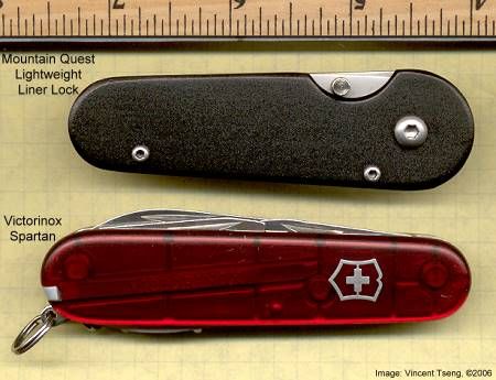

Size comparison with a regular 91mm Victorinox SAK -

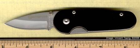

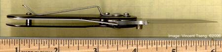

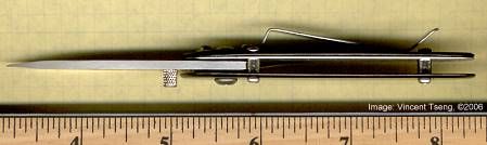

It has very slim/thin scales and the lockup was real positive -
The blade stock looks just under 1/8" which is pretty thick for such a small bladed knife.
Even though the anodized aluminum scales are slim/thin - they are rigid and there is no flex.
There is only a liner on one side for the lock - looks thin but the lockup is positive albeit almost all the way across. The spring of the liner is strong so that when closed the ball-bearing detent is very positive and there is very little chance this knife will open accidentally - I really tried to shake/snap it out and could not do it at all.

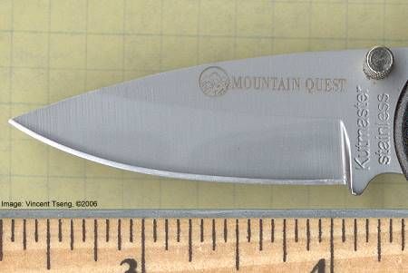

Sharp?
Well my first few cuts were when I got the knife and straight out of the packaging - hmmmm.... it's kind of sharp but not really that sharp, a bit disappointing after my thoughts about the hollow grind.
OK get home quick touch up on V-hone crock-sticks and strop on cardboard and test cut paper - it would cut, but not that well......
Hmmmm.... what's wrong - bad steel?
(er.... I was being facetious :p - even mild steel can be sharpened to slice paper)

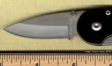

Examined the edge under a 30x illuminated microscope - and there it was - one of the edge bevel was too obtuse so that the V-hone crock-sticks were only honing the shoulder between the face and actual edge........ no wonder I thought I felt a mild burr on the edge after honing on the crock sticks - it was honing the actual cutting edge on one side only.
Blade - pre-sharpening - side with the obtuse bevel
This forced me to sharpen the knife - and since I was going to use my "stones" I might as well convex the edge - using fine grit diamond stone this took less than an hour to recut in a bevel and make it convex on one side and convex the other (already correct) bevel. Graduate to hard Arkansas (white) stone, and finish by stropping on cardboard -
Blade post-sharpening with semi-convexed edge -
and man does it now zip through paper - it will cut through cardboard on my ad-hoc test about as well as a regular Victorinox SAK (un-convexed) - considering the substantially thicker blade stock - this is actually a good performance - the convexing was easier because the hollow grind did not thicken too much toward the edge.
That's gonna turn out to be a real problem some day. Soft blade, (probably) soft liner... and it looks like just a little more wear and the liner will jump the blade tang.
At best, that means it'll jam and be difficult to unlock, and probably develop major blade play; at worst, the liner will slip between the blade tang and far-side liner, and allow the blade to close. :eek:
Thanks for the warning -
I will keep an eye on that -
That liner is probably about 7/8 across the tang - looking at it more carefully - it would seem that the very prominent ball-bearing detent may actually prevent the liner from going too far and between the tang and far side scale.

No side-to-side play, nor any vertical play - the lock-up is solid - albeit a bit more across the tang than I'd like - as pointed out above.
The knife is indeed made in China.
The negatives so far are - most probably soft steel - probably 420J2 - but it does sharpen up well - survives ad-hoc cutting of cardboard without showing flats.
The liner lock goes too far over which may cause problems when the knife wears - however I think there's very little danger of the liner slipping between the blade tang and the opposite scale, as the ball-bearing detent (very prominent) would prevent it.
I'm sure the thin'ish liner would fail if really stessed - but I only bought this for a light duty knife - and will very much bear in mind its limitations when using it.

Not quite 2 weeks and this might be a case of "I told you so" -
and I may have to eat crow.......:o

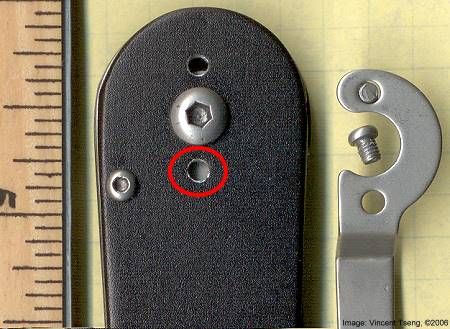

I noticed the pocket clip on the knife seemed a bit less springy - and wondered if the clip had lost some of its spring - but a bit more examination revealed that the lower retaining screw seemed to be loose.
Got out the torx driver and T-6 fitted - but the screw did not seem to want to tighten.......
Basically came down to the threaded hole in the aluminum had stripped -
I'm pretty sure the knife did not come with a loose clip - otherwise I would have noticed - and this has happened just from the "rigors" of carrying the knife clipped to my back pocket.
So it could be the aluminum scales are too thin for enough thread; alumimum is too soft for retaining threads; or the threads were crossed when the screw was installed - which resulted in the stripping.
I am obviously disappointed - this is not where I would have expected the knife to fail.
I am probably going to exchange for another sample ......
and have to go through reprofiling and sharpening the blade again :(, and see if the replacement unit lasts any better.
As I've said I like the handy design, size etc. -
but if the quality is an issue then even at less than $7 it's not worth it......
I'll report back if I managed to exchange for another.

On lower end items QC is often a concern, it could be simply when it was set initially the threads were forced.
-Cliff
I might be tempted to just disassemble the knife, and rivet the clip in place. Heck, you could probably even just use the origional screw as a rivet and whack it a few times with a hammer.
