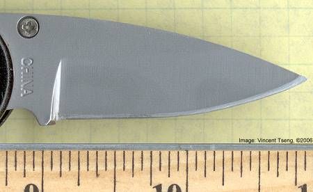

OK, bearing in mind knife knut economics - I only returned the knife at Dick's Sporting Goods when I was going to pass by anyway - so that's zero $ for gas ... ;) :p
This was one of the most fuss free exchanges I've ever had the pleasure of encountering -
I went and got another knife from the peg - the clam packs are not sealed, so I was able to examine and take my pick of the two there.
Took the new one along with my faulty knife to the counter with my receipt - explained about the stripped thread on the clip - and said I wanted an even exchange - they just took the faulty one and that was it.....
The replacement one seems a bit better in terms of the lock -
the liner goes about 3/4 way across -
The action is a bit tighter but still smooth I can loosen the adjusting screw to lighten it - but that leaves the screw a bit looser than I want it.
Like the previous one the hollow ground profile again did not thicken toward the edge (a good thing).
But the blade like the previous one had too obtuse an edge angle - and would only just barely slice paper.
This time it took me less than 1/2 hour to reprofile the blade since I've done it before so knew what to look for, and do - despite being half the time - I thought I did a better job on getting a semi-convexed edge -
The blade is now VERY sharp - not only for slicing free hanging paper - but for cutting through things because of the good profile - convexed edge with a hollow grind that does not thicken toward the edge....
So I'm remain pleased with the design and handy size -
again only time and use will tell if the knife holds up -
I'll keep an eye on the clip in case it fails again.
But I do know that the store has a no fuss return -
and the company has a limited lifetime warrenty -
not too shabby for a $7 knife......
Vincent

This cheapo $7 knife is holding up quite well - I've cut through several normal types of things that an EDC gets used for including a few blister clam packs. I always learn patience and only cut these while calmly sitting back in my car - with the knife point away from my fingers and body. Edge shows no signs of wear or damage - but I wouldn't expect it even for soft'ish steel - as my cutting duties would be considered "lite".
The action is still very good.
However, while testing for any play - there was none, side-to-side or vertical - I noticed the pivot screw was loose - so I was surprised there was no side-to-side play - I think this may be due to the screws holding the scales being tight. Anyway I tightened the pivot screw to finger tight - probably just a shade tighter than I did initially - and will see if it loosens in time - if it does I'll have to use some LocTite.
Just as a side note of interest - I was in Dick's Sporting Goods the other day - and noticed that they hung the knife I returned back on the peg - I know for certain because the package has the security warning label missing - removed by me - the knife was closed in the package and looking at the back and the clip - the lower screw for the clip was missing (the threads for the hole in the scale was stripped)....... hmmmmmm...:eek:

It's now one month since I got the current exchanged $7 EDC.....
and all is well.
I took the advice of Pocketknife and used blue LocTite on the threads of the lower pocket clip screw (the one that had stripped the threads in the scales previously) - the clip is also fine - shows no signs of distress or budging.
I have obviously fiddled more with the blade - basically trying to improve on my initial job of convexing the edge - all this is obviously diminishing returns - but the knife really cuts like a motherf* - obvious EDC type duties - paper, cardboard, packaging - dreaded blisterpacks - again shows no flats or signs of dulling - from all the use - I have not had to retouch/sharpen after the fiddling.
Being pointier than my EDC SAK - this $7 EDC makes the first "puncture" cut on the edge of blister packs much more easily. I have always been cautious with these nasty packaging - waiting until I'm back in my car calmly sitting down - and I've always aimed my knife point and edge away from my fingers, thigh etc. before cutting......
Anyway for $7 - after the initial hiccup - this cheapy seems to be holding up well - with not much to complain about and a lot to actually like - well I'm obviously biassed - otherwise I wouldn't have bought it in the first place.......
