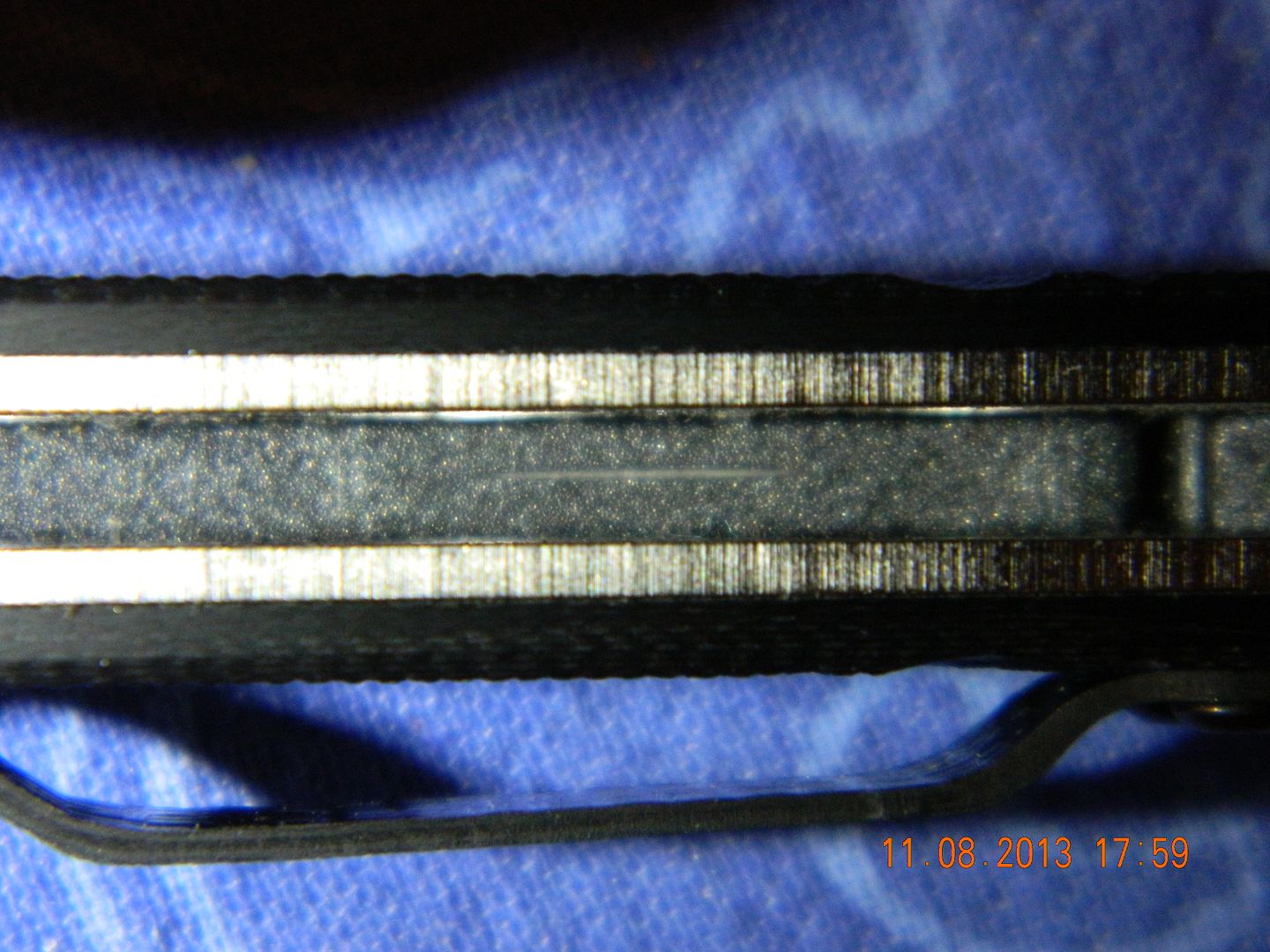

I just came upon this thread because I just got my first (brand new) 710 and I look at the spacer and it has that line.
So I will send it in to BM.

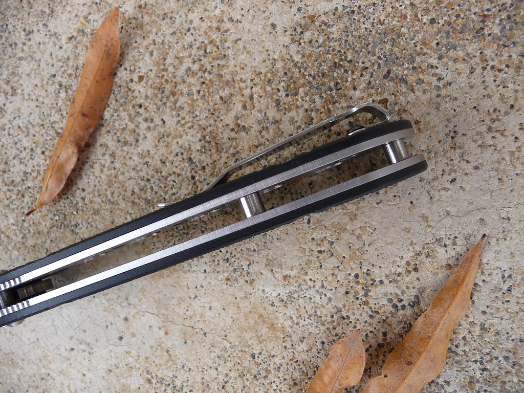

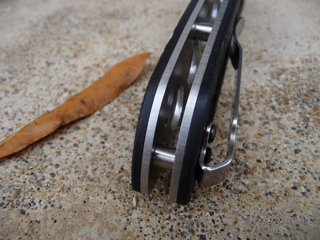

The standoffs are just plain jane ss barrels.
BM710D2 by jeronsewell, on Flickr

I just sent mineoff today...turns out it had an uneven dge grind on it and the lock was crooked as well...
guess I got a lemon.:(
Here's that same 710 that was pictured above.
The blades not hitting anything now that it has standoffs....
What a sexy knife, those backspacers do a lot to add to the overall presentation of the knife.
Are those the same barrel spacers that BM puts on the knives now? Or are those after market?
Also if the kni fe is hitting the backspacer does that mean installing your won standoffs will prevent the balde from hitting them? Of is that an adjustment BM need to make?
No, those are not BM's standoffs.
So, far every BM I get that's hitting the back spacer.
Doesn't hit anything after I'm done with my MOD's.
