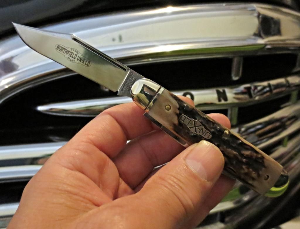

The 78 has definitely become my favorite GEC pattern. It's like a grown up boys knife with an even better clip blade, especially on the Northfields with that long pull. The pull can be pretty stout on some, but I've found it easy enough to lighten.
Below is my small collection of an ebony, 2 blackwoods, and my new stag. The ebony has had the pull lightened to about a 7 and the blackwood on the left to about a 6. The other blackwood and stag are unchanged and come in about 8 and 7.5 respectively. I think if these came with a little lighter pull standard they'd be much more popular, but 5 minutes with a little wedge between the tang and back spring and you can pretty easily tune these to you preference.
