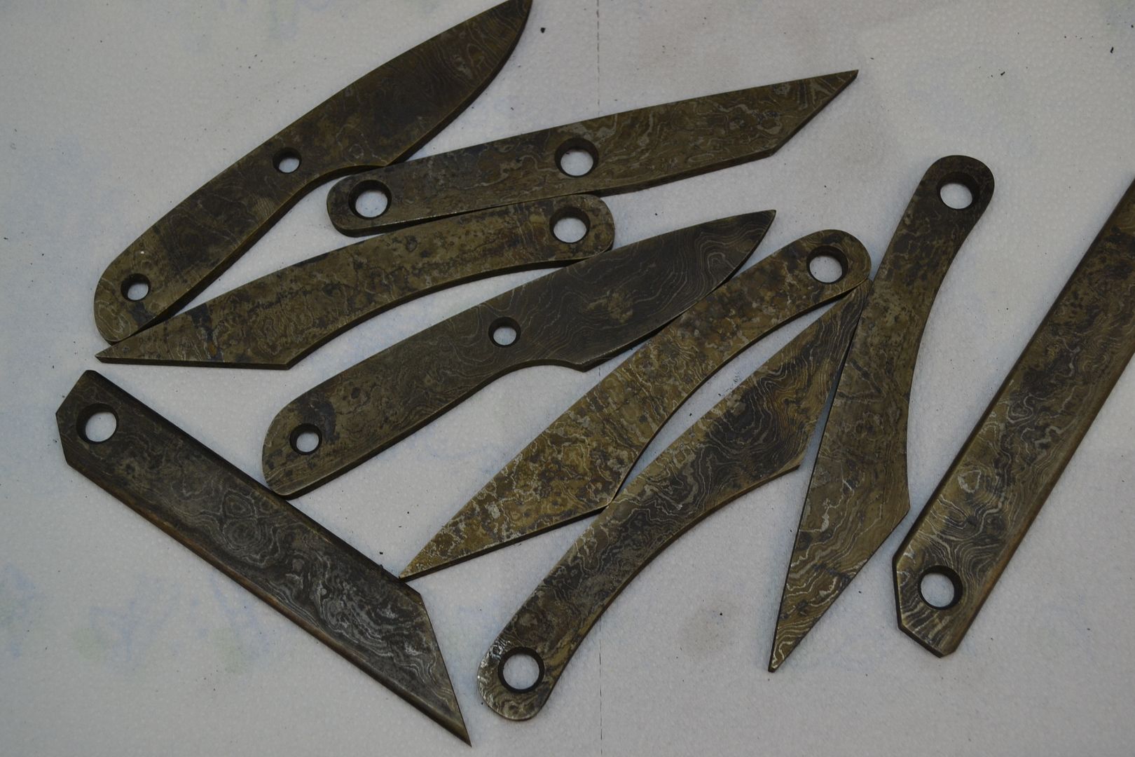

Here's what I started with this morning, 9 knives in Damascus,

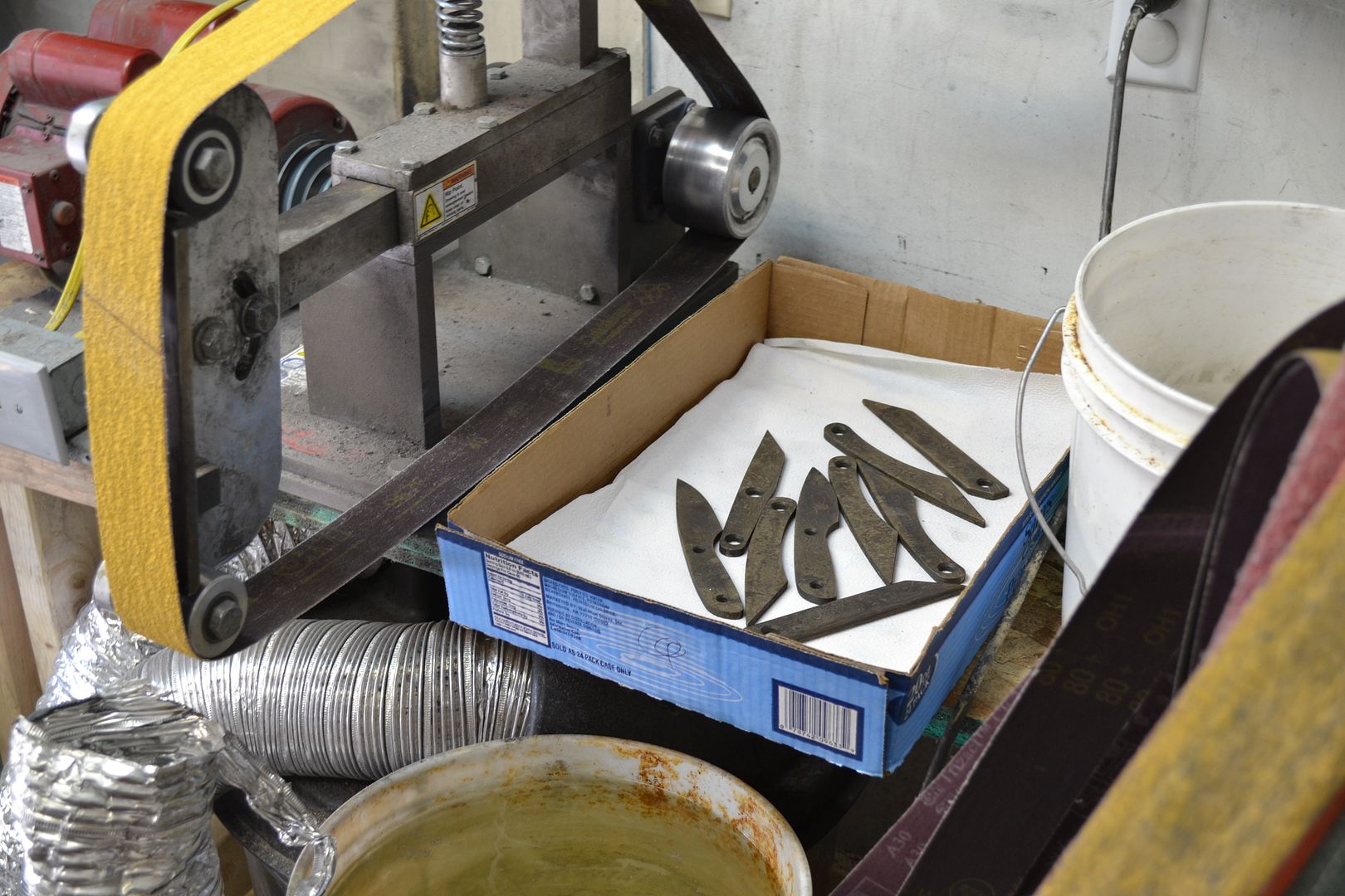

This is my grinding area, where most of the work is done.
KMG Grinder, Dust Collector Hose, Belts being used within reach, Dip buckets, random gear, under the table is a metal trash can with a vortex lid for most opf the crud that runs through the dust collector, it is a pre-filter. I use beer flats to keep my batches sorted and have about six going right now with different projects.

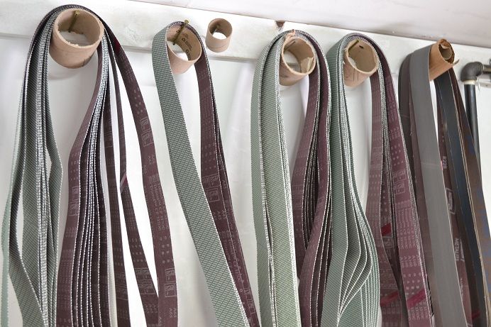

Belts...

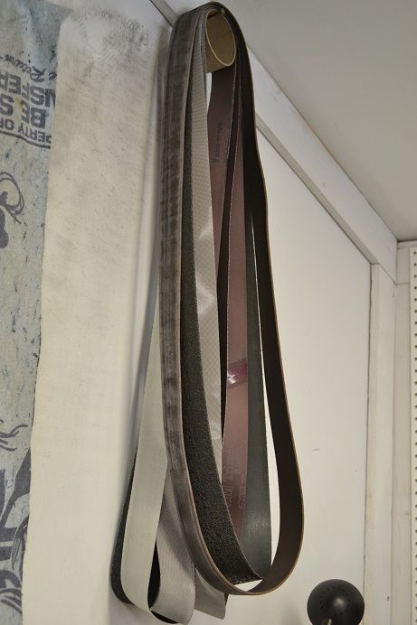

2000 grit, one belt that is so high of a grit it has no name, cork belts and a leather belt - these are for finishing and stored in my "clean room"

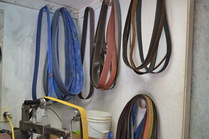

Finishing Belts - these are for rougher to near or final finishing. I use 120-600 grit
Rough Ceramic Belts - I use these to profile the knives and grind the bevels, I have 40, 80 and 120.
Random belts and the lower ones are mixed up... I keep the current belts I am using there. The blue belts are Zirconia, I use them for sheaths and handles. I have a stack of scotchbrite belts in every grit too, they are nice for random tasks, satin finishes and deburring.

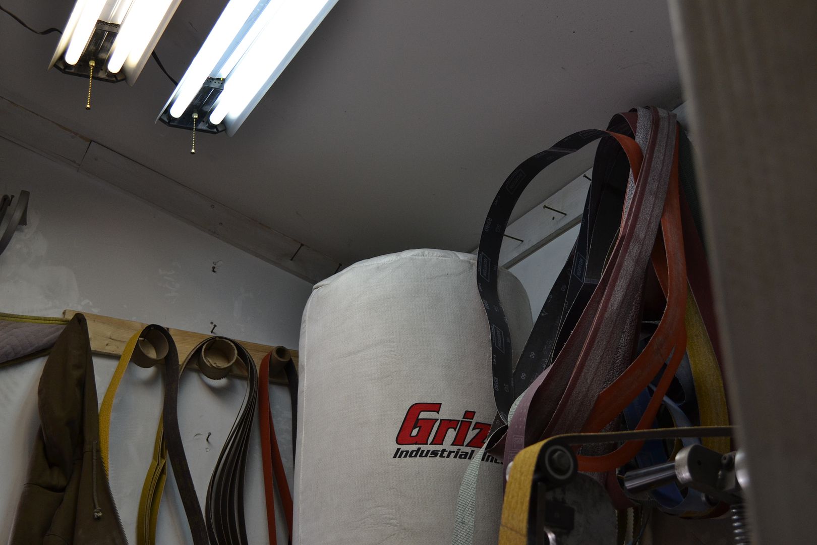

Lots of lighting... different spectrums too.

Slightly off-topic but I'm curious, what is the gold belt you have on there?
967 Cubitron - they rock, here is the best place for belts and a link to them http://popsupply.bizhosting.com/3m_2x72_ceramic_967_cubitron.html
I get an equal amount of these and the cubitron 2's for rough grinding. I am still not sure what I like the best. I lean to the yellow ones for 40 grit rough grinding and the II's for 80 grit.
I used to like Blaze belts but with the new backing they glaze my platen.... these 3m belts are so much better.

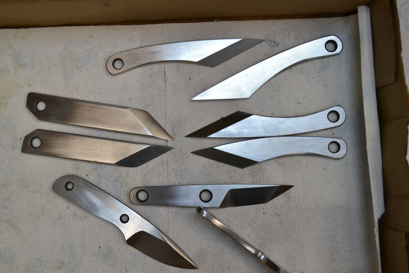

Not all, I think 3-4 are up for grabs! I'll have a couple of kiridashis and maybe a legal edc... maybe the Tanto too

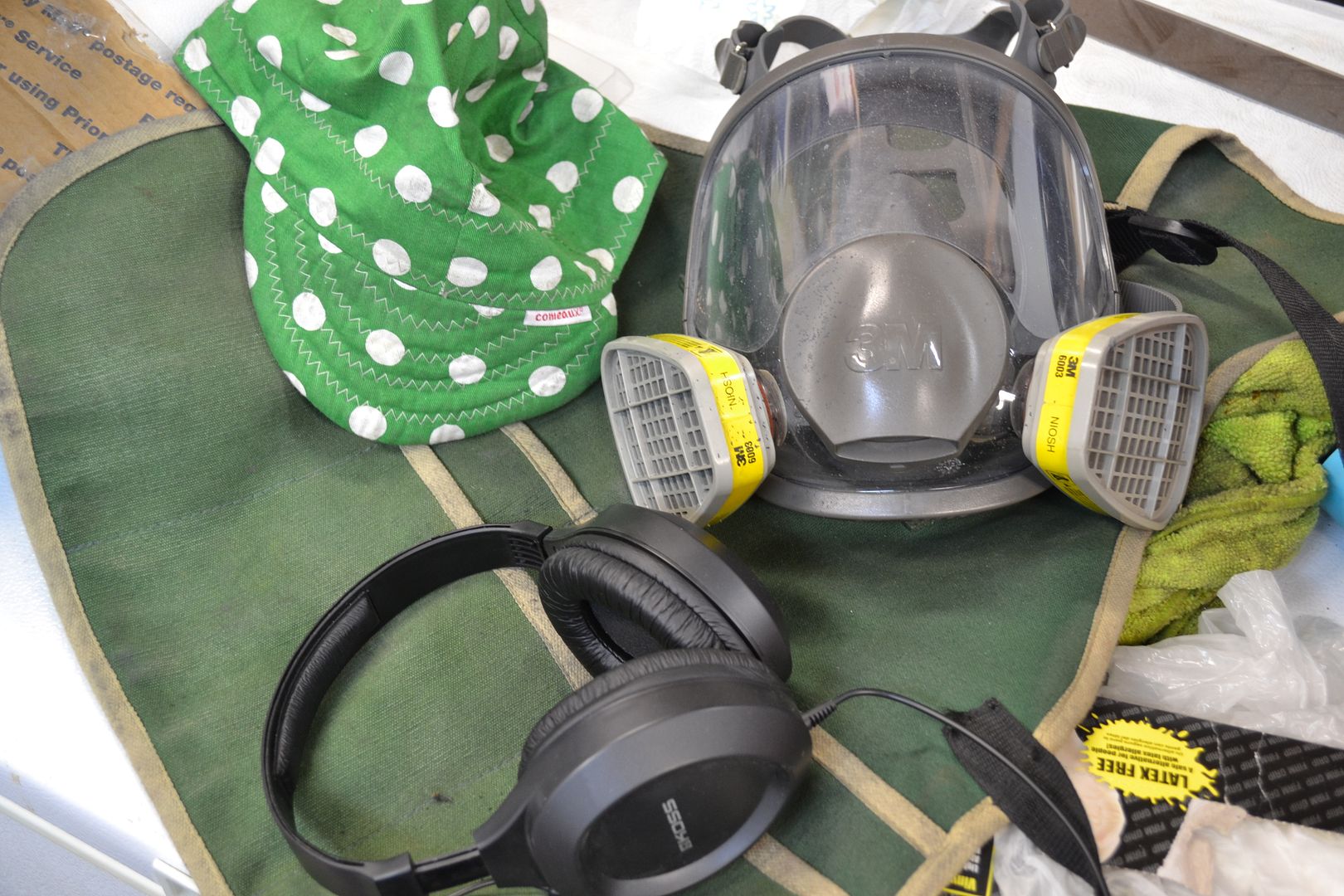

Tool of the trade... by the way I need some pre-filters on that mask! 3M full face respirator, ear protection/entertainment, apron (sometimes I just let my shirts set on fire or get that cool infused metal thing going) Gloves - I usually just wear them when working with the mill as it is oily, Green rag for keeping the knives dry after dipping in the cooling bucket. Welding hat, that is my tribute to the man, Bob Loveless. :D
