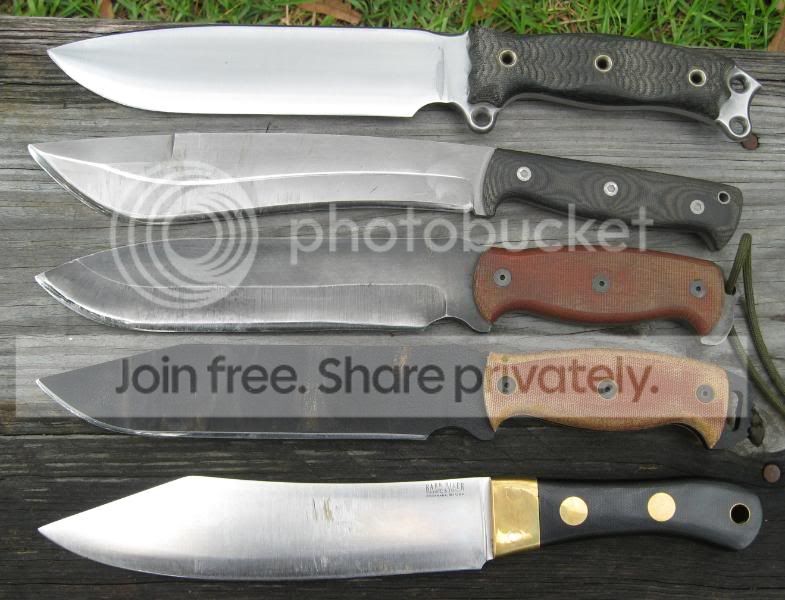

It had been bothering me for a while. I have this thing for big old camp knives. I have done 7" chop offs and 9" chop offs, but I have five 8" blade knives. I just wondered which one was the best at chopping. Here they are top to bottom:
Busse NMSFNO with a .25" thick blade of INFI steel and a full convex grind. Wt 20 oz
Entrek Destroyer with .25" thick blade of 440C. It has a saber grind on its recurve blade and a sharp convex edge. Wt is 16 oz.
Old school Ranger RD7 with a saber grind and convex edge. The .25" thick blade is 5160 steel. Wt is 17.5 oz.
Ranger RD7 with a full flat grind. Wt 16.5 oz.
Bark River Hudson Bay Camp Knife, full convex grind .215" thick A2 steel. Wt just under 17 oz.
All have micarta scales.

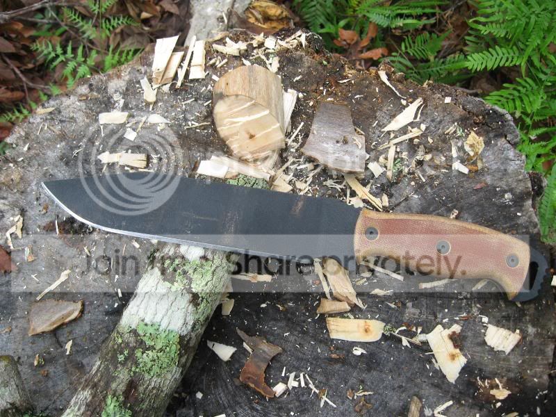

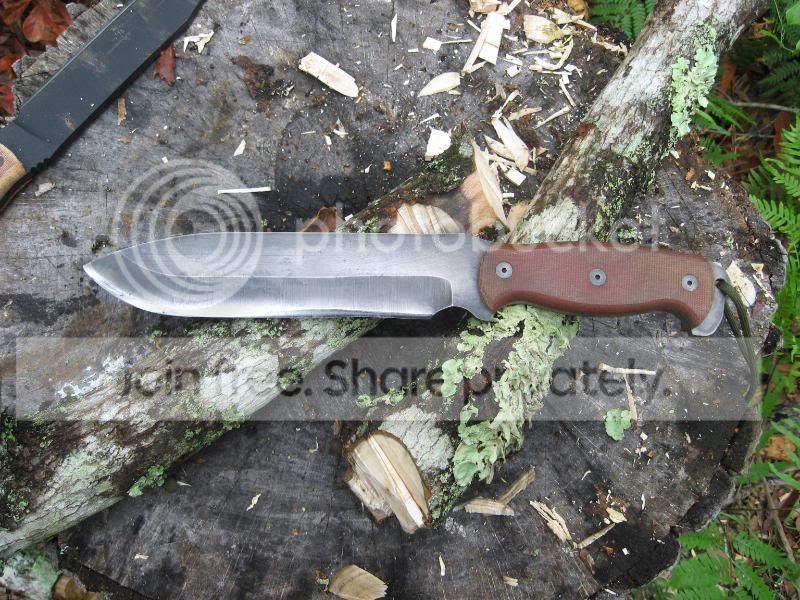

I selected a piece of Red Bay that was about the same thickness for all along its length for the test. The Old RD7 chopped through in 46 chops.
Yes, RD7s have 8" blades when measured from scales to tip.
The newer flat ground RD7 took 50 chops.

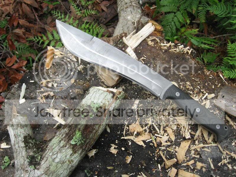

The Entrek was horrible. It hurt my hand to chop with that skinny handle, and the cool-looking recurve took 61 chops to get through.

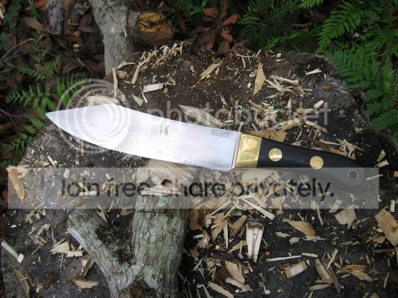

The much more comfortable Bark River bit deep and took 48 chops.
And the big 20 oz Busse was the easiest to chop with, taking only 43 chops to get through.
All were good choppers except the Entrek. Here's how they rated top to bottom in chopping:

Well they can all baton and smash cinder blocks, I'm sure. I was fresh out of cinder blocks. :D These are all rugged knives, but the Destroyer has to be the most uncomfortable and poorest chopping knife that I own in that size, and I have worked and worked on its edge. It has been a big disappointment. You would think that cool looking recurve bolo would kick some butt, but it doesn't.
I honestly thought that my old Ranger might win this. It gave the Busse a run for its money, but its handle is not as comfortable and it is 2.5 oz lighter. Still a great knife.

I have some 7" and 7.5" choppers that are very competitive with most of these 8" blades, like my SOD LE, Camp Tramp, Chopweiler, Ratweiler and Sarsquatch. But the NMSFNO already bested all of them in chopping. But a bigger chopper, like that behemoth NMFBM or even my FFBM would stomp the NMSFNO. All I measured today was which chopper in my hands did best. There is more to a good camp knife than just chopping. For all-around use, the Bark River Hudson Bay is hard to beat. You could skin with it, stick with it, slice with it. It's a superb camp knife. This little chop-off only tells me one thing: the Busse NMSFNO chops better than the others. It should. It's heavier. None of these knives has the factory edge, either. I put sharp convex edges on all of them, and even did a full convex grind on the Busse, so I am sure it chops better than a standard one. The Bark River came with a full convex edge. If you want the sharpest one out of the box, get the Barkie.

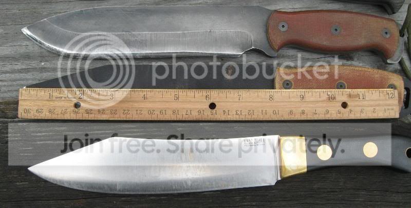

Then on to one of my usual subjects, so to speak, being the whole variable thickness thing on Busses. Horn Dog, you said your NMSFNO was 20 oz. How thick is yours? Mine are both .236", but some folks I hear have NMSFNOs much thicker than that, and such things will affect weight and may somewhat affect chopping performance, too. So it's interesting to know. :)
Excellent little chopping comparison, Horn Dog, and great pictures. :thumbup: The NMSFNO is my favourite Busse and one of my overall favourite knives, and for a 8" blade it is a chopping machine.
Well I did grind all the rough steel off mine. But at the tang it is just under .25" according to my daughter's high tech wooden school ruler. :D
Ah, those school rulers! :D By the way, a very nice job with stripping that NMSFNO and giving it a nice full convex / satin finish. It looks just as good as the LEs. :thumbup:
