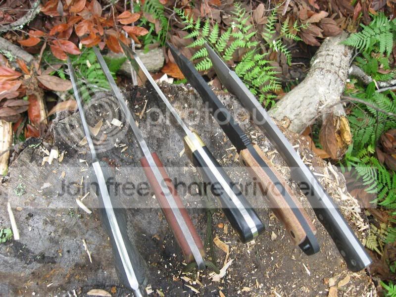

8" Blade Camp Knives Compared

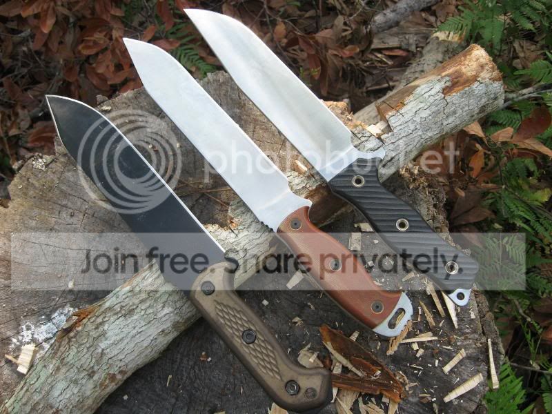

The Becker is a fine chopper. Here it is with some similar sized knives, the Swamp Rat M9LE and Ranger RD9.

The Chopweiler is right in there, pitdog. As you know, it is an outstanding chopper, at least as good as the Old Ranger RD7 with a more comfortable handle. I have compared the NMSFNO with my Chopweiler in a different chop-off. These are all 8" blades and the CW is about 7.5".
Interesting that the 8" choppers went best to worst based on heaviest to lightest - it shows that weight is a very significant factor, design perhaps having more influence on long-term comfort than short-term efficiency. ??
Interesting comparison. If you take out the BRKT, which was designed with a completely different edge profile, then weight seems to become the overwhelmingly deciding factor. Do you think that is an accurate reduction or a coincidence?
On the Entrek Destroyer, besides the handle, what do you think of the blade design for chopping? Do you like that slight recurve?
Yes, that seems to be the case here. But in other chopping contests, I have had light knives like the Swamp Rat Camp Tramp do better than heavier ones. Balance, handle shape, overall length, and edge geometry all seem to be important, too. Also, while the BRKT edge profile may well be one of the thinnest here, all these blades have had their edges reprofiled to thinner convex edges than factory.

The Destroyer mystifies me. With that forward weighted bolo blade and recurve shape, it should chop better. I thinned the horribly obtuse factory edge as much as I could without just grinding the whole darned blade to a full convex profile. As we see from the old Ranger, the saber grind can chop well in some blades. I think I could chop with much more power if the knife had a larger handle. I have an old Cold Steel 10" kukri called the MTC that is a recurve that chops very well. It has a 1/8" thick saber ground recurve shape. There is just something wrong with the whole balance and feel of the Entrek. I wish I was smart enough to figure it out. I like recurves for chopping, when they work.
