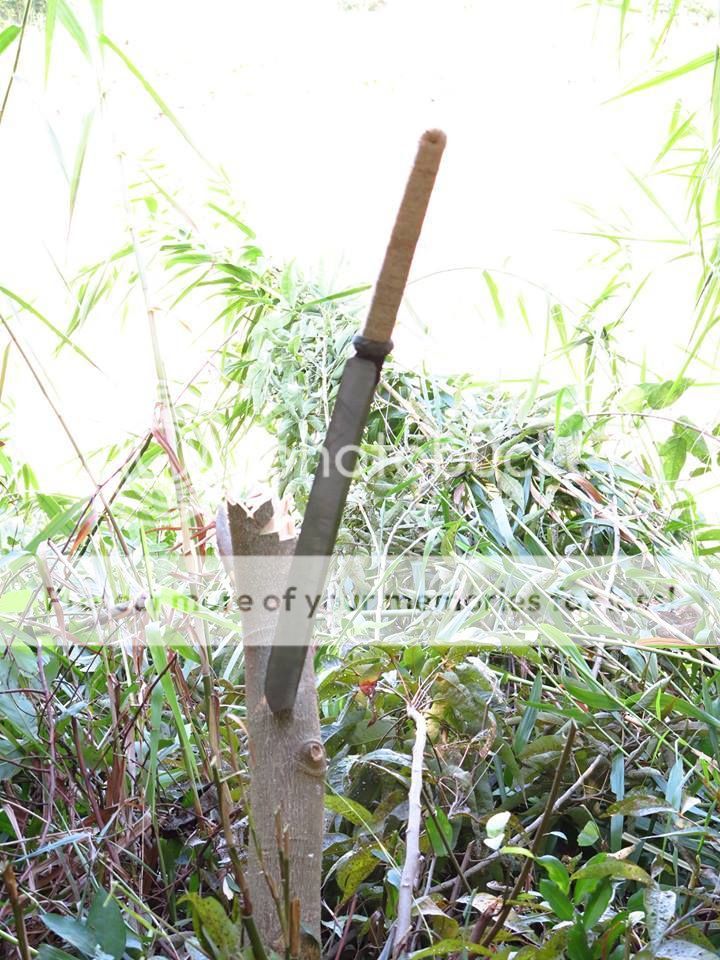

This is a waki made of 52100 with 6 step normalizing in precise digital control gas oven, double quench at 1500F in canola oil and triple temper at 400F. Gas torched to draw back the spine 2 time.
0.014" thick behind the edge. Can easily chopped through any 2x4 with zero damage.
We have done numerous test with 52100 to find the most suitable heat treat protocol to each of blade application in our use.
Simple to low-alloy carbon steel like 52100, O1, W2, 5160, L6 etc. with no selective hardening would have much higher risk to fail when it come to high impact application like wood wakizashi or very large camp, Those selective hardening/tempering also vastly improve shock absorption.
The reason for all of this are pretty simple metallurgy... 950F tempered martensite of these steel are much tougher, resilient and softer than 400F tempered martensite.
Pearlite structure also the same story but not as strong as spring tempered martensite.

Yes, it has zero visible damage and can slice print paper clean.
It won't be as strong or as tough as high alloy mono-hardened steel like INFI or 3V but in my expereince it take sharper edge due to finer grain and hold an edge a bit longer.
