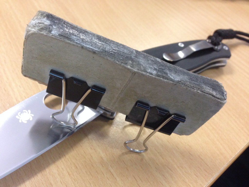

bluntcut said:HeavyHanded said:Blunt, I had one other thought in this direction that I never tried before I peetered out and started going down the WB route. Based on the endgrain paper strop I thought that stacking some hard leather endgrain (side grain) might yield a hard enough surface yet still have the microtexture variations you're looking for. The leather could be boiled/cased first, stacked and trimmed very close to its support, maybe two angle plates laid lengthwise. Put some padding on the bottom leg of each angle and you'd have a crazy durable strop. Also (maybe), like the endgrian strop, if it did collapse under higher pressure it would be over a larger area and any convexing would be spread out by several factors over the relatively local collapse of flat leather. I am still dubious of gaining any sort of control at the cutting edge when it comes to polishing specific facets of the edge irregularities, the scale is just too small.
Martin
Hi Martin,

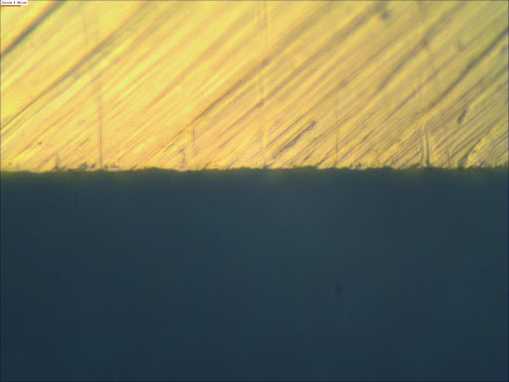

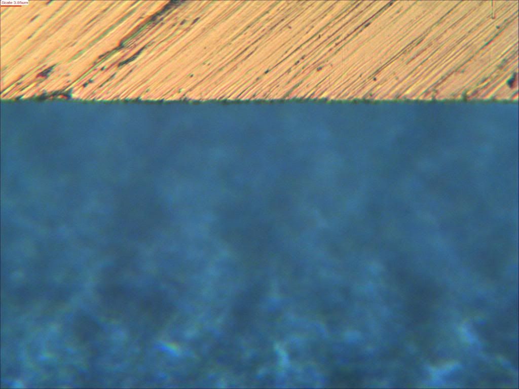

BS was seeded from your end-grain strop and again you're showing the way... I think your stack side grain leather idea could add a big improvement (albeit more time consuming to build). With finer & stiff texture, I think it may supports finer abrasive. Finer abrasive is needed if there is any chance of reducing the amt of cutting edge convex & rounding due to micron (and sub-micron) scale. I will try to make a small strop and hope it can support 1-3um (super fine) white compound.
For a while now, I couldn't find a suitable tiny rope with heavy short feathering, so I simulate the 2D + 3D by using fuzzy high quality paper towel over a mill file. It worked very well for variety of abrasives: AlO, SiC, CBN, Diamond down to 0.25um. With my 400x (more like 100x optical) microscope, I saw improvement and almost the novelty sharpness I seek. I think len cleaning paper(it would fuzzy up fast) would even be better and couple with a super fine file, maybe it will support abrasive at 0.1um in size. Maybe worth a close up?
