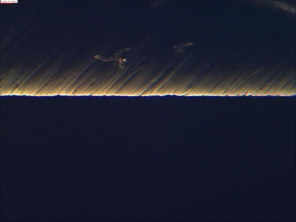

Martin/HeavyHanded took a few micrographs of the edge produced by the Balanced-Strop. He was very generous in giving consent for me to post his works. rather than stating how impressed I was with his utmost professionalism thoughts & consideration; I will just re-post PMs content ...
THANKS MARTIN!
date: 20130826
subject: First attempt w/ BS

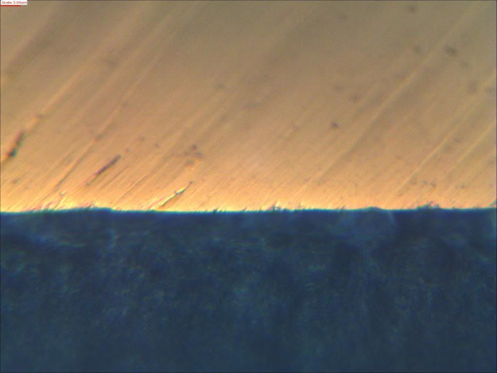

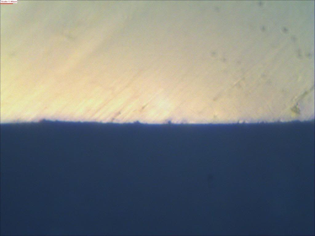

Hello Blunt, got around to doing a little work with the BS strop. I'll likely have another go with it in the near future, but this was the initial run. I'm not happy with the quality of the pics, but might have trouble improving on them.
I used about 3 lbs of pressure max, most passes were in the .5 to 1 lb range, finishing with some in the 3-4 oz range (I used a postal scale under the strop so I'd have a bit of 'science' behind this aspect). Knife was the CS Voyager I used in the photo workup, not the one I used for the CrO test. Bevel polished up nicely, shoulder softened somewhat, and bevel itself appeared more convex. Used approx 30-40 passes side.
First image at 100x shows the amount of bevel rounding. Knife shifted on the stage to approx 25 degree angle needed to bring the apex into focus relative to the back bevel.
This at 400x, showing a bit more of the convex.
Here's at 1000x - microscope struggling with low viscosity oil sliding away from objective, and depth of field at this magnification also having a little trouble bringing apex into clear focus.
The edge shows considerable refinement and uniformity over the previous:
but very difficult to say what the terminal edge angle has become - there is no hard transition line. When time allows, I'd like to grind a fresh bevel on this same knife up to 600 grit, then use the WB with your compound, take pics, than use the BS with less pressure - in the range of what I'd normally feel comfortable with, 2-3 ozs pass for 20-30 passes, no more than 4 ozs in any case. Check of knife angle to the stage before and after to make estimation of terminal edge angle a bit more scientific.

Great pictures Martin :thumbup::thumbup:
I really appreciate your thorough work, letting me view into what BS edges look like, especially the amount of bevel convexing. And very valuable info on apex rounding & refined for given steel+bs interaction. I am somewhat surprise to see excess bevel smoothing/convexing, but perhaps I in denial because I can see how BS produced satin finish bevel many times.
I will carefully study these; new; comparative pictures. Already I can clearly see http://www.bladeforums.com/forums/s...h-vs-Cold-Steel-Recon?p=12493965#post12493965 WB edges stay true after your compound + paper. Good job on your choice of media & compound formulation. I guess, the BS suffers a large convex factor from the give of leather. I want the leather nap but not the 'give'. Maybe a thinner leather with same nap would works better.
