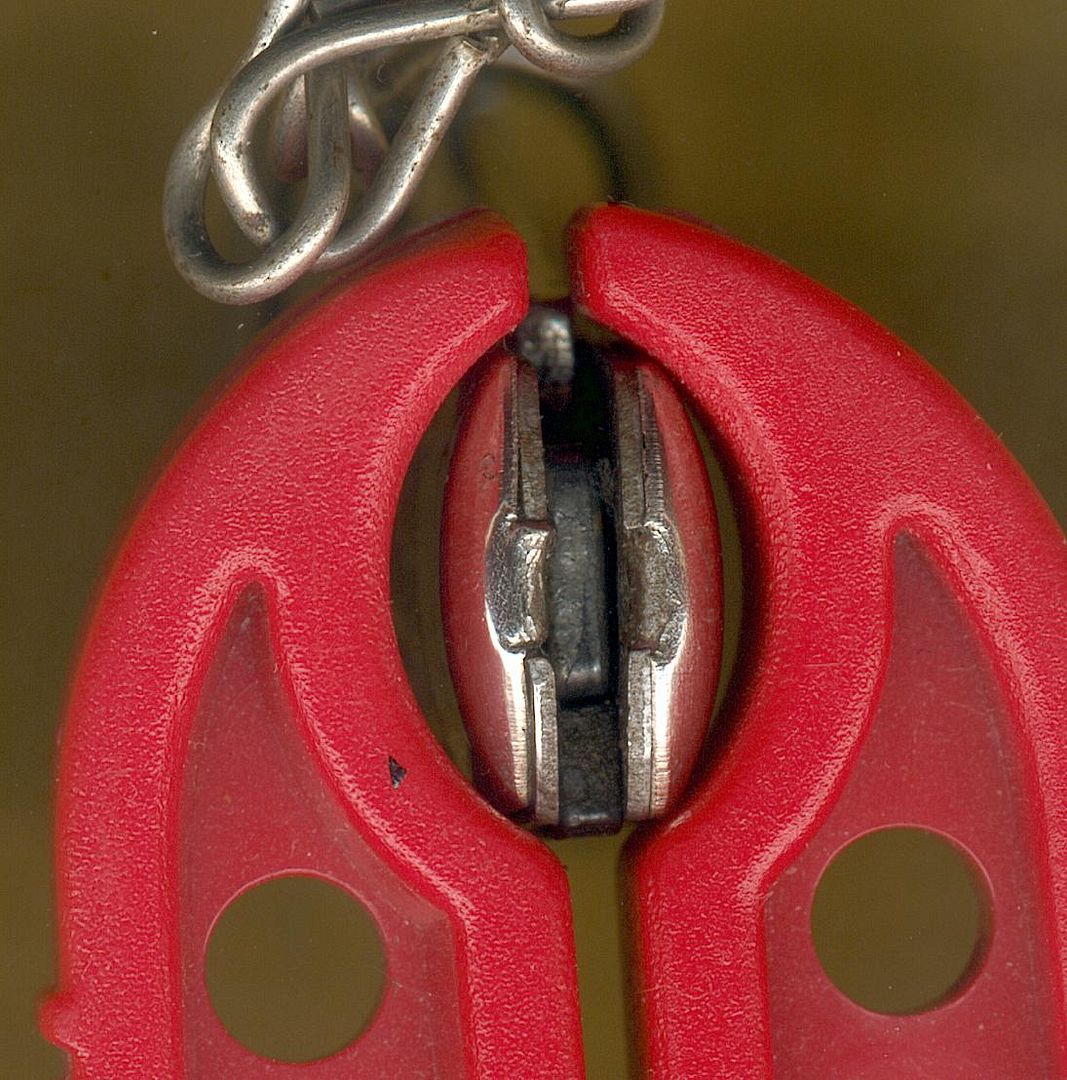

Thanks for the history lesson Charlie. Can you describe the construction of a shell handle to me? I've heard the term before, but have never figure out what it meant.
- Christian
- Christian
Christian, a shell handle is a sheet metal stamping, sometimes textured, sometimes smooth. The "bolsters" are part of it, and it is hollow, with integral tabs that are folded and tucked into the skeleton knife to hold the handle on. The finish was often thin sheet celluloid, or just paint like this one.
Here's a picture of the end of the knife, being held up with a plastic clamp to enable the scan. Hopefully you can see the two tabs, folded into notches in the liners.
BTW, the edges of the shell handle are folded under all around, to provide a smooth feel to the hand.
