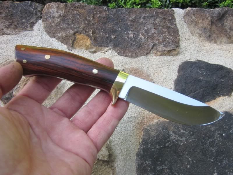

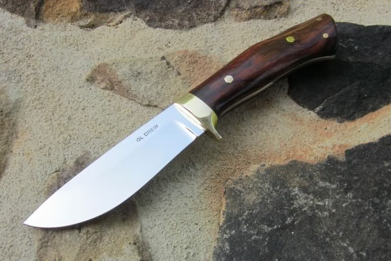

I am still making a few stock removal knives and here is one of my favorites.
1/8 inch ATS34 steel
Hollow grind
Mirror finish
Cocobolo handle
Overall length: 8 5/8 inches
Blade: 4 1/8 inches
Riveted leather scabbard
$160 delivered to the US or Canada. My PayPal account is gldrewknives@yahoo.com Contact me for other payment methods or overseas shipping arrangements and costs.
thats a beautifull knife! I am trying to figure out how you did the hexagonal pins. I have a hard enough time not ending up with gaps or glue lines with round pins.
excelent work.
It only works with cocobolo but try drilling a smaller hole, pointing the end of your pin and drive it through. If you split the handle I won't be responsible.:D
