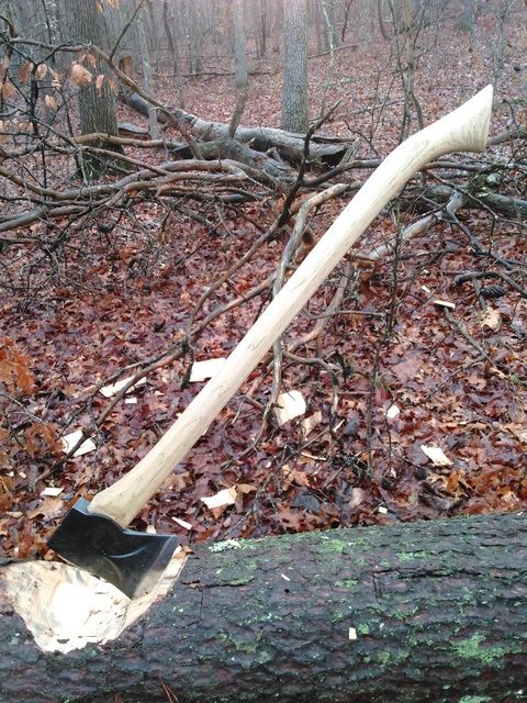

Here's a fairly simple question. Does anyone think that the axe with the offset neck is going to inherently want to twist in the hands during a horizontal swing? If so, explain your reasoning. :)
It depends entirely on the axe and the location of the hands. It can range from not very significant to quite significant due to the relative ease/difficulty of applying those forces at different times.
Then how about showing some real-life examples where the effect is "quite significant" (in the context of what I've been disputing)? I gave some real-life examples (book, axe, hatchet) that show that the claimed effect is not very significant.

More pictures. The piece of tape on the head marks where the drop line passes through. As previously noted, the center of gravity is out in empty space, though I could probably rig up something with fencing wire to demonstrate that if deemed necessary. The axe will balance horizontally on any two points on a line passing through the center of gravity.
One end on a grade stake, the other on a finger.
Two grade stakes so I can actually take shots from multiple angles.
With the lower grade stake moved up on the handle. Still balances fine because the main length of the handle lies on that same axis.
Doesnt this show that it is bit heavy? If not why wouldnt the other stake be where the handle meets the head not on the bit?
...On the red line. That's where all the rotation takes place when the upper hand is sliding, and is the axis from which bit depth as pertains to wobble should be measured from. If you have a bit that measures 8" to the eye but only 4" to the axle, the amount of bit travel that occurs from any twisting of the axe will be the same as on a double bitted axe with 4" deep bits.

Huh? The location of the eye has very little to do with the balance of the overall axe other than where the handle is attaching. There is more mass in front of the eye than behind it, obviously, but the bit side of the axe is not going to dive during horizontal strikes like it would have on the factory handle. The axe has been brought into horizontal balance by putting as much of the handle as possible in alignment with the center of gravity.
I wasnt throwing off on the axe or saying that it would dive when using 2 hands just saying that it would still be bit heavy. I believe you definately improved the axis of control of the axe.
But i would think that a perfectly balanced ax you could balance at a single point or iin your pictures a stake and the bit would stay horizontal. As i said im no expert or understood most of the stuff in this thread. I got alot of respect for everyone in this thread and have actually purchased from baronyx :-). So im not wishing to ruffle any feathers. Im just trying to understand.
But i would think that a perfectly balanced ax you could balance at a single point or iin your pictures a stake and the bit would stay horizontal. As i said im no expert or understood most of the stuff in this thread. I got alot of respect for everyone in this thread and have actually purchased from baronyx :). So im not wishing to ruffle any feathers. Im just trying to understand.
The center of gravity is out in the empty space between the offset of the neck and the bit so that's not possible to do. If the straight region of the handle kept on going instead of curving into the offset then it would pass through the center of gravity, and then I could do that, though.
