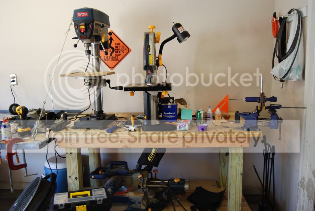

Its supper sturdy and has a 8x10" wooden table that is also sturdy. I can easily cut out a blade blank in 10 mins max depending on size etc. Touch up the profile in 5-10 mins depending on notches curves etc and im good to go. I could have spent more but really I just dont see the need after having it. Im all for buying the right tool for the job. Here are a few other toys I use and this bandsaw setup is just as good as the others tools in my shop!
Different angle pic of bandsaw and if you wanted you could make a bigger table area but ive found this plenty big enough. That paper outline is 12" long for reference.
Im not showing this to showoff or anything just saying Im willing to spend money (sometimes >1k$) for the right tool and if my 80$ foot pedal band saw is good enough its good enough otherwise I would have gotten a better setup. Now Im not saying there arnt tools that could do better but not anywhere near the price.

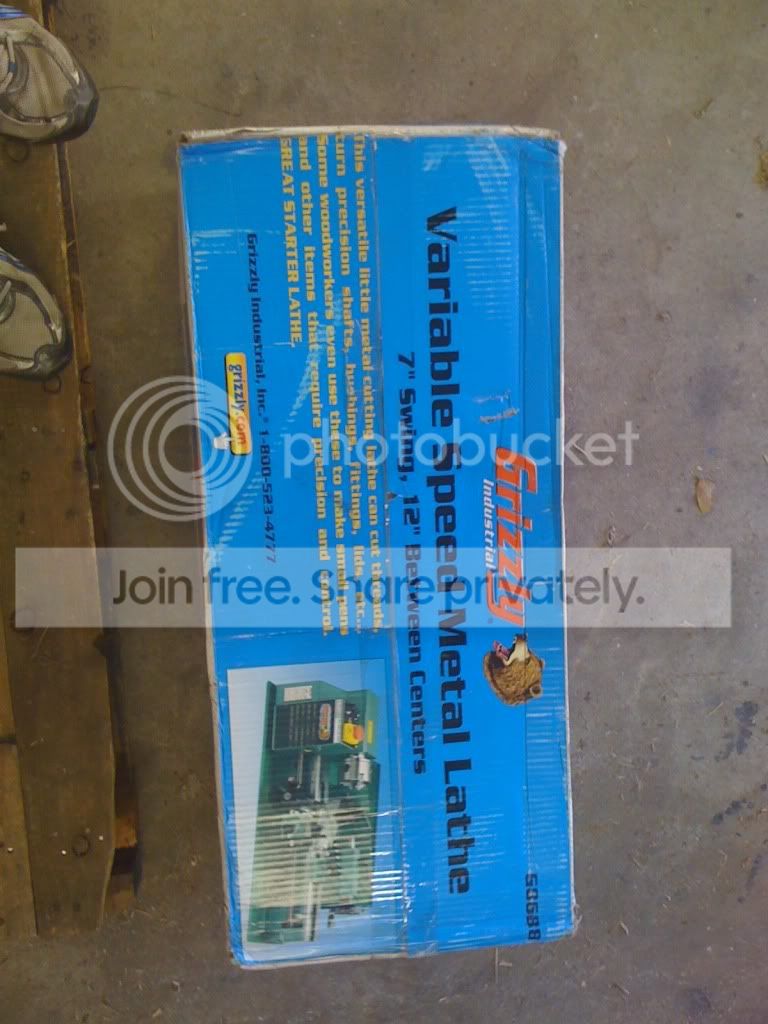

Did you get that lathe after watching Dan work with his? I have moved a lathe up the list on my wish list
Jason
William,
Jason

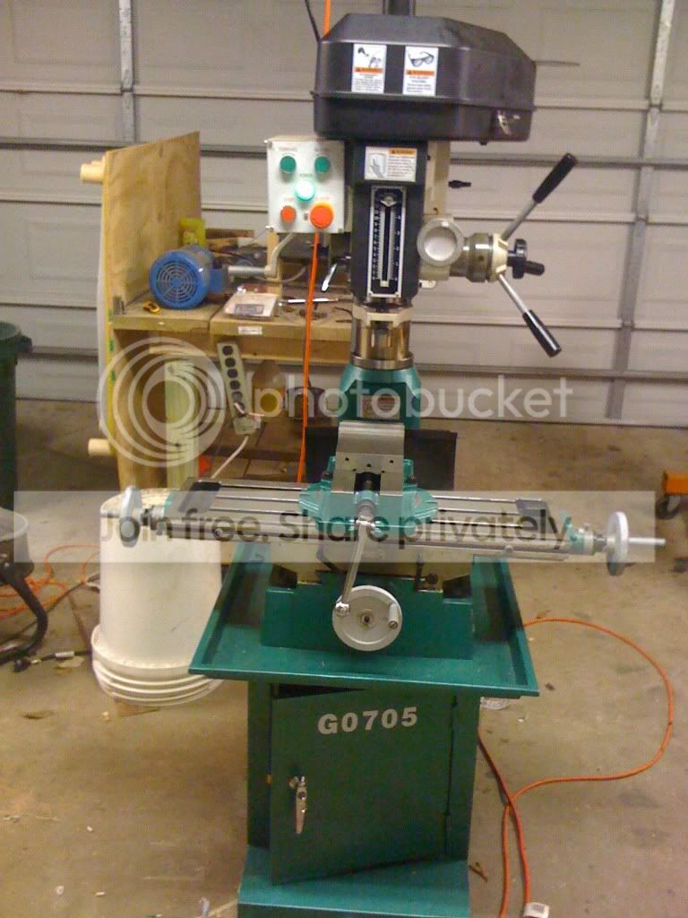

LOL actually yes. I wanted the mill (remember Im a nurse with a mechanical engineering degree) before I was really into knives for all kind of fun things but as I was ordering I was liek what the hell (thinking of seeing dan use his).
