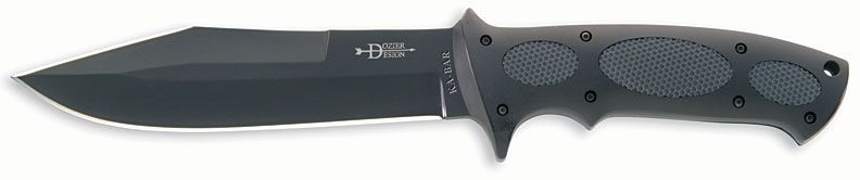

Too bad their wasn't more on the Ka-bar "bull dozier"
6.5" blade. (acceptable)
AUS-8.
12.2 oz.
No serrations, added bonus.
Though I dont know about the sharpend swedge, also made in Taiwan.
