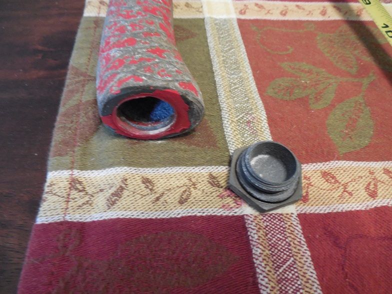

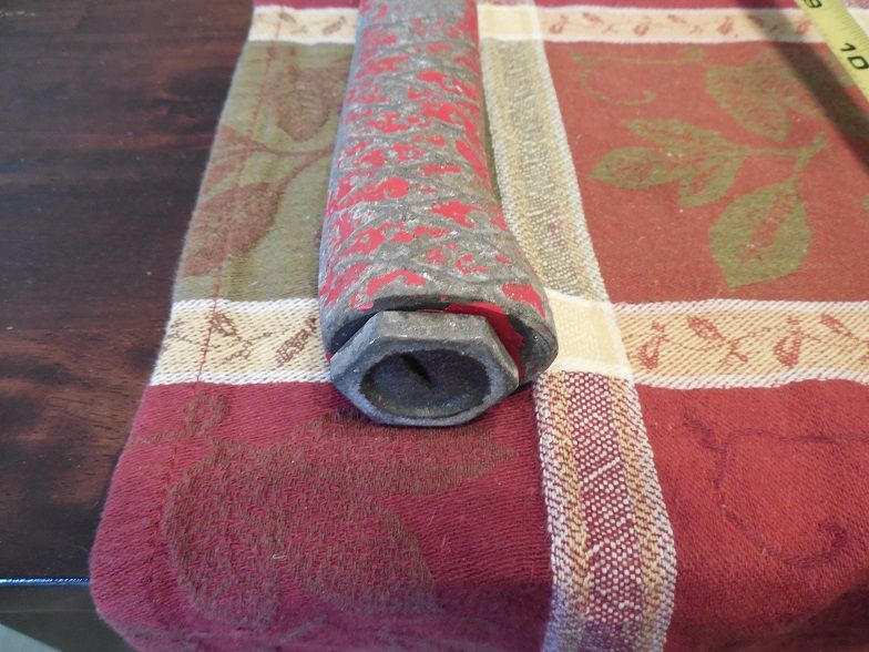

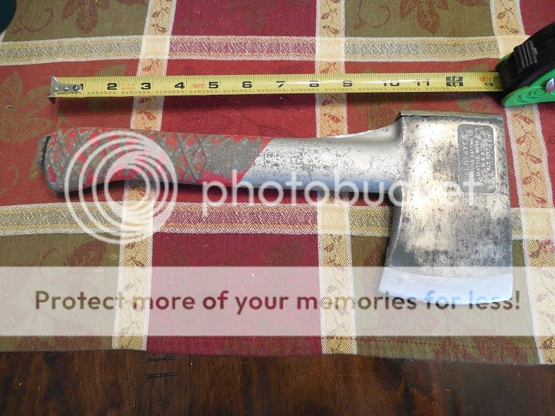

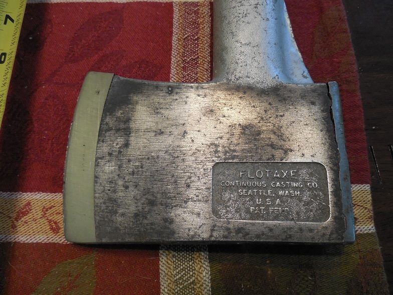

So I have this little hatchet from my grandpa's old shop. I never saw it used and he gave it to me when I was about 14 or so. The blade is stamped FLOTAXE and the manufacturer is the Continuous Casting Co. of Seattle WA, who, as it turns out, are still in business (since 1958). The FLOTAXE is hollow with a screw plug and rubber washer at the bottom of the handle (I'd assumed this was along the lines of the "survival knife" where you'd have matches and fishing line stored there). There's a bit of steel at the blade and the poll and I had assumed that the rest was aluminum. There's hardly any weight to it and so it does float well; chopping not so much. I dug it out today and Googled around and found no mention of it.
I called up Continuous Casting Co. and spoke to a gentleman who has worked there for 30 years and knew of the axe but said that they never made it while he worked there. I also learned that the handle is not aluminum, it's magnesium (He'd heard shop stories of the axe catching fire when they were grinding the blade). While I'd always though of it as a relatively useless axe due to its low weight I was also told that it was designed to be filled with sand when you got where you were going to give it some mass for chopping and then emptied before you resumed packing it. I have not had a chance to test it out filled with sand but as soon as I can get some dry sand I intend to see if this thing can actually chop.

Russ' floataxe looks a little different than the patent. Russ' appears to have a different metal on the poll, rendering it functional vs. a magnesium poll. The patent drawings show no different metal at the poll.
