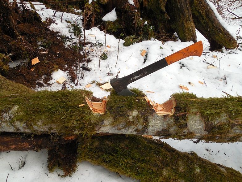

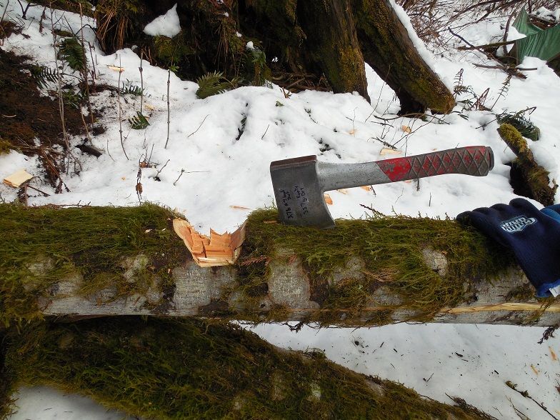

So I finally got around to weighing the hatchet and trying it out filled with shot. The empty weight of the Flotaxe is 357 grams/ .787 lbs/ 12.59 oz. Filled with #9 shot (smallest I could find) it weighs in at 1678.29 g/ 3.7 lb/ 59.2 oz. so, quite a noticeable difference.
Chopping with it was a little odd since there is no "feedback" when you chop since the loose shot dampens any vibrations. On a normal axe you can feel when the blade cuts deep or when it deflects or goes shallow. Not so with this one. Every cut felt "bad" even though it was throwing chips. I took 25 swings on a cascara trunk that fell down in the snows the other day. For comparison I also took 25 whacks with my trusty fiskars. Here's what it looked like.
I guess the dead blow feature provides a foreign enough feeling for most initial users that enthusiasm for regular use immediately drops off. I can imagine these hatchets to be found buried in the bottoms of fishing tackle boxes, in cupboards of hunt camps and maybe in the gloveboxes of a few vintage offroad vehicles. It was good of you to actually 'fuel it up' and do some chopping with it. At very least it does work!
Very cool! Looks like it works better than I anticipated.

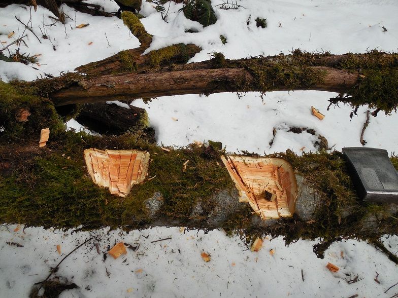

Since this thing was designed (per the patent) to go in a pilots crash kit I'm guessing the pilot wouldn't be carrying lead shot to fill it with. Wet sand, mud, dirt, etc would be used depending on where you crash. Noting that the cap has a watertight seal I took out the shot and filled with just water (which I figured would be the worst case scenario for fill material) and tried it out again. The chop on the right is the water weight one the left is with the hatchet empty (25 whacks ea.).
My final assessment, given that this was designed to be as light as possible and still perform as a hatchet in an emergency, is that the thing works as advertised. Almost any solid hatchet would work as well or better but would not come close to the transport weight. So, if you're a particularly weight conscious bush pilot, here's your axe. I can see where the target customer base was not enough to keep it in production, clever as it is. It was fun playing with an axe where I could vary the weight at will.

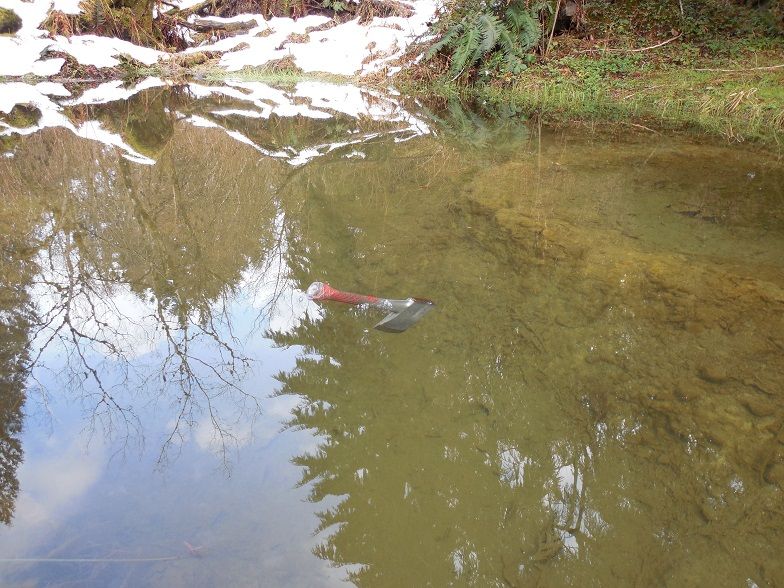

And just to be thorough, and because it is called a FLOTaxe, I threw it in the pond and yes, it does float (only just).
