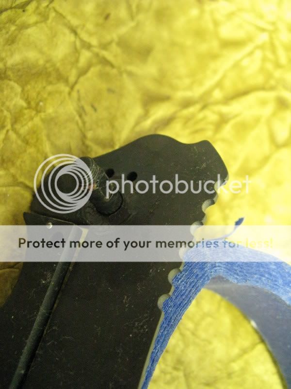

Also the Digi ZT 300 in my pics, has been modded by me. It now has a finger choil, more info with pics HERE. (click me)

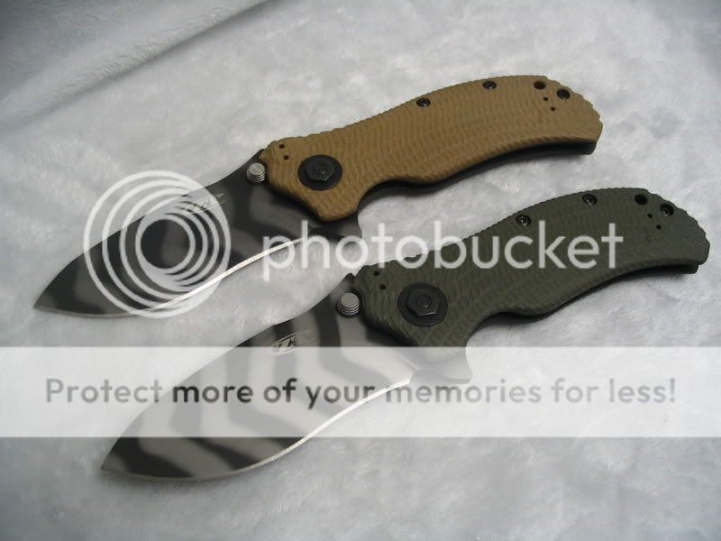

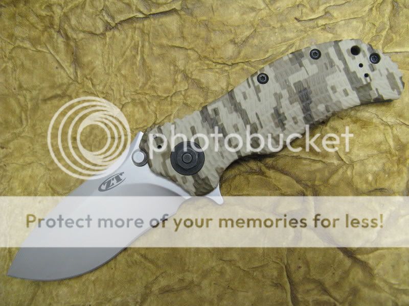

You might see the 300 dressed like this
Or like this one a TAD gear only Digi.... with the different swedge. (this is the modded one)

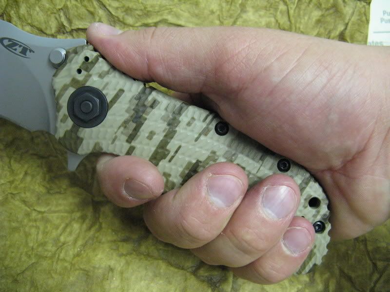

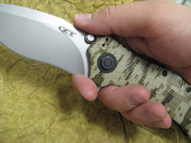

This knife fits my med. sized hands great.
With my finger choil, the choked up grip is great! With out it, its not as good.

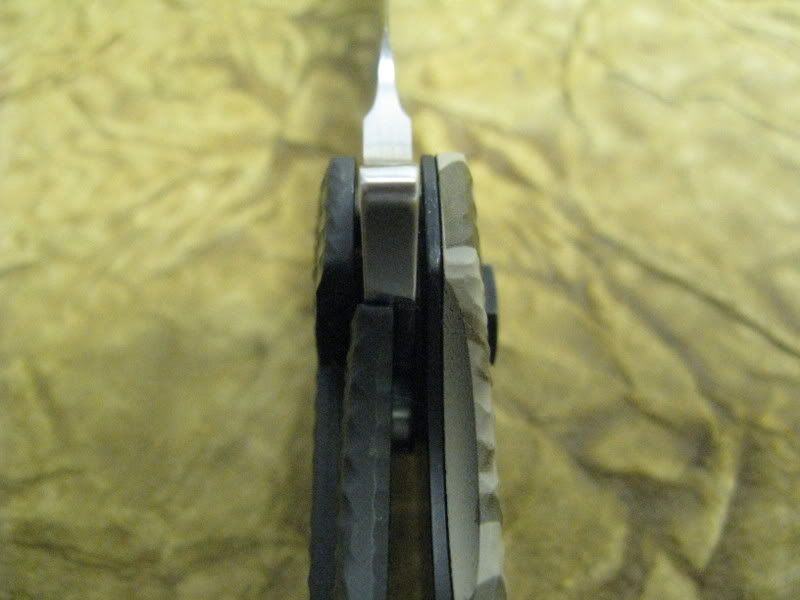

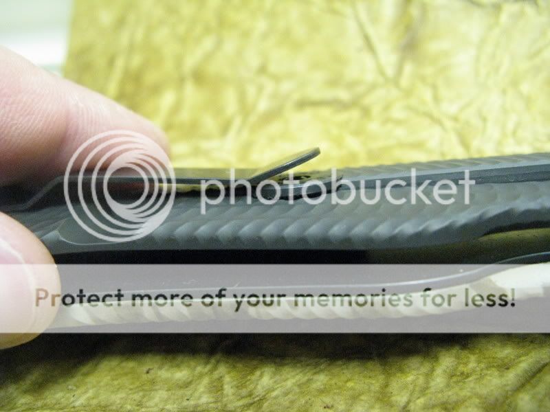

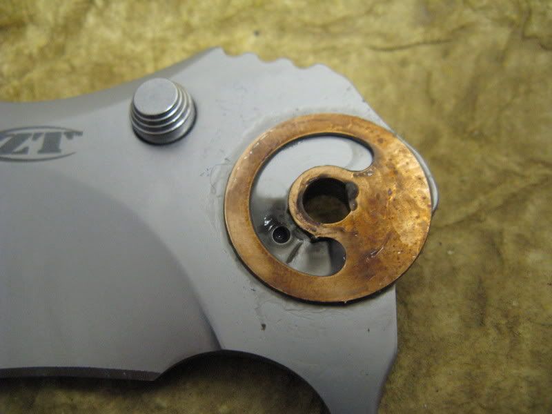

OK here is one thing that might fall a little short. The Hinderer button is used on the ZT 300. It purpose is to stop the lockbar from being sprung over while unlocking it. It ALSO stops the lockbar from moving up and down, as you grip the knife. (remember that "hard use" knife..this might be way way over kill, but thats what you want in a "hard use" knife.) Anyways, the ZT button is not thick enough to stop the up and down movement. Not that is a big problem of anything. Just its not the SAME as a XM. Honestly its not really a big deal, if I grip the ZT 300 I can't get much movement at all. But it is due to the thick lockbar, not the button. Here are some pics, they might help my case better.
See how when locked up the XM's button will stop the bar from moving up? (think gripping it as hard as you can, the lockbar will not move up at all! Due to the button.)
The ZT's button is thin, and misses the lockbar when locked up.
Really though, its not a make it or break it type thing at all. Just letting you know.....you know?

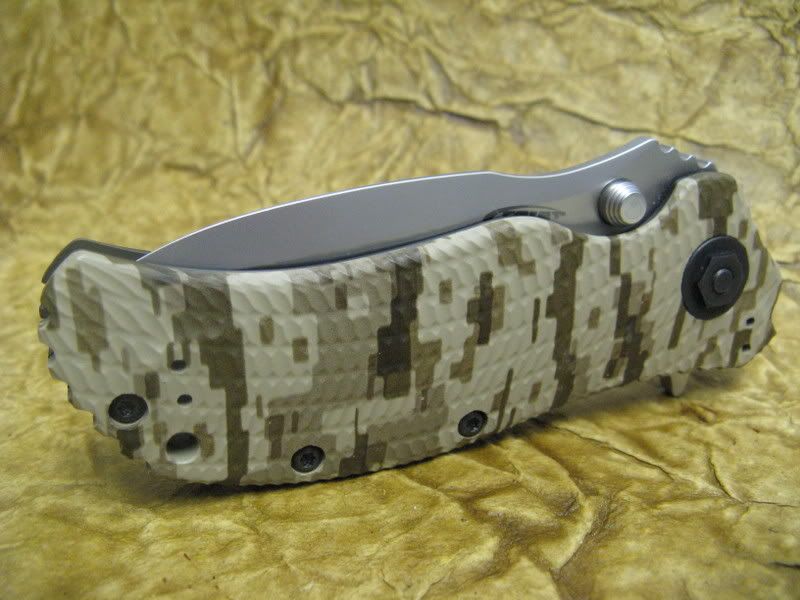

Like I said Fit and Finish is top notch all the way!
Nice lockup!

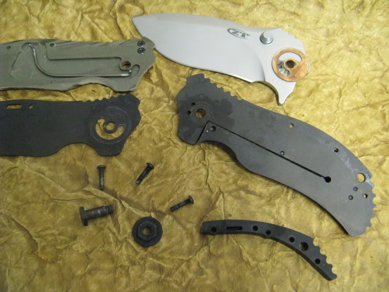

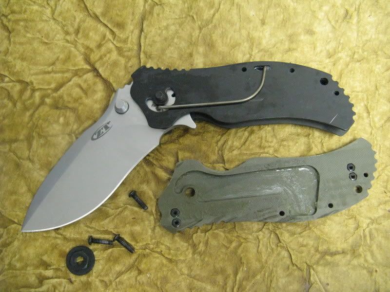

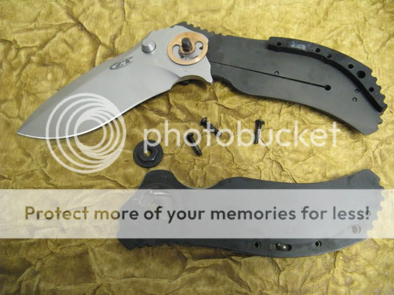

Lets take a look inside this beast.

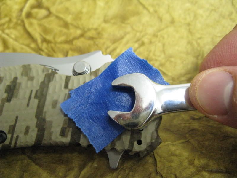

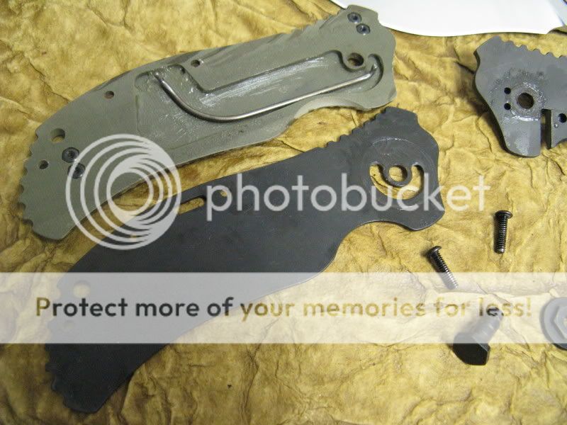

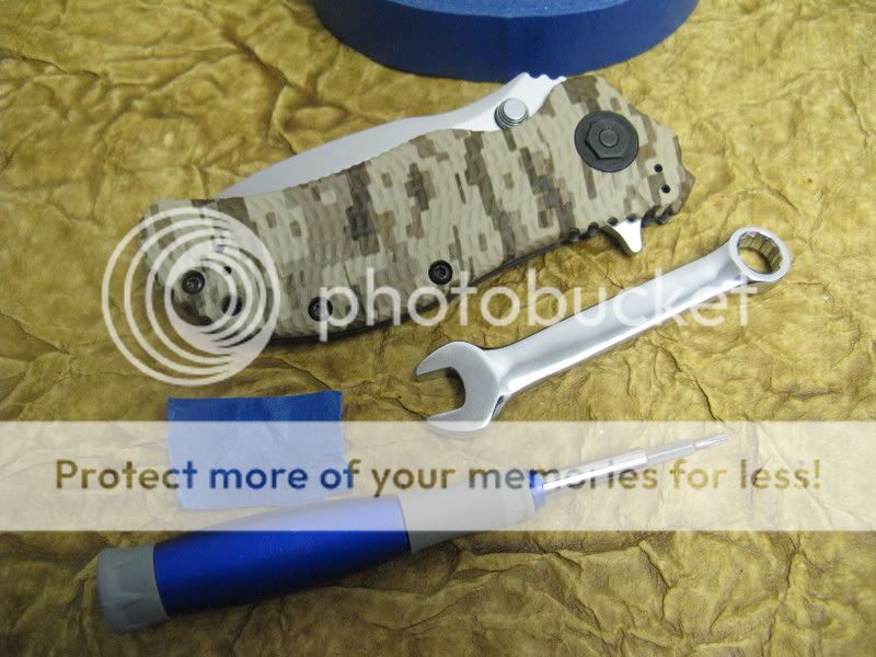

Quick tip, I use tape to cover the pivot bolt, then unbolt her. (No scratchy ;))

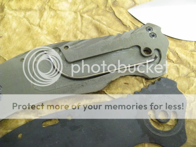

Speed safe
All apart. I like how the G-10 side has a steel liner. (can you say "hard use?")

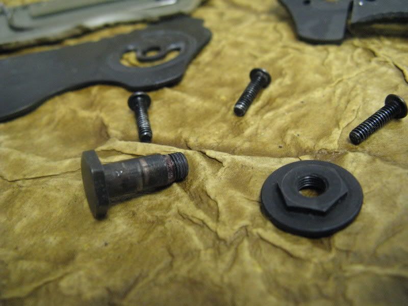

Hardware, look at that beefy pivot! :eek:
No plastic washers here!
Also be sure when you put her back together, you put the flat side of the bolt up. (Like so)
All most back together. See how the Speed Safe bar pokes out on both ends? One goes in the hole at the tang area of the blade. The other goes in the G-10 back spacer.
Just need to put the lid on her, and she is good to go!

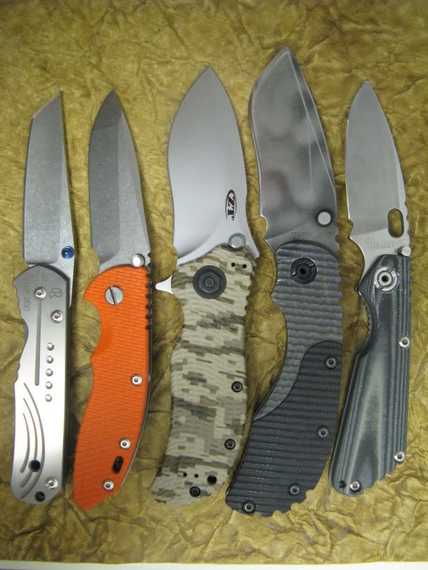

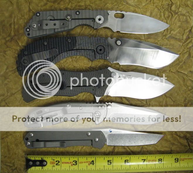

Here it is next to some other "hard use" knives. Yes, its does hold its own next to all these costing 2 to 3 times as much. :eek:

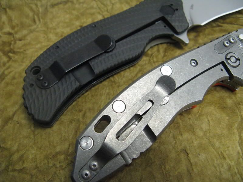

Its wide in the pocket, and a little heavy. But most "hard use" knives are a bit on the heavy side. They are not tanks because, they are lightweights. Its not pull your pants down heavy, you will know you are EDCing the ZT 300. The clip can be move tip up or tip down, left or right handed. (Very nice!)

Nice review and nice pics. I also like your modification. Did you grind it out with a dremel?
Yes, a dremel and the larger ( still real small) sanding disc, lots of blue tape. I wrapped the whole knife up in it, the only part showing what the area to be cut. I got it close to the scales without bumping them. Then took it apart, and finished it out. I didn't want to bump the scales.
I then went to the med grit disk, made it just the right size, then rubbed it with wet sanding paper going up in grits untill it had a nice satin finish while still letting the grain like texture (from the course sanding wheel) show through.
Took about two hours, I'm sure I could of done it faster. But, I take my time on stuff like this...
