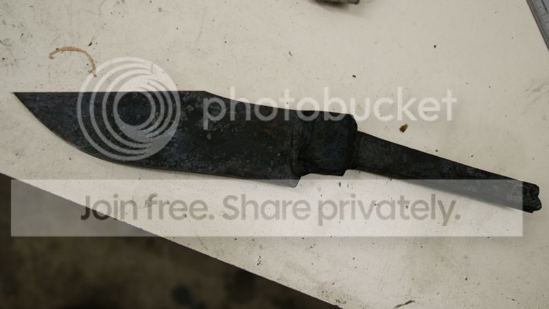

Here is what Erik has sent so far;
First pic is welded, forged and profile ground.
On the second pic I have ground the bevels and the transition to the bolster.
A little more grinding and it is ready for heat treat.

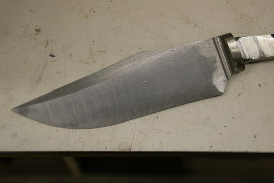

After grinding away the bulk of the unneeded steel.
After filing the back of the bolster.
Here it is out of the jig, the tang is still almost half an inch thick by a little over 3/4 high, that doesn't come off easily..

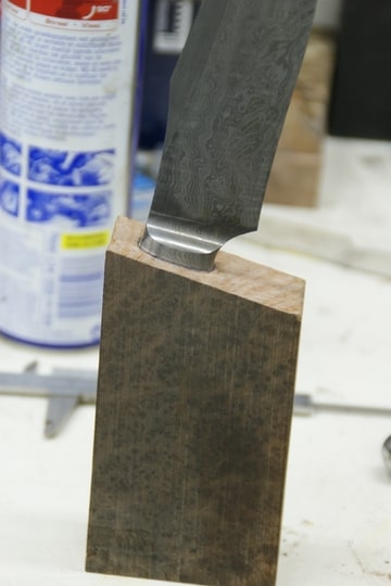

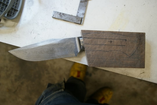

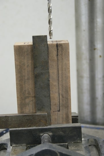

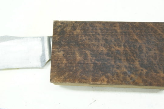

The blade with the beautiful stabilised Redwood burl block provided by Mark.
Drilling the pilothole.
Getting there...

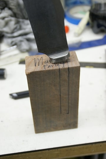

Sawed off the angle for the bolster with not much fitting left to do.
The block fitted against the bolster, the contour of the handle scribed and ready to drill the pinhole.

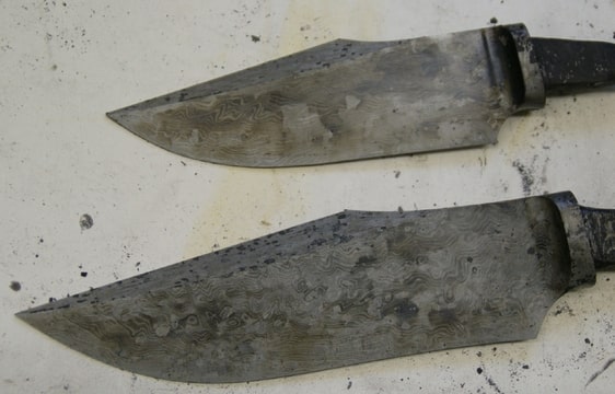

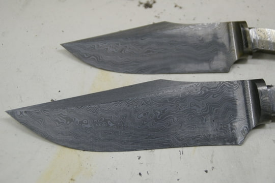

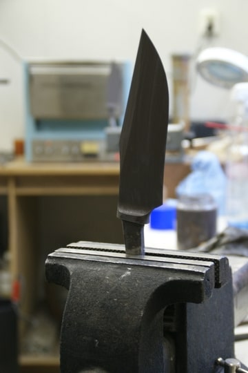

The blades painted in antiscale compound and my HT oven heating up.

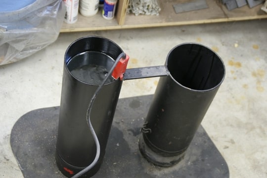

Quenchoil heating up. This is Durixol 25W wich is a professional HT oil, I have been using it for almost a year now and it is a great improvement over peanutoil in hardness and keeping things straight.
The blades as-quenched, nice and straight and free of scale. Lucky me......

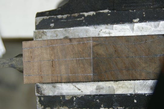

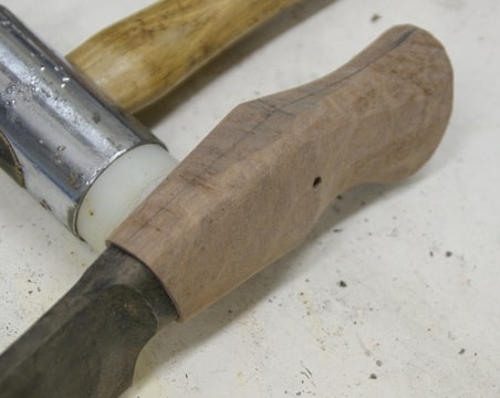

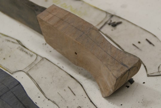

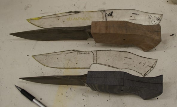

Here is the block ground to profile and the lines for the contour scribed.

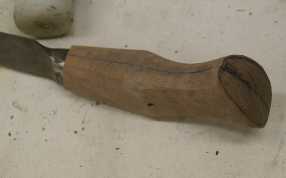

Roughly ground to shape.
With the template I use for these knives.
The corners knocked off and roughly shaped.
I make sure i keep the centerlines on top and bottom so it is easier to keep things symetrical.

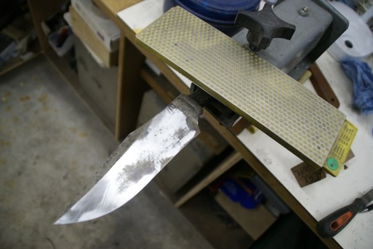

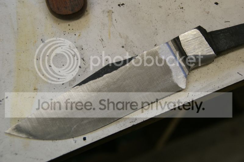

Now it is time to finish the blade. I like a flatground blade so I use a DMT diamondplate to take out scratches and high spots to get things really FLAT.
This is after a few wipes and it was almost flat already.
