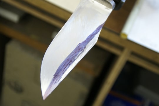

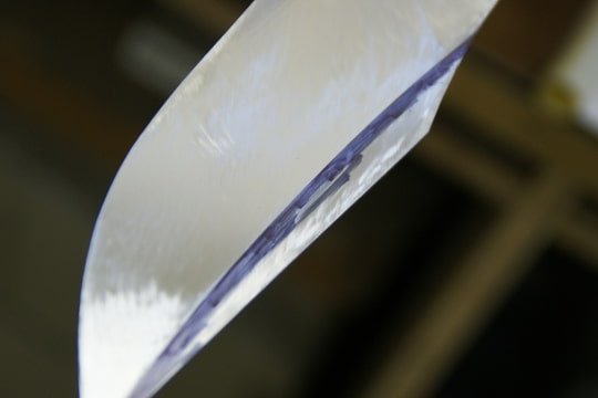

Cleaned up the swedge with a Diafold and put some marker on it so when I sand the flats one more time I can see if I have a nice flowing line.

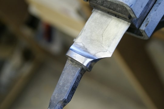

Cleaning up the bolster with a 600 Diafold.
Finishing the choil with an EDM stone.

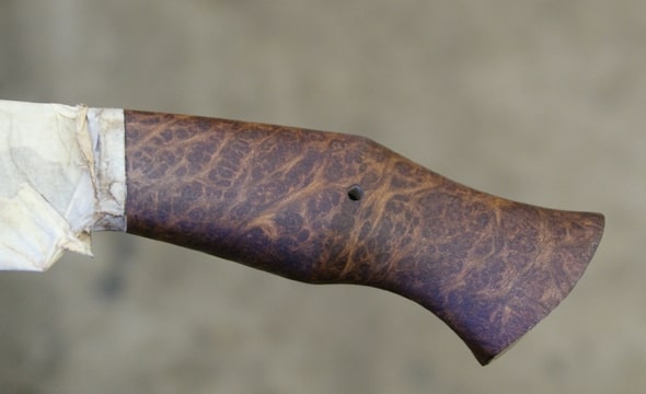

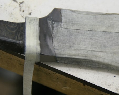

To make the handle to it's final shape I like to have a small step between the handle and the bolster.
I do this by cutting a narrow strip of masking tape and wrap that around the bolster.
I grind close to the maskingtape and do the rest by hand until the fourth layer of tape starts coming off so I get a even step of three layers all around the bolster.

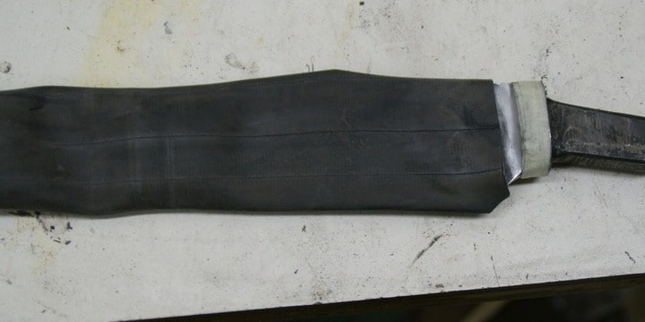

Cover the blade with a piece of bycicle innertube because accidentally hitting an almost finished blade with a fast moving 40 grit belt is not funny......
"Cover the blade with a piece of bycicle innertube because accidentally hitting an almost finished blade with a fast moving 40 grit belt is not funny......"
It sounds like you are talking out of experience.
I like your work and enjoy seeing it take shape.
I haven't done it yet but I can imagine the feeling it causes.

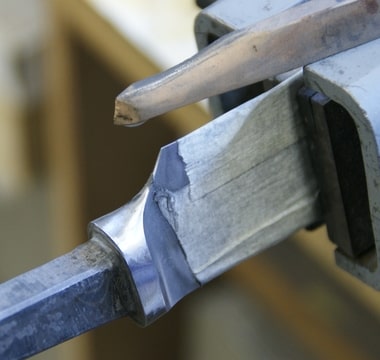

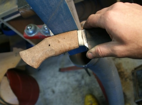

Getting ready to grind the handle close to the maskingtape.

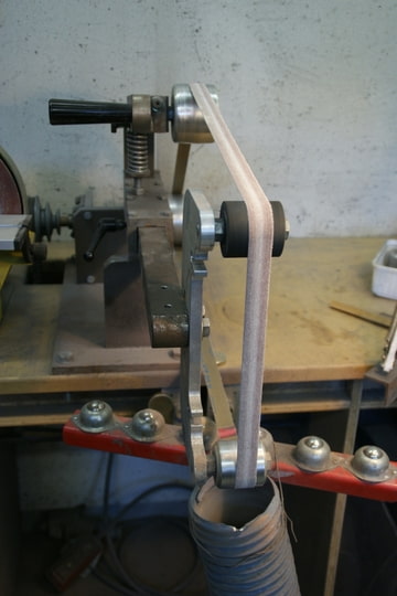

I have split a 220 belt to about 3/4" to get into the tight curves of the handle.
Make sure to break the edges of the split belt so they do not dig into handle.

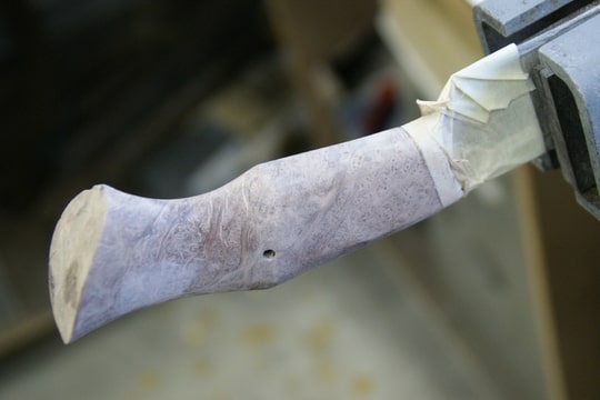

Handle roughly shaped.
Hand sanding to the maskingtape with 120 grit.
I will peel off the first layer of tape with 400 grit.

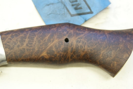

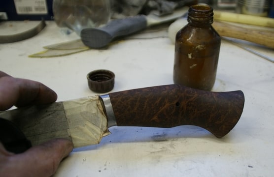

Handle sanded to 400. I do not like highly polished handles so I use an oil I got from a dutch knife maker that really pops the grain and fills any voids or checks in the wood with the oil and sandingdust.
You can see the first layer of tape coming off.
Handle at 800 grit with the magic oil. It has a bit of resin in it so it hardens with time and gives a very nice satin finish.
Handle at 1000 grit.

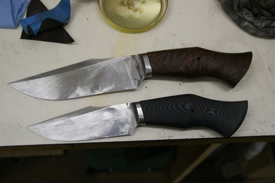

Overall vieuw with it's little brother wich I am making for myself.

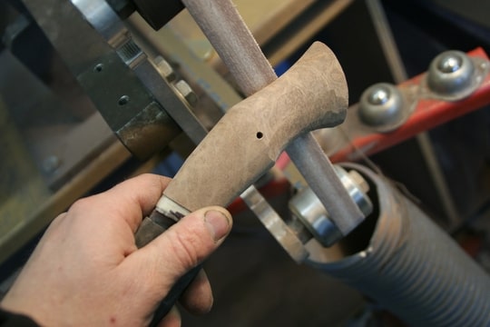

Now comes finish sanding.

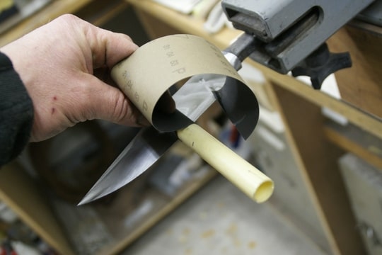

I use a piece of plastic tube because it fits the transition to the bolster and it sands faster.
I do not have to readjust the paper everytime, I just turn the tube a little while sanding.
It also gives more pressure on a smaller surface wich gives the paper more bite.
Erik, I am glad you mentioned using an oil that will build up a surface.
A lot of the makers just sand then buff with stabilized woods.
That can work out well with some of the woods, but many of the stabilized woods will still have some hairline checks around the eyes as well as small voids.
In my opinion, doing the finish the way you are showing makes wood that would have looked good look even better.
Plus, I like the way the oil brightens the colors.

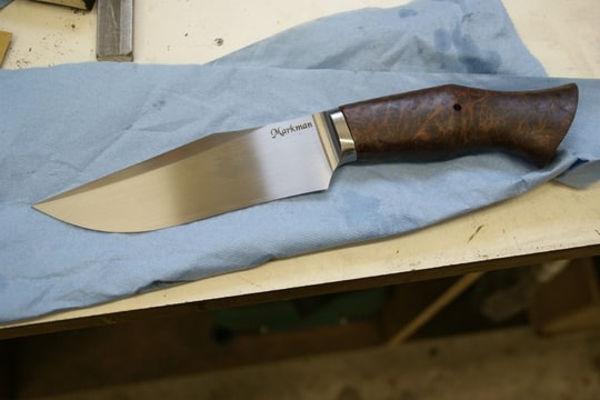

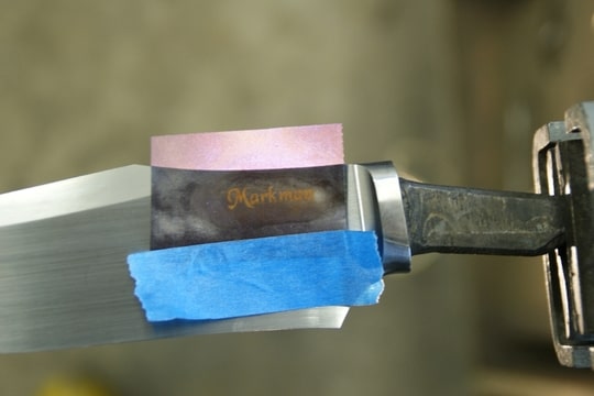

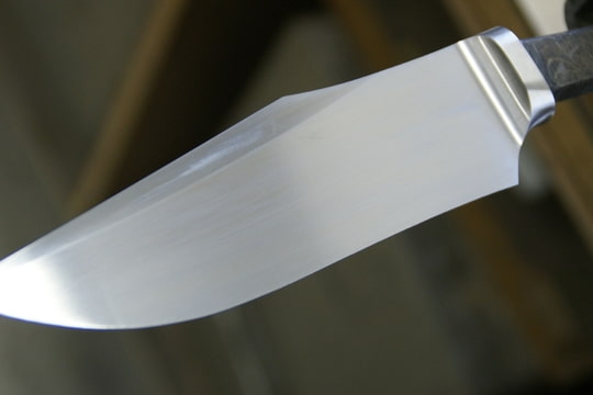

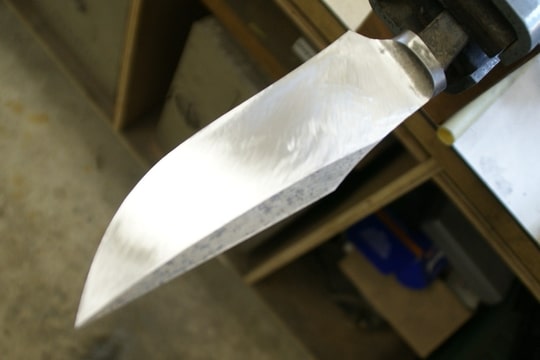

Blade sanded to 800. Logo is next.
I put a strong light under the blade so I can see where to put the stencil. It takes the guessing out of it.
Stencil from Ernie Grospitch.

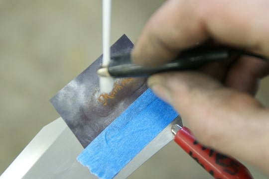

I use a batterycharger and a Q-tip and a bit of salted water.
Stuff used to do the etch.
Next is sanding to 1200 and etching the blade.
thats a really amazing knife,beautiful wood,i also like the indepth WIP,
whatever you doing buddy,you always do it only one way, the right one !!
i am very impressed,again !!
Really great looking knife. Thanks very much for the WIP.
