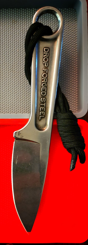

I had one of these for MANY years. Think it was 20 bucks back in the day (might have been the 686). Amazing blade, pretty indestructible with great geometry and heat treat.
