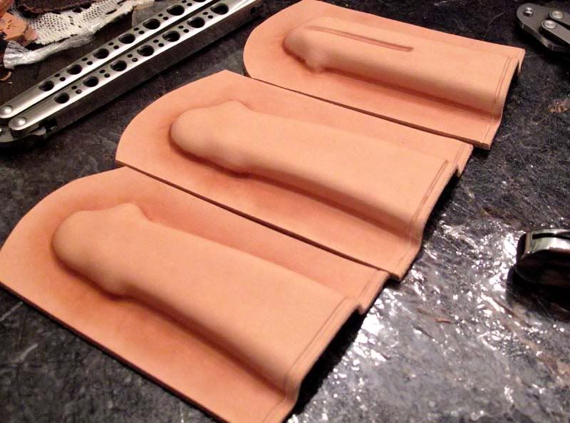

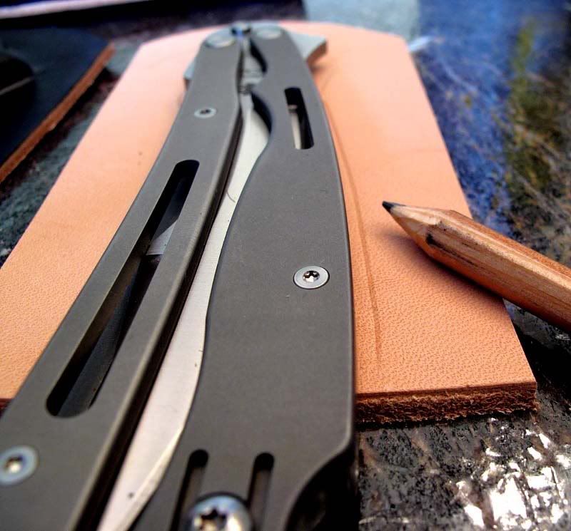

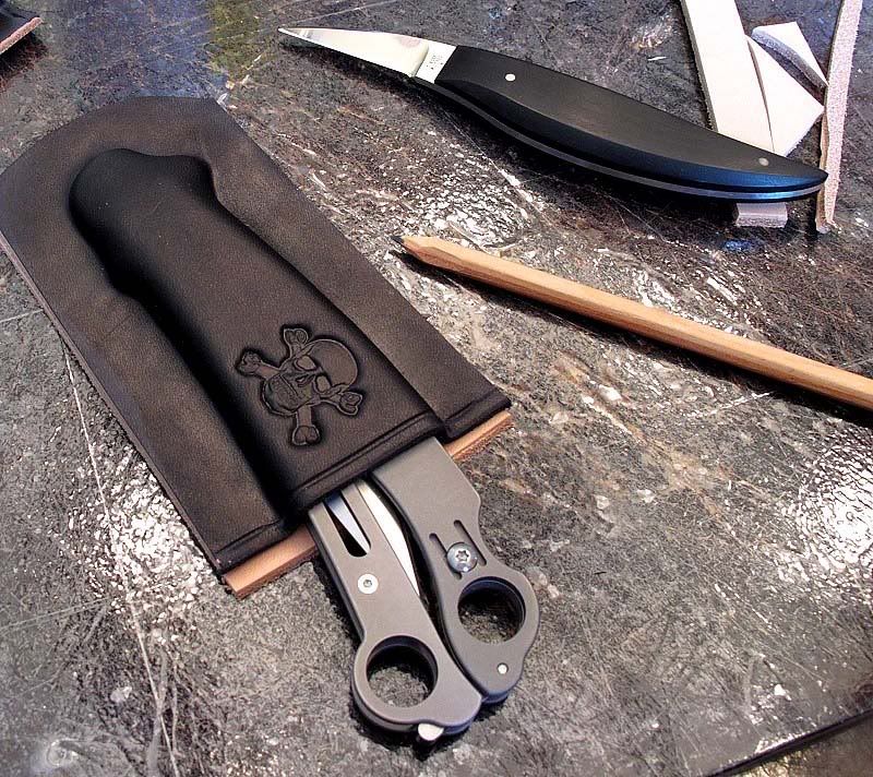

Working on a few sheaths this week, here are some images of the steps
as I work through making them;
The knives are
Spyderco Szabofly, strange butterfly knife but cool ;)
Benchmade 43
Bose/Case Dogleg

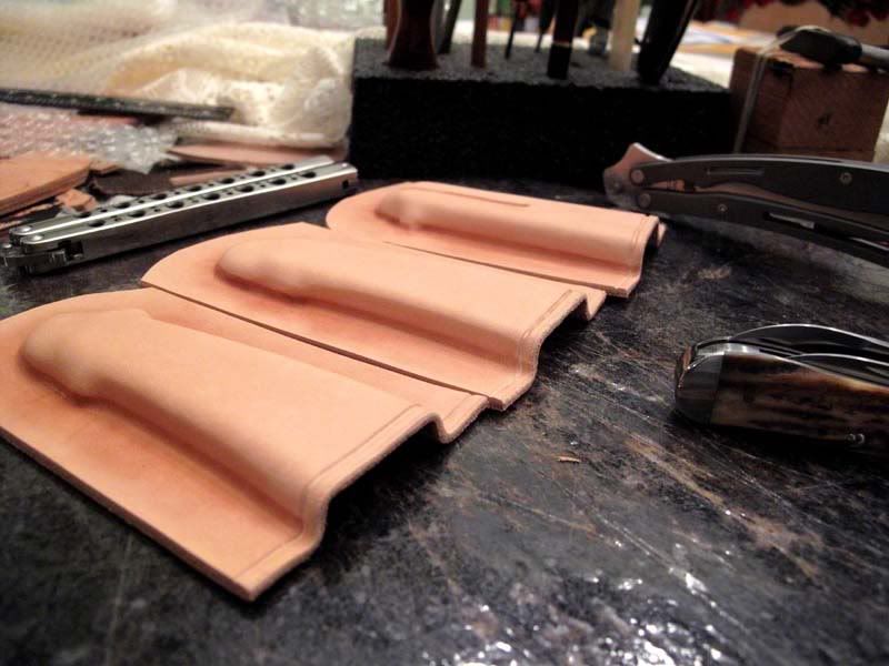

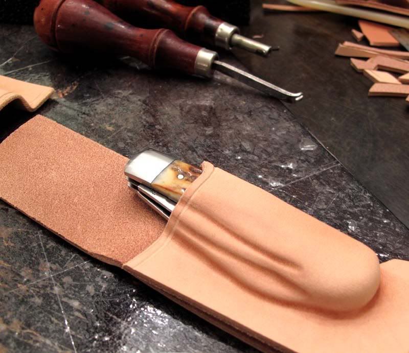

the above are the start of the sheaths being formed using the bone folder
note on the Dogleg sheath there is a section cut out to allow the leather
to fold down and around the knife, on the horizontal sheaths, that's not
necessary as the leather doesn't wrap around, BUT, it does take TIME and
pressure to work the leather around the knife in order to make it fitup as
it needs to for best retention.
More images next post, software limits the number per post ;)

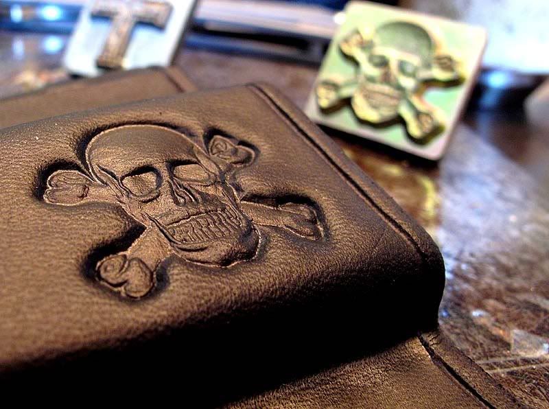

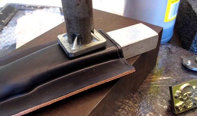

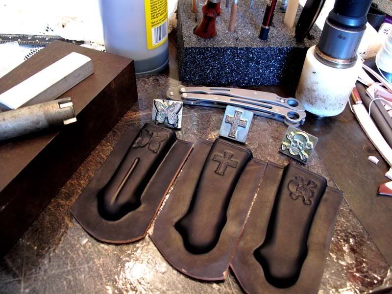

I use a brick size block of steel as a base and then a smaller bits of metal
to use as the anvil that goes under the leather to emboss;
Here you see the block of steel, the top section of the sheath, the embossing
stamp and the handle that sets on top.

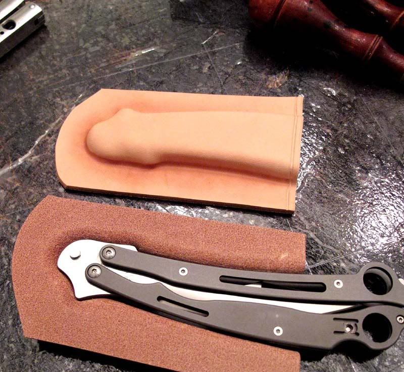

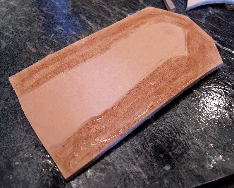

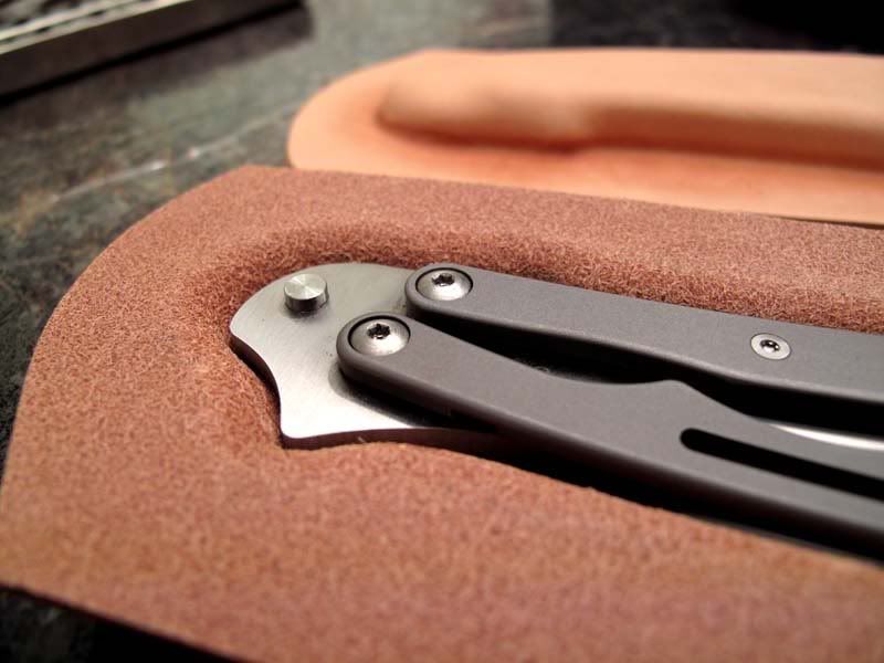

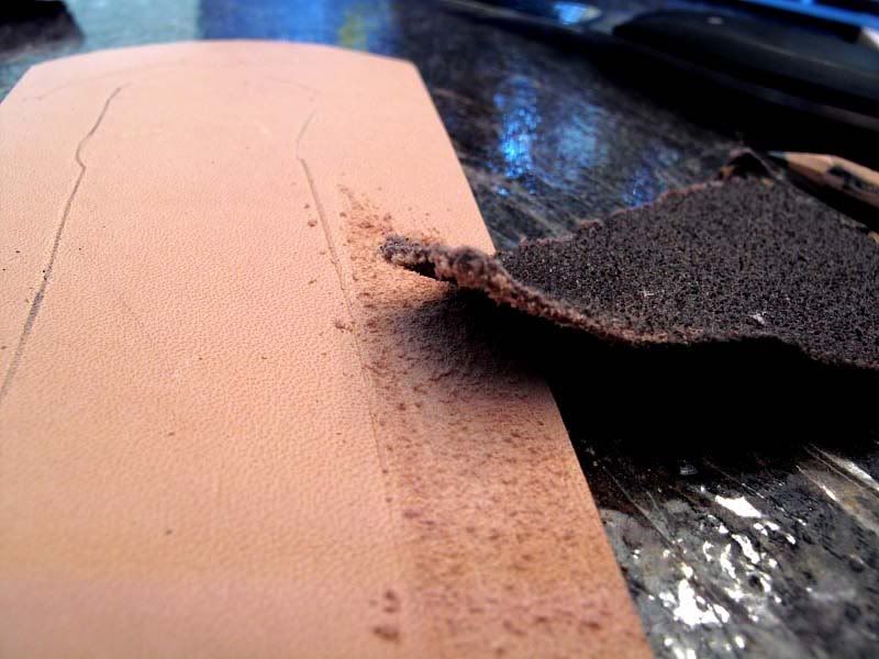

Then I take the top section and knife, lay it on to another piece of leather
Carefully remove the top section without moving the knife and draw around
the knife so I know where I will need to sand and then apply the glue;
very important to rough up the area, otherwise the glue, I use Barge cement,
will not 'set' properly into the leather;
apply to both the base and the top section, allow to dry and then
I set the knife inside the top section and carefully rest it down onto the
base piece and rub around with the bone folder tool to press the two
pieces together.

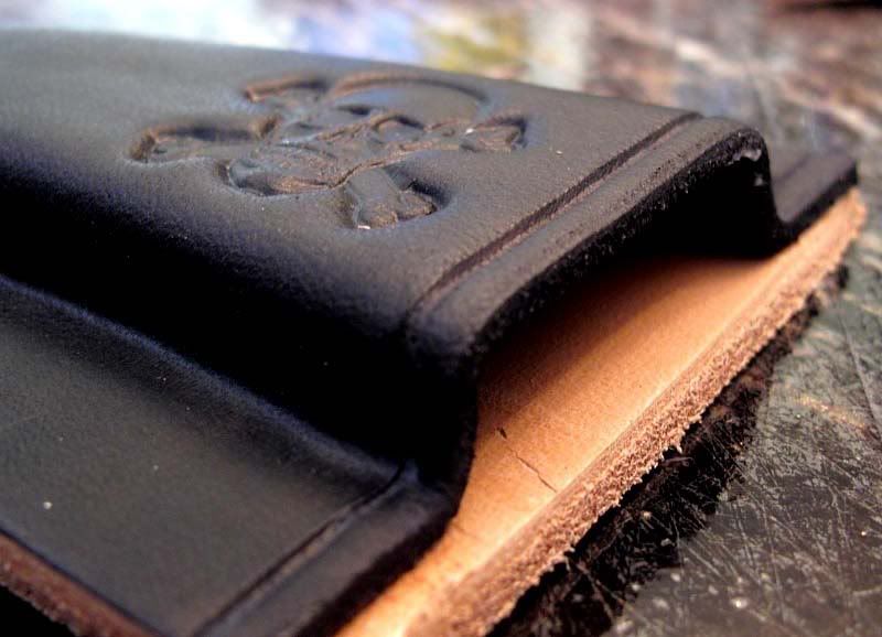

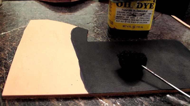

Thanks, a couple of tips that might help others with their embossing
Work on a solid base to help prevent any bouncing
Press down while gripping the handle, also prevents any skipping or double striking
I work the embossing stamp first a hard hit straight down
then I work it to each corner to help set the embossing deep
BUT, becareful not to let the very edge of the stamp mark the
leather, that takes some time to learn, also depends on how tight
grained the leather is you are working with.
after you dye the work, go BACK and strike the embossing a second time, because
when you dye it, the leather will bloom back out a little,
so striking again it will help to make a very crisp embossing...

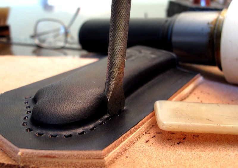

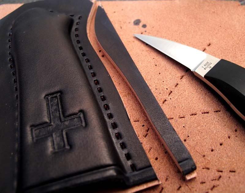

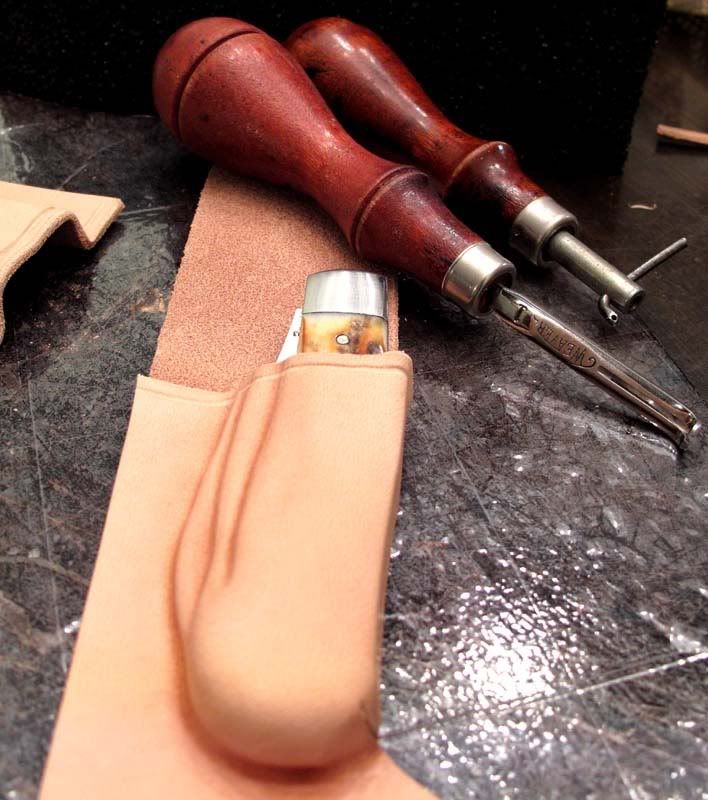

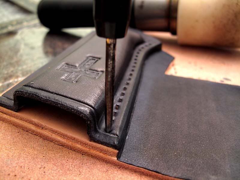

I use a cut down 4 prong, it broke a long time ago and so I use it to 'walk' around
curves when I'm putting the holes in the top section of the sheath;
I've tried the spur wheely thingys but on tight projects like these they often don't
work as well as this method and sometimes those wheely things have a mind of their own
and you over run the track you really wanted, so for me, this works better, sometimes
I will lightly pencil in a line to follow with the stitching prongs just to help me stay on track :)

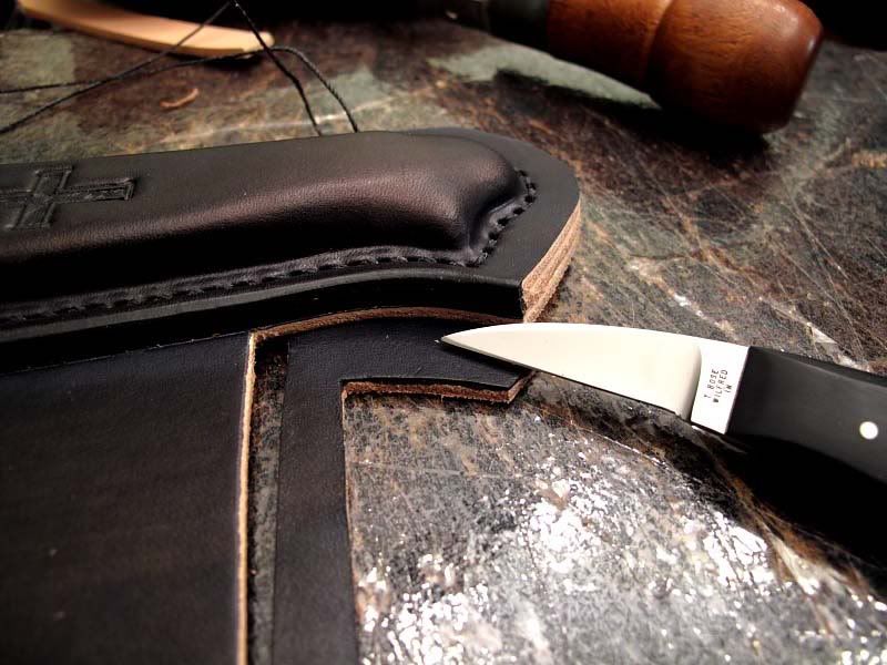

then I cut along the top edge as that is the side that will be glued to the next piece
that forms the belt loop and I can't cut on it once it's glued down, so a close cut here
and then sanded down to a smooth edge
then the third piece of leather will be glued along the full length of the knife sheath
and part of the top will be trimmed narrower to fold over and become the belt loop, here
I had marked the leather and dye just inside the line
same applies here as before, you need to rough up the leather so the glue will adhere
once glued in place, I go around with a makeshift awl ground from and old screwdriver
and punch through the holes, as there are now three layers of leather
then I'll hand sew along the top border and around the end and then trim the piece that
will fold over to become the belt loop

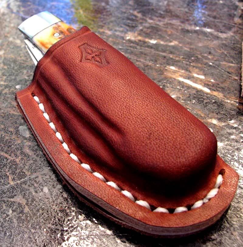

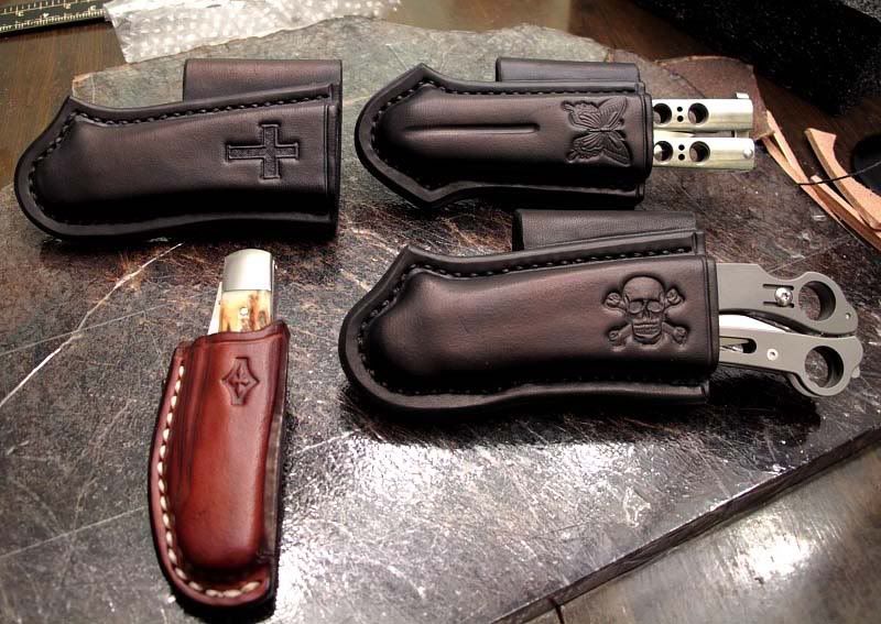

and finally here is a shot about 90% finished, need to smooth the edges on the three
bali sheaths and coat with the wax, the dog leg sheath is done and great snap in retention
due to the shape of the blades, nice knife and now a handy carry, this one is vertical
where the other three are horizontal, the one with the cross will be worn on a wide
belt, 1 3/4" the other two are fitted for 1 1/2" belts.
