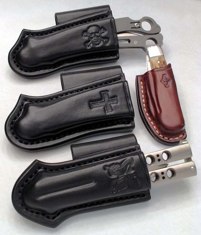

Thanks guys and Rayban, you're not alone I think...
As to leather weight, the top section is 6/7 oz and the second layer
is 7/8 oz as well as the belt loop section, as you can see they
are a little heavier than the top section.
I run HOT water over the leather until it feels pliable and then I use
that bone folder, the plastic rod you see in the images above, to press
TIGHTLY around the knife, as you work from one side to the next, you
must keep the one side you just pressed, in place, otherwise it will pull
the leather as you go to form the otherside, so you are holding down
the work you've formed while you are pressing very hard along the other side.
the white plastic piece on the right hand side is what I use to shape around the knife
the other side is more pointed and thin, I use that to burnish the groove I put at the
opening of the sheaths.
It takes a while to do these, as I will repeatedly work the leather as it goes
through the drying process, about every 1/2 hour or so I'll put the knife back
under the leather and work it again. At the start I wrap the knife with plastic wrap
to prevent moisture from weeping into the knife, later on as the leather is closer to
drying, I'll remove that plastic and work with just the knife beneath the leather.
In this way, I find the leather has a lot of the Give taken out so it will retain it a
bit longer than if you just sewed on a piece and then tried to shape it after the fact
you later end up with a loose pouch that didn't retain it's shape.
This way, you pull, press and make the leather conform and afterwards you have a
nice solidly formed top section.
The vertical sheaths are a different animal, but still similar with shaping, they are more
like leather oragami, one piece wrapped around and over the back for the flap and
hand sewn along the bottom.
Hope that helps, just had to order some more hides today, running out!
I don't order all that often, but when I do, I use Wickett-Craig
they have very consistent quality with their hides!
