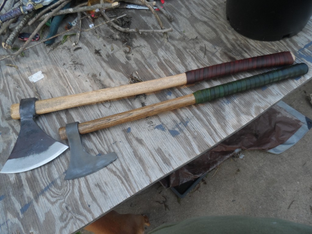

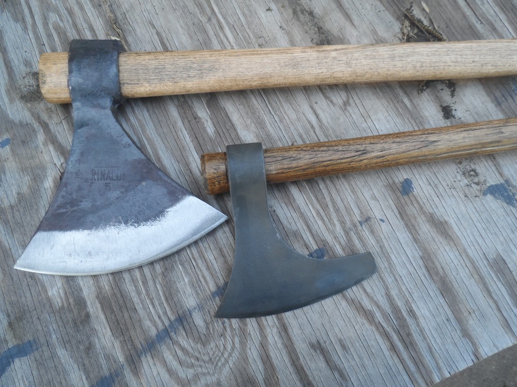

My " Beast " just showed up today, a full 2 days early! GLORIOUS!
all I can say is ....
SO... if anyone doubts if the special grade option is worth 5 bucks... I literally shaved the hair off my arm with this thing, and it makes push cuts on thin paper.......

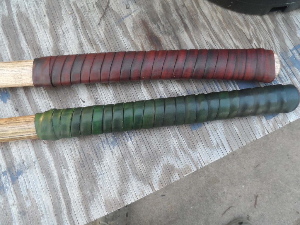

I'm going to sand and walnut stain the handle, then give it a wrap, and it shall be my new Viking axe! ......holy mother of all that's holy....just wow
.....and I cut my knee open while wrapping the handle.... needed 6 stitches. LUCKILY I had some super glue and butterflys and was able to avoid a trip to the ER on Sunday afternoon.....
so ummm.... I feel stupid, but the axe looks GREAT!
Sorry, didn't get any pics of the gore LOL, was a bit preoccupied getting the bleeding to stop.
side note... same stain used on both handles, the Cold Steel is Hickory and took the stain very well, the handle on that Rinaldi though is a VERY tight grained wood.....I had to use 3 coats to get it to do what it did..... it just didn't want to take the stain. Not sure what kind of wood they are using on these, but I'm VERY impressed with it...
Oh my! Sorry to hear about the stitches! The handle on that example was ash, but Rinaldi uses a mix of ash and beech depending on supply. They do have a thin (almost invisible) lacquer on the wood, so you may find it takes stain easier if you sand or scrape that off first. Nice looking wrap!
I sanded it with 600 grit till I got down to bare wood...its just a really tight grained example of...3 coats of walnut, then a finish coat of matte poly.
The green one was my first wrap attempt, I learned a lot on it....the brown one on the Rinaldi I think came out ALOT better.....both feel very good in the hand though.
