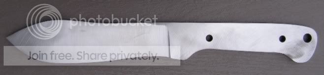

This knife started out as something totaly different than it is now. I started fixing problems and kept making new ones along the way. so my question for ya'll is what do you think of how it looks now and any ideas or suggestions.

Looks like a nice nessie..:thumbup: The 1st pin hole looks like it may be a little low, but that could just be the angle of the photo..
No its not the angle, the First pin dropped a lot from center with the changes tot he blade. Wish I could have seen that coming.
Looks nice, you could always weld the hole closed and drill it higher to center it or JB Weld it.
so drill a centered one just in front of it, a centered one in the middle and a corresponding one at the tail, forget the ones under the scales, nobody will see them anyway

No need for a new hole, just use a diamond or carbide burr and make the hole oval until the top is where you want it. On reason I make my bolt holes 50% oversize is to allow for mis-alignment and changes in the tang during grinding.

Actually, to me the first hole looks a tad to far forward. Just make a new one right behing th first where you want it :)

I tried drilling a new hole. the drill bit just spins with no luck. It was already been to HT so I am thinking I need to undo the HT and not looking foreward to that. also may have to RE-DO the plunge lines they are a bit off from each other.
try putting a clamp of some kind on the knife so it will stand up in a bucket of water - then heat the tang with a torch if you can. MAybe that will soften it up enough to drill. If not - just lengthen the hole with a grinder it of some sort - That sounds easier :)

Larry listen to Stacy on the hole. I have a carbide burr you can use. Dont mess with the HT.
The plunge cuts can easily be corrected on the belt with the help of a file guide.
The overall profile can use some re-fining too but this one has potential to be a fine knife.
Did you draw a plan on paper or just draw on the steel and start cutting and grinding? My daddy always told me; "If you fail to plan, You plan to fail". Be sure to draw out each model and cut it out of cardboard to see how it looks and feels in the hand.

Bruce this was the big knife with the hump on the back that i wasnt exactly happy with how it turned out it looked good on paper and when cut outon the cardboard then the initial cut to the metal. (HHMM again wonder where i learned that HAHA)
but I got the Grind lines messed up got frustrated and tried fixing them there and then and it just seemed to get more interesting as it went. I think this would have been a good example of when you start to mess up step back and look at it for a while before trying to fix it.

If you do end up having to soften a tang I stick the blade in a potato, then use a torch, works like a charm. Except it's a pain in the neck all the way around having to fiddle with it in the first place.

I dont think I am going to remove the heat treat if nothing else I will have a sharp camp knife for myself. I believe I will grind the hole bigger and just be carefull with Pin Setting and use a strong adheasive on the handle. If it aint good it wont go anywhere but to me, I will post pics when it gets done so you can see how it turned out.
