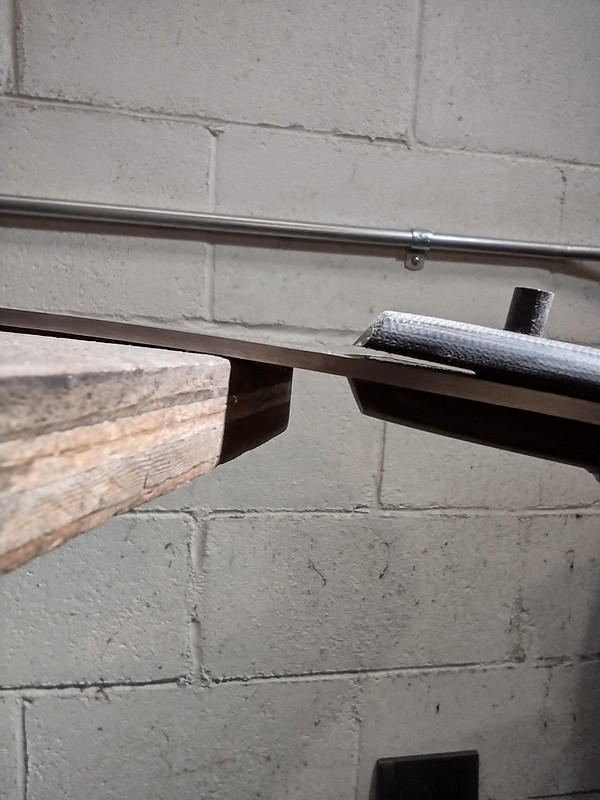

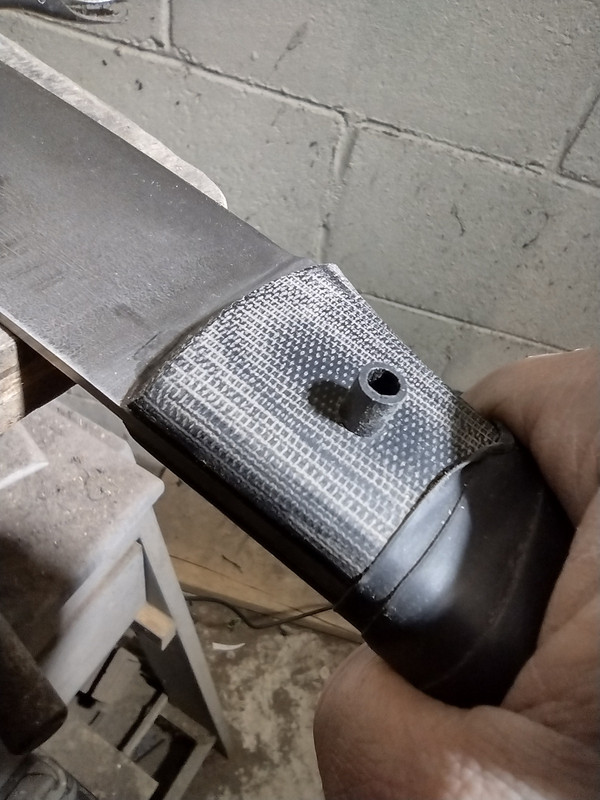

A lot of issues with scales peeling off
Once you have "true" flat you almost need no pressure at all, I also had this problem before at the same place and it is better to leave the pressure off in that area and have a small glue line (if your flatness is off) then to squeeze the epoxy out by overclamping. Also, there is a gluing video by D. Nguyen, he has no pins full tang knives and uses hidden allthread pins to enhance gluing bond.

If you dont have a consistent and full length taper on the transition to the flats of your ricasso you will need to put additional clamping force to bend the scale to the transition area, in turn you squeeze out the glue and the scale bends back once the glue can't hold the opposing force of the bent scale in place anymore. It can be almost non-visible to eye, but g10 is springy and I believe this makes it worse. Happened to me before.

*Not My knife, but flexing it pops the scale.
And to my point on not all stabilization being equal. If you are going to have some movement from a scale you think it's gonna be that tapered front where you can't put a pin, corby or Loveless bolt? Or do you think it's gonna be the center of the scales where his index finger is? Me I'm going with that very thin taper. Heck might have put some heat stress in there just sanding in the taper

The fact that the scales are warped would seem to point to a moisture issue. They might not have gone in the dishwasher but that doesn’t mean they haven’t been in the bottom of the sink while the faucet was running or something like that. They’ll be exposed to more moisture in the kitchen than just about anywhere else. A pin up front would help but I think finding a different source for stabilized wood or using a different handle material altogether would be good idea as well. I find it curious that it’s happening where you’ve ground a taper into the scale. Might be an indication that the stabilizing resin didn’t penetrate that deep.
in terms of technique, one thing that I'm always careful about is to only clamp once. After the epoxy is applied, (to both surfaces) and everything is clamped together, those clamps stay in place- I don't loosen or move them around at all
I had this issue on my early fillet blades. Theye were .070" stock with distal taper. The flexing in fillet work caused the front of the scales to lift. I solved the issue by switching to more pins. I was using three rivets and switched to seven. On at the front and down the sides in pairs. I have since switched to four Corby bolts. Never a problem since.
