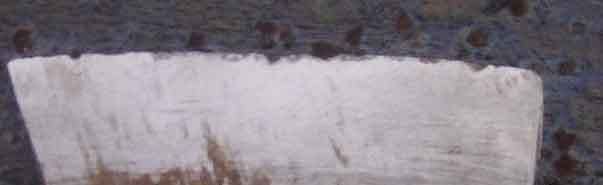

To continue the discussion on performance :
http://www.bladeforums.com/forums/showthread.php?t=492898
How about the expected performance of a 14" Fiskars Hatchet? How much wood should be chopped (1-2 year seasoned spruce, juniper, pine) before the edge just stops shaving? Answer :
Seven hundred sixty four chops. At this point I had to exert enough force and a draw to shave that it was difficult to do without cutting my skin, so I would judge the shaving ability effectively removed. Now of course you would want to repeat this a few times to get a feel for the uncertainty, and of course shaving is fairly subjective, and wood changes, etc.
But, my question remains, if this cheap hatchet, with a production heat treatment on no special steel, not friction forged, not CPM, not even guaranteed to be a tool steel, can make almost a thousand chops into 1-2 year seasoned spruce, birch and juniper, what is reasonable to expect from a "high end" knife/hatchet costing 5-10X as much?
Note this hatchet has been reground (see the review for details) and before this chopping was brought up to a polish of the ultra fine Spyderco benchstone and was push shaving readily, push cut newsprint at 1"+.
-Cliff
