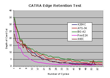

These are CATRA tests done by Buck knives to promote the Edge 2000 sharpening method. Buck reduced the angles from 35-50 degrees included to 26-32 degrees included and switched to a harder sharpening medium and thus removed the convexing of the cloth wheels. This work (2001) showed blades which cut better initially but cut better for longer. The effect of geometry was so significant that a 420HC blade with the flatter and more acute edge outcut both a ATS-34 and BG-42 blade with the older thicker convex edges. Now if you also re-profiled the BG-42/ATS-34 blades they would of course outperform the 420HC blade as shown here :
Now this had been known for years to those active on rec.knives and I had discussed it in detail in many reviews showing how changing the angle and as well the grit had the same effect. This was based on work by Swaim and Talmadge. Swaim had been doing it for years when I entered the discussions (lurking) in 1998. Now as to the model - cutting ability is basically inversely proportional to the force on the blade. Now ignoring friction (which is usually valid for several reasons) the force on a blade due to wedging is just a constant determined by the cross section which doesn't change during the cutting plus the force against the very edge which is essentially the bluntness which I have modeled before. Thus the cutting ability is then :

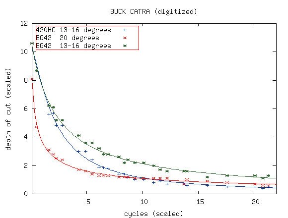

Code:
CA(x)=CA_0/(1+b*x^c)
Where CA(x) is the cutting ability after a given amount of cuts in the test medium (x). CA_0 is the initial cutting ability with no blunting, which is a function of the stiffness of the media and the shape of the blade and initial sharpness. The constants b and c relate how and at what rate the blade blunts. These are the same coefficients as noted in the above linked posts as that part of the equation is of course the equation which I previously used to model sharpness. Ok, now does it work :
Those points are data digitized from the CATRA graphs which is why the axis are scaled (yes I could scale it back, there just isn't any point). The model replicates both early and late stage cutting ability. As noted eariler, Swaim predicted this behavior back in 1998 where he first noted his opposition of greater angles=better edge retention, one of many myths which still persist. I'll be using this model shortly to discuss the hemp cutting and other work I have done. I wanted to use a CATRA model first as it is completely independent data. I will also be using examples of other similar tools, like dental scrapers and such just to show the more general implications. Note I didn't quote the numbers that come out of the model in the above because I didn't have the raw data. I will have all of this for the data I have collected so I'll discuss some of the issues in more detail when I use that.
As a side note, the CATRA curves also show the self-sharpening effect which I first noted in late 1999 during work with Boye blades. The sharpness can decrease then rebound as the edge chips, wears smooth, and this pattern repeats. I had been meaning to look at these curves in more detail for awhile but got distracted with other work. Note in the above I modeled the force in a simple manner :
F_w+F_e
Or force due to wedging (F_w) plus force on the edge (F_e), you can actually break this up and model the force due to wedging in components and thus separate the effect of edge angle and thickness. You can also use this model to do something like compare the edge retention of two blades at different geometries because it is a multi-variable model which includes both geometrical and steel properties. Thus for example you could model the effect of different steels and geometries and thus predict how they would act at different angles or finishes. With a decent spread of steels over different properties (hardness, wear resistance, carbide size) you could also predict the exact properties needed in a steel to give the desired cutting abilities.
Once you have these two coefficients you can also calculate the ratio F_e/F_w which then tells you the fractional dependence of the edge retention on the cutting lifetime. This for example is very high for hemp but very low for soft woods. This shows that you can cut soft wood very well with a blunt blade because most of the force is due to wedging, but trying to cut hemp rope with a dull blade isn't productive. This is why for example makers trying hype blades will do something like cut up a coffee can and then slice wood showing the "superior" edge retention of the knife. In fact because the F_e/F_w ratio is so low for that media the test is nothing but hype. So as a side note, this also lets you quantify hype.

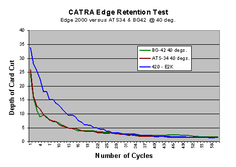

I an understand why Buck took the approach they did, using "Edge 2000" is a strong selling point to the masses. However this doesn't explain the origion of the performance and tends to cause confusion where people make incorrect assumptions about cause/effect. If would have been more informative if they just said "We lowered the edge angles and reduced the curvature so they allow them to cut better for longer." It would have also been really nice to give credit to the people like Swaim and Talmadge who had been advocating this for years on rec.knives, knifeforums and bladeforums. This of course would allow people to realize that all they have to do is reduce the edge angles, it isn't unique to Buck. This is how Swaim, Talmage and Johnston discussed the issues on rec.knives, of course they were not selling anything.
Note how many people still try to sell the misinformation of convex edges being superior or that reducing edge angles decreasing the cutting lifetime in spite of the wealth of information such as the above which shows it to be false and dramatically false. So much so that a thin and flat edge on 420HC knife out cuts a heavy convex BG-42 edge. A steel which many describe as "worthless" out cuts a "premium" high speed stainless because it has a more optimal grind - how many people realize this performance relationship? To Buck's credit, they describe the process in detail on a webpage and they did release public and specific information as to why they switched steels and didn't just make some vague comments like "Our tests showed it to be superior.". Fallkniven, Busse and Spyderco also will release the test data they use to make their decisions.
Note as a further aside the 440C blade is clearly inferior to the 420HC blade even after it is reprofiled. This was explored in detail by Landes and Verhoeven who strongly critize 440C as a knife steel because of the edge instability due to the large and segregated carbides. Johnston made the same point on rec.knives long ago, speciifcally comparing 1095 at 65/66 HRC vs Bos ATS-34 in very thin/acute edges.

What I see is 420HC blade steel holding there own against other more highly (at least on these forums) rated blade steels. So am I correct or am I interpreting the graphs wrong.
No you are correct, that would indeed be one way to interpret the graphs. Consider that at the end of the second graph, which shows both blades reground, the difference between the BG-42 and 420HC blade is only about a cut depth of 2, which is about 5% of the optimal ability. Thus unless you can actually measure this difference by hand, which is unlikely, the blades will be identical in hand.
A lot of it also depends on how easily you can sharpen the steel to high levels. If for example you easily restore the Leek to a blazing level of sharpness but you have to do more work with the S30V/D2 blades and don't always get them as sharp, then this could indeed give the Leek an actual advantage. This is why many people have critized some of the more coarse steels like 440C because they had problems getting them very sharp initially. By this I don't mean cut paper, I mean shave above the skin and similar.

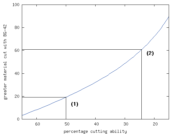

Not in the way CATRA shows the results but that is one of the main problems with their work. What most people would ask about edge retention would be something like "How many cod can I fillet before I have to sharpen the knife?" In order to answer that question from the above CATRA graphs you have to use horizontal intersection asymptotes. That is kind of not overly visually obvious and the answer ends up being often being a nonliner function of the extent of blunting. In short, the graphs are not overly useful because of the way they present the data. However consider the following :
The x-axis on this graph is the reduction in cutting ability of the knives and the y-axis shows how much more material the BG-42 blade can cut over the 420HC blade before both reach that same level of degredation. When the blades are cutting about half of optimal, point (1), the BG-42 blade will have cut about 20% more material - not overly impressive. However, when the blades are used down to about 25% of optimal, point (2), the BG-42 blade will have cut over 60% more material.
So if you like to keep your blades very sharp and they are always cutting very close to optimal, that CATRA data doesn't show much of an advantage to BG-42. Since BG-42 it also more expensive and 420HC is tougher, more ductile, easier to grind and more corrosion resistant - it seems obvious that 420HC is the clear winner. However if you are willing to use your blades to very blunt states then BG-42 will have a large advantage.
This is one of the many reasons why there is often so much contention between people when they talk about edge retention. There are also many other issues such as some steels are easier to sharpen and if you don't get a steel optimally sharp the edge retention will be horrible even if it has ideal characteristics to cut a type of material. Then there are issues like what happens if you keep decreasing the angle, or what happens if you harden both blades to near maximum hardnes?
