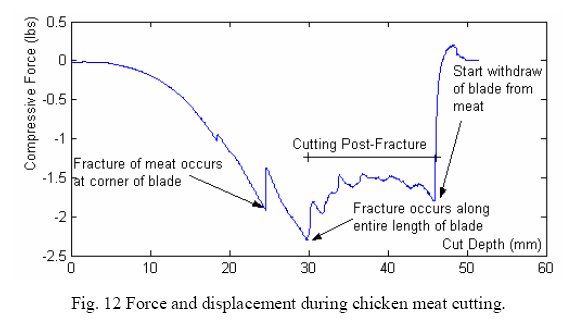

First, this data is not data at constant force, which is what Cliff has proposed for modeling cutting performance. It's data at constant push cutting velocity.
Second, this data shows the effect of what Cliff calls F_w. There is a cutting force required to shear the fibers, and a frictional/wedging force required to move the cut material out of the way. The linear increase is due to the increased width of the blade as you get farther back from the cutting edge. The constant force is caused by the blade being fully engaged. Once the blade is fully engaged, the force is no longer proportional to depth of cut.
Further, as you carefully read this paper, the paper is not about edge geometry, but about "wedge geometry" It's looking at how the gross geometry of the blade affects cutting forces, not about how the edge geometry affects cutting forces. I agree that both edge geometry and blade geometry have an effect on cutting forces, particularly in rigid media. But what I term sharpness is dependent only on edge geometry. You can see this because there is no gross geometry difference between a sharp and a dull knife blade. When you sharpen a knife (as opposed to reprofiling a blade), you only modify the edge geometry.
Doing a cross cut in the middle of a block of wood is probably among the most extreme examples of cases where blade geometry, rather than edge geometry, dominates the forces. In CATRA ERT testing, there are two mechanisms that cause the wedging force to be close to zero. First, the media is sheet media, so immediately upon cutting through a thin sheet, the media falls away. This minimizes the wedging force on the cut end. Secondly, the blade is free to move away from the stack of media, which minimizes the wedging force on the uncut end.
In the rope cut testing DiamondBlade did, the blade was free to move laterally to minimize wedging force. Further, the rope was free to move away from the edge one fiber at a time, so the wedging force was very small.
For more flexible media, like meat and skin (which are more relevant for hunting knife usage), the data shows up differently. The image below, of cutting force in chicken breast, comes from Zhou, D., Claffee, M., Lee, K., and McMurray, G., "Cutting,'by Pressing and Slicing', Applied to the Robotic Cut of Bio-materials, Part II: Force during Slicing and Pressing Cuts", Proceedings of the 2006 IEEE International Conference on Robotics and Automation , 2256-2261. In this image, the forces are compressive, and so are negative. Therefore, high forces show up at the bottom of the graph. As the blade is pushed into the meat the force rises, until the meat fractures. The force then stays constant until the blade leaves the meat. The paper describes in detail how the fracture force varies with edge geometry. CATRA REST values behave very similar to the plot in this paper, and have been demonstrated to increase as blades dull. Therefore, I believe that CATRA REST values are a much better indicator of blade sharpness than is total cutting force in a rigid material.
For a non-rigid material, I have yet to see any data that says cutting depth is determined by cutting force.
Carl

Cliff,
Perhaps its because you are trying to talk to people who don't have PhD's in physics. Perhaps it's because you want to have one model that applies to every situation. I really don't know the reason, and I shouldn't speculate because I don't know; and it's not really relevant.
But your explanations on this topic are imprecise. You draw no distinction between rigid media and non-rigid media. You don't put units on your terms. You assume an inverse relationship without any proof. And you justify it all by saying "it fits the data".
I don't mind if you say you have an empirical relationship that fits the data. But to claim you have a physics-based model, when you have the same model regardless of the cut measurement, seems to me to be dramatically overstretching things.
As a physicist, I think you're aware of dimensional analysis. None of your equations have units, and if you put units on them, I think you'd find that there were constants missing, and the constants would have different units for different cases, and none of them would seem to make physical sense.
As an example of what I believe to be oversimplification, you refer to the CATRA test by saying the work done by the knife in cutting is proportional to the amount of media cut. Then you imply that the work done by the knife is equal to the normal force times the distance cut. That's true in push cutting, but not in slicing. The work done in slicing is equal to the normal force times the distance cut, PLUS the slicing force times the distance sliced. And I'm sure the slicing force is _not_ constant, because I've looked at the edge geometry.
If your model doesn't account for the slicing force as well as the normal force, it's missing part of the work. And to just hand wave it away works fine, if you only want an empirical model. But if you want a physics-based model (which you claim you have), you need to include _all_ of the phenomena, then explicitly which phenomena you assume to be unimportant.
Here are some references of people who have made physics-based models of cutting and/or measured forces involved in cutting. All of them are more careful than your model. None of them claims to be as comprehensive as your model. All of them provide careful data that shows how well their model fits. And, as far as I can see, none of their models simplify to your model, although they have key aspects related to your model.
Marsot, J, Claudon, L. and Jacqmin, M, "Assessment of knife sharpness my means of a cutting force measuring system", Applied Ergonomics 38 (2007), pp. 83-39.
Dowgiallo, A, "Cutting force of fibrous materials", Journal of food Engineering 66(2005), pp. 57-61.
D. Zhou, M. Claffee, K.-M. Lee and G. McMurray, "Cutting, ‘by Pressing
and Slicing’, Applied to the Robotic Cut of Bio-materials, Part I: Modeling of Stress Distribution", Proceedings of the IEEE
(ICRA06), Orlando,
FL, May 2006, pp. 2896-2901.
and Slicing’, Applied to the Robotic Cut of Bio-materials, Part II: Force
during Slicing and Pressing Cuts", Proceedings of the IEEE
(ICRA06), Orlando,
FL, May 2006, pp. 2256-2261.
McGorry, R.W., Dowd, P.C., and Dempsey, P.G., "The effect of blade finish and blade edge angle on forces used in meat cutting operations", Applied Ergonomics 36 (2005), 71-77.
McGorry, R.W., Dowd, P.C., and Dempsey, P.G., "Cutting moments and grip forces in meat cutting operations and the effect of knife sharpness", Applied Ergonomics 34 (2003), 375-382.
Atkins, A.G., Xu, X., and Jeronimids, G., "Cutting, by 'pressing and slicing,' of thin floppy slices of materials illustrated by experiments on cheddar cheese and salami", Journal of Materials Science 39(2004), pp. 2761-2766.
I have pdf copies of these articles, and would be happy to email them to you. Copyright laws prohibit me from posting them.
I don't think your model is without merit. I do think it's not carefully done, and that it would be much more persuasive if you'd work it over carefully and provide some data that shows both where it matches and where it doesn't (because no model is perfect).
Please don't take this as a personal attack. I'm glad to see that you are putting out ideas about testing and edge retention. I'd just be much more convinced if your work were a little bit more detailed and carefully presented. When work is presented in detail, then it can be critically evaluated. When work is presented in broad generalities, it can only be broadly criticized, which often appears to be in the form of personal attacks.
