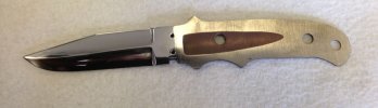

Now it's time for installing the guard - prior to assembly everything has to be hospital clean with acetone to get a good solder joint. The pins are peened and pressed with a six ton press. Since this guard is 3/16" thick with 1/16" pins, I can get away without tapering the holes in the guard. When I use 3/32" and 1/8" pins in thicker guards, I taper the holes to eliminate the dreaded circle around the pin that you'll get if you don't taper the holes.
Earlier I said I leave the guard about .025" proud above the spine - this proud area is then peened to get a frog's ass tight seam where the guard is exposed along the sides of the tang after the spine is finished. I use the same method for my subhilts too.
Solder time! Here's what I use to solder: cap full of Stay Clean liquid flux with the main bottle set aside where I won't knock it over :grumpy:, two 1/8" sections of solder cleaned with acetone, one 1/16" stainless rod to work the molten flux cleaned with acetone, tweezer to place the flux along the joint, and a 1/8" nickel silver rod placed in a scribe holder. A 45 degree bevel is ground on the rod to machine the solder joint after it sets up.....Charles Vestal taught me this. My buddy Schuyler Lovestrand uses a square brass bar to machine his solder joints - I prefer a more radiused look so I use the 1/8" nickel silver rod - brass works too but the burr doesn't last as long as nickel silver.
The 1/16" stainless rod is dipped in the flux and a bead of flux is placed along the solder joint - then the solder is placed on both sides with the tweezers. If I'm sloppy with the flux, I have more solder to clean off. I heat under the guard with my propane torch until the solder just begins to melt - by dipping the stainless rod in flux, I'll use it to pull the molten solder all the way around the knife/guard joint. Finally, I'll work the whole molten joint with the stainless rod to remove any pin-holes. Here's the as-soldered joint just prior to machining it with my nickel silver rod:
After radiusing the solder joint with the nickel silver rod - I'll buff the solder joint in an 1800 rpm buffer using black hard cut on a narrow spiral sewn wheel.
Here's the finished solder joint - I like a nicely executed solder joint - to me it just shouts QUALITY. Then the whole knife is boiled in a secret recipe of Dawn and Baking Soda to neutralize the flux acid. This is a proprietary recipe that I have a patent on. :D
