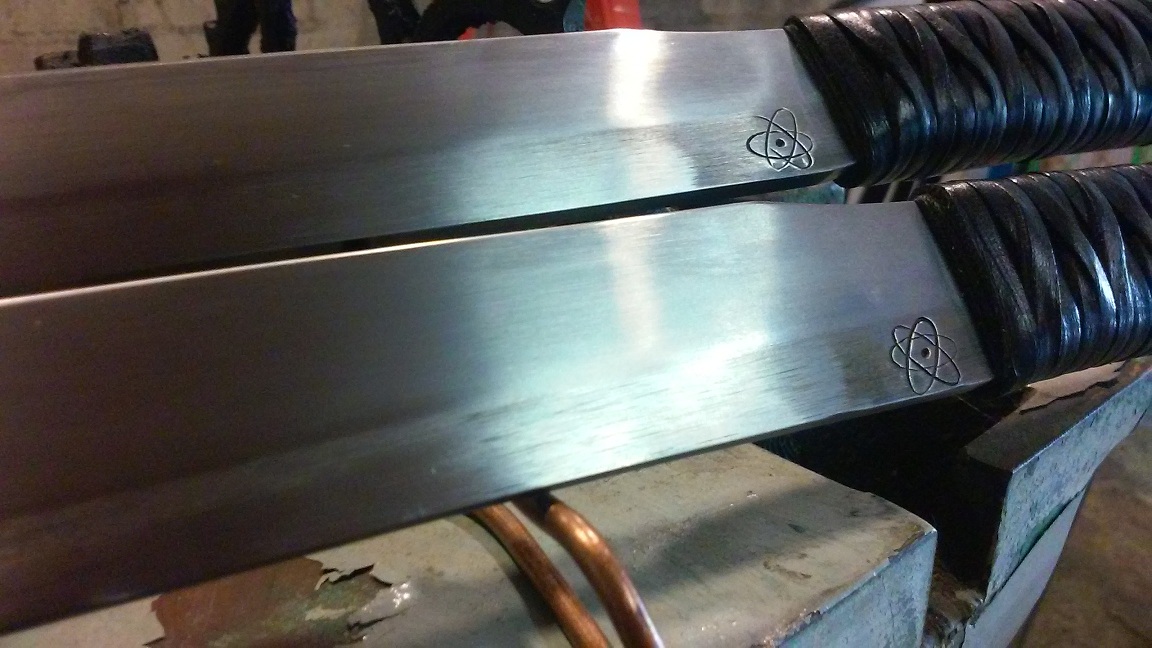

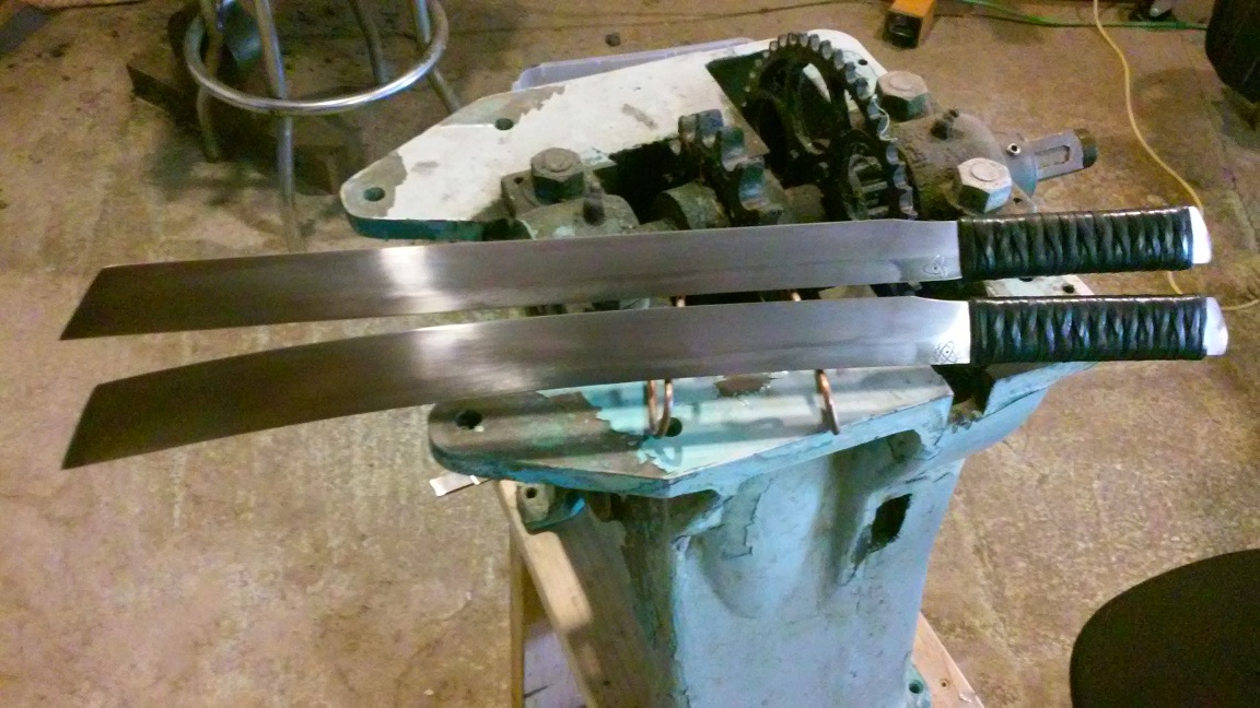

Hello everyone,
Here is a set of two complimentary machetes, made from beta metastable titanium alloy (beta ti). They are forged out of beta ti bar stock, before grinding and heat-treatment, and are distally tapered.
Both of these blades are just a bit over 21" in length, and are quite a bit more thick on the spine than I usually make them, with with tips that are fairly blunt, but still sharp. They are made to order, and reflect a request for an all-purpose woods tool that can be used not just for cutting, but for prying, digging, etc.

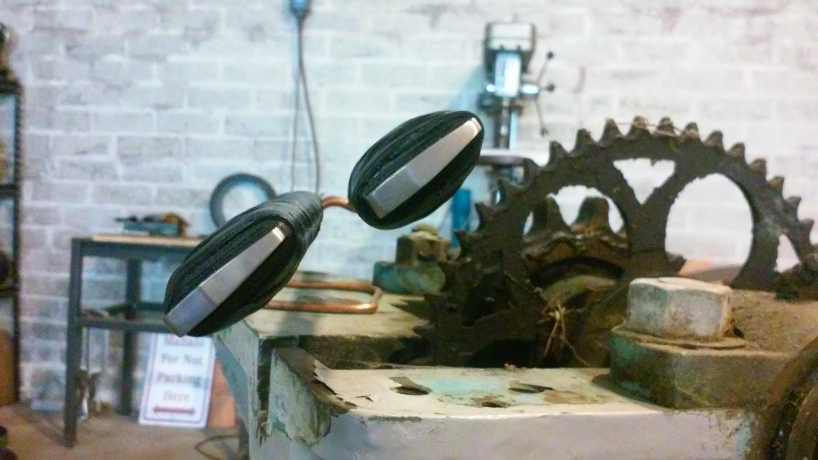

With these machetes, I attempted to grind the blade bevel all the way through to the end of the tang, as it's done on Japanese swords; notice there is no plunge. There are several reasons it seems to be the way to go...
Call it katana practice. :D

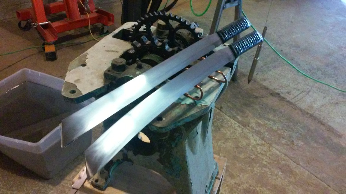

One almost straight, the other curved:
Usually I taper them down to a fine thickness at the tip, but these are more robust.
The straight chopper is a bit thicker than the curved cutter.

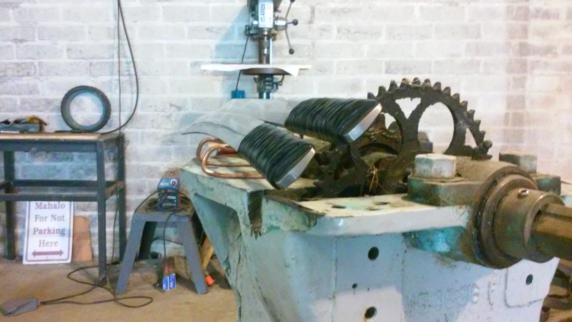

Here you can see how the blade bevel follows through the tang, although the thickness does flare out from tip to the very end. The entire thing is distally tapered.

It's hard to see, but the straight one is slightly curved as well.
Wow that's extremely unique! I gotta ask how many belts these ate up to grind though haha fantastic work!!
Thanks fellas. :]
Aye ya, this stuff is not kind to grinding belts, or even the grinder itself when the dust and chips ignite which is regular. It's a straight-up complete waste of time to use anything but a quality ceramic grinding belt, which won't last long anyway. Bora 7 belts also work well.
The billet will grab ahold of the grit and tear it to shreds. Stone grinding wheels? Reduced to powder. Silicon carbide? Don't believe it, they stink and are destroyed instantly. Obliterated. Zirconia? It just skates until you apply huge pressure, and then the belts get ruined. Aluminum oxide? Useless.
Ceramic all day. However, the finer the grit, the less it matters.
They are actually easier to grind after Ht, at least, that's what I found. Less sparks, and less gummy.
