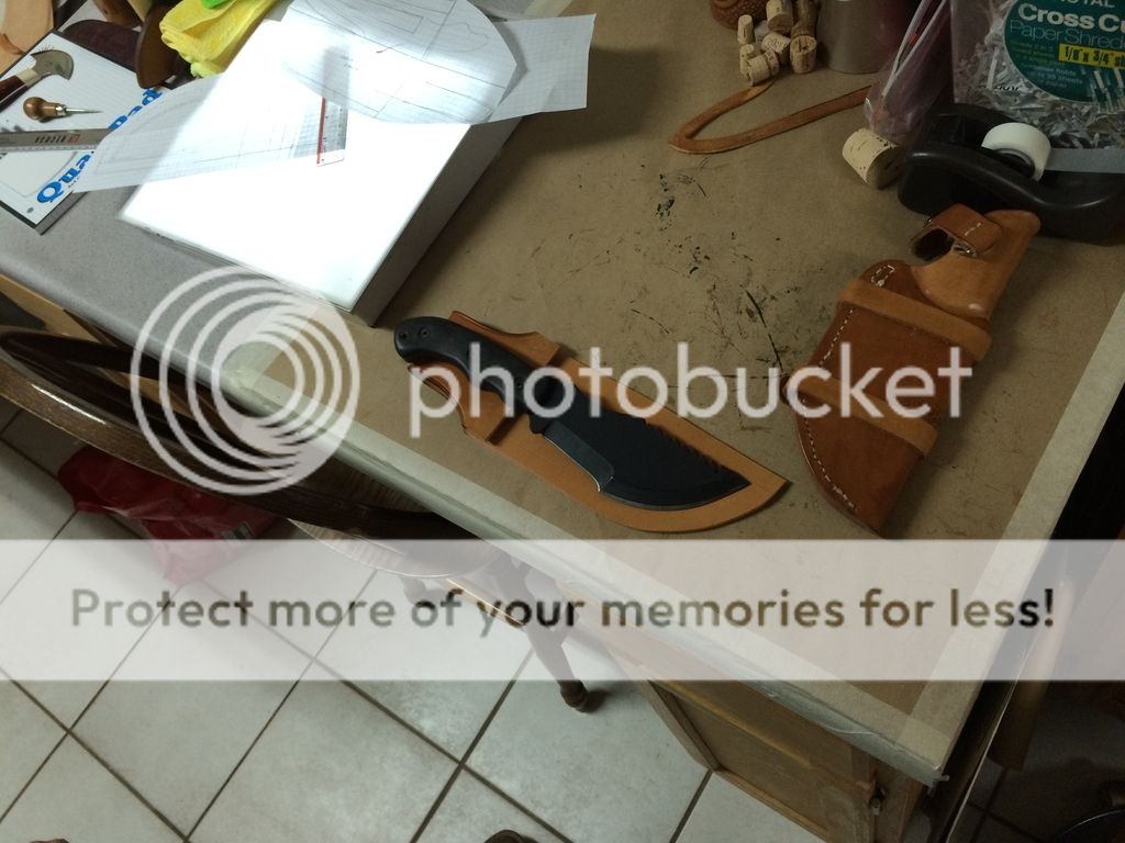

At this point I’ll mention the Tracker is not an easy knife to sheath. It’s like trying to sheath a chainsaw. Every part of the blade from the quarter-round to the saw back is as rough on a sheath as it is on a piece of wood. Mr. Long evaluated and accounted for this factor without skipping a beat. I had brought along a notepad, but it was useless. He worked so fast, you didn’t want to look away for a second because you’d miss a step.

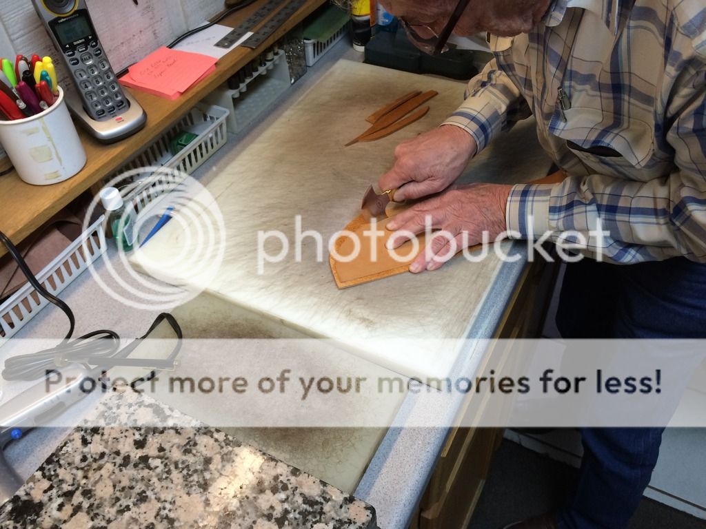

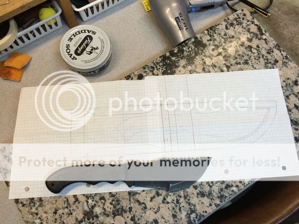

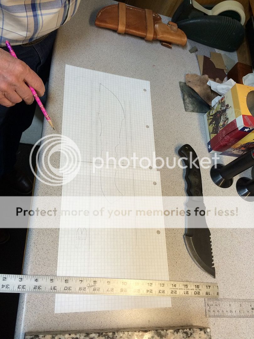

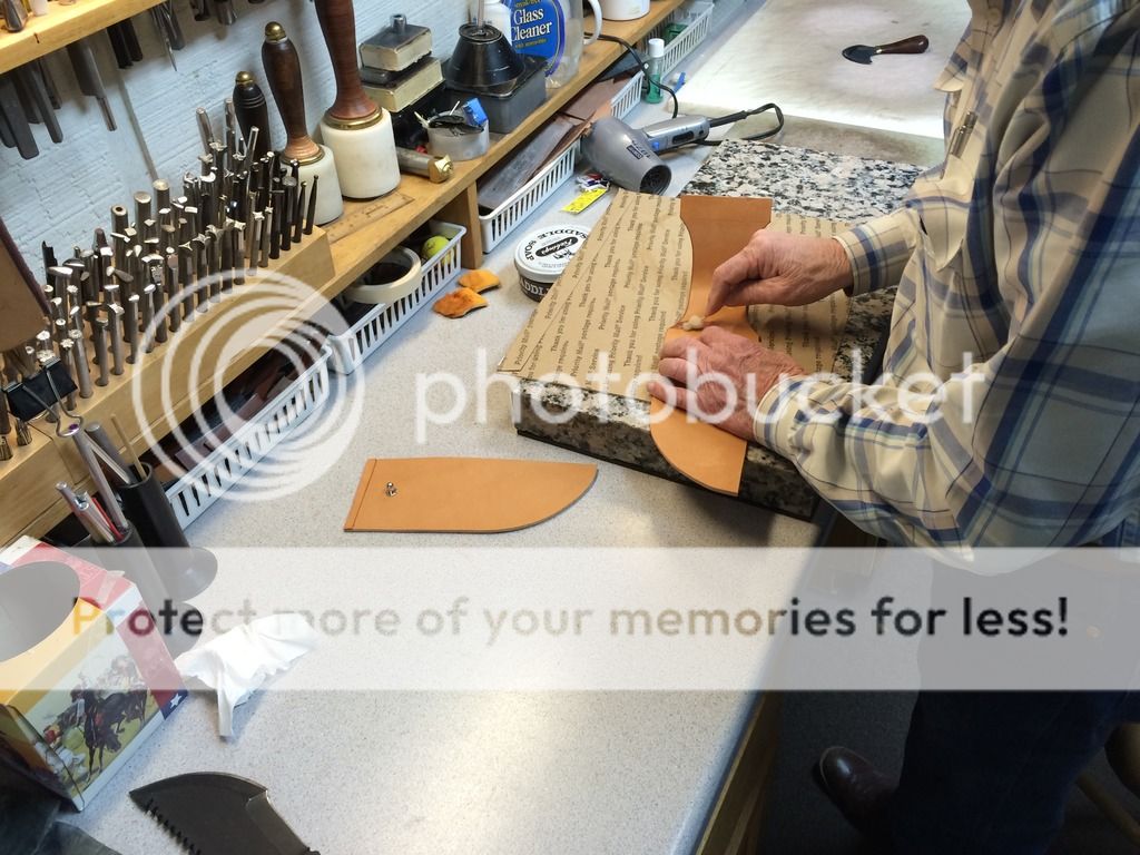

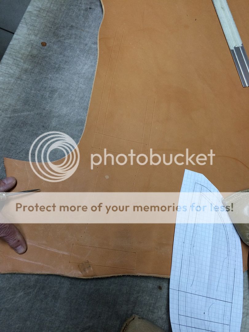

We began with the pattern. He continually stressed the importance of the paper pattern and advised that he was so confident in the pattern we would create, that he guaranteed a perfect fit without inserting the knife in the sheath until it was finished. At my skill level, that is impossible. He carefully traced the knife, we decided on what sort of belt loop we wanted and how deep the knife would set. He repeatedly made dots on the graph paper, brought out the ruler for lines, and went to his lighted board. Then, he would erase a line or dot and re-check where it belonged. Every step of the way he used multiple, often three, reference points to ensure every part would fit.

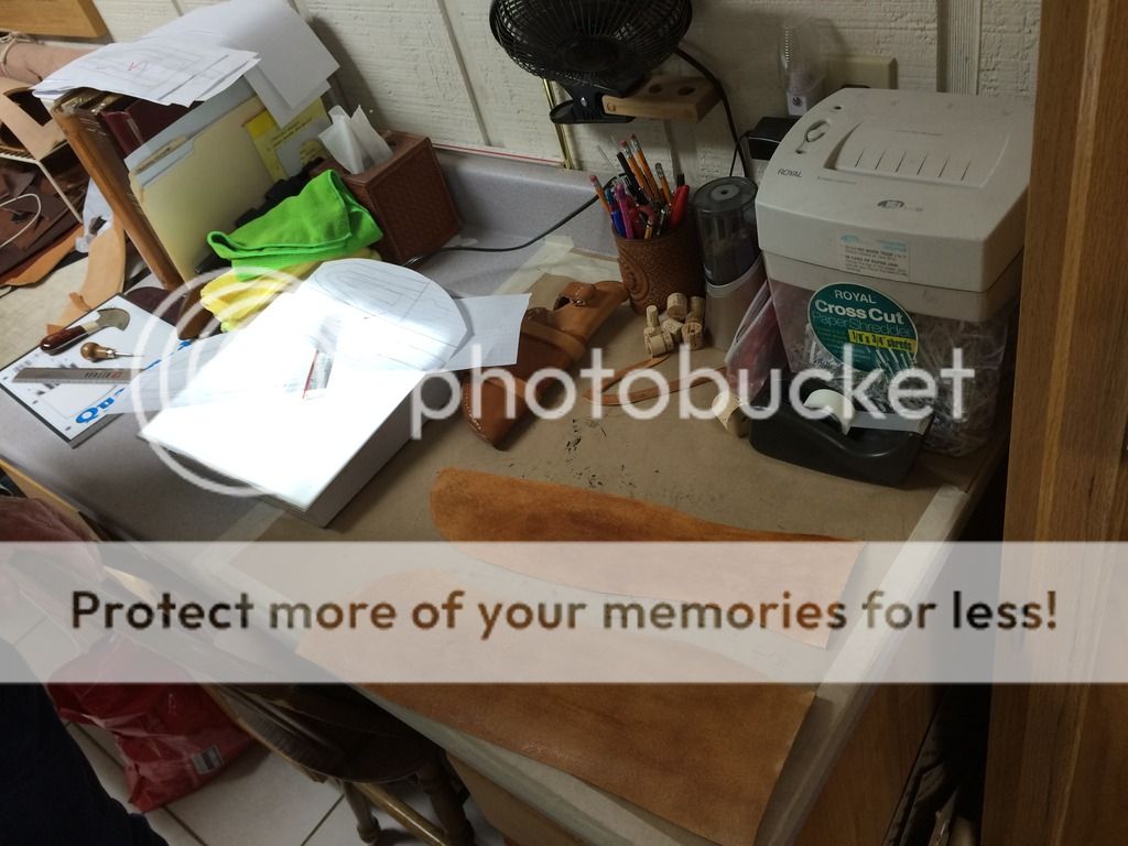

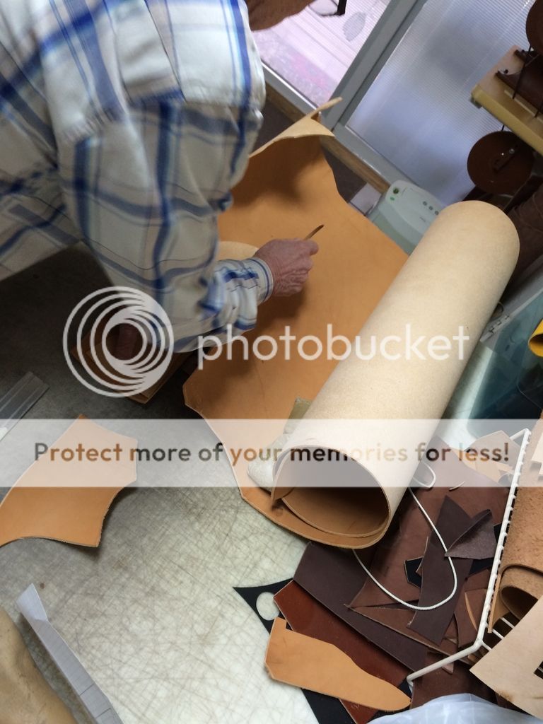

Once finished with the pattern, he brought out the leather. He explained what parts could be used for the liner and which need to be used for the outside. We had earlier decided on a simple and sturdy veg. tanned liner. He often uses deer skin as well, but for our purposes and for this knife, cow hide was perfect. He laid the pattern out and used an awl to make reference points. He explained how that allowed him to cut without destroying his pattern. I would’ve never thought of this, but it worked perfectly. Again the ruler and awl came out and before I knew it, he snatched one of his dozen or so custom round knives and was carving out perfectly shaped pieces of leather. During every step he emphasized the “what” and “why” of everything he did. Including using a round knife instead of the utility knife I use (which he got a kick out of!) There was no doubt I was watching a master work even at this early stage. I could compare it to an assistant fry cook watching Julia Childs.

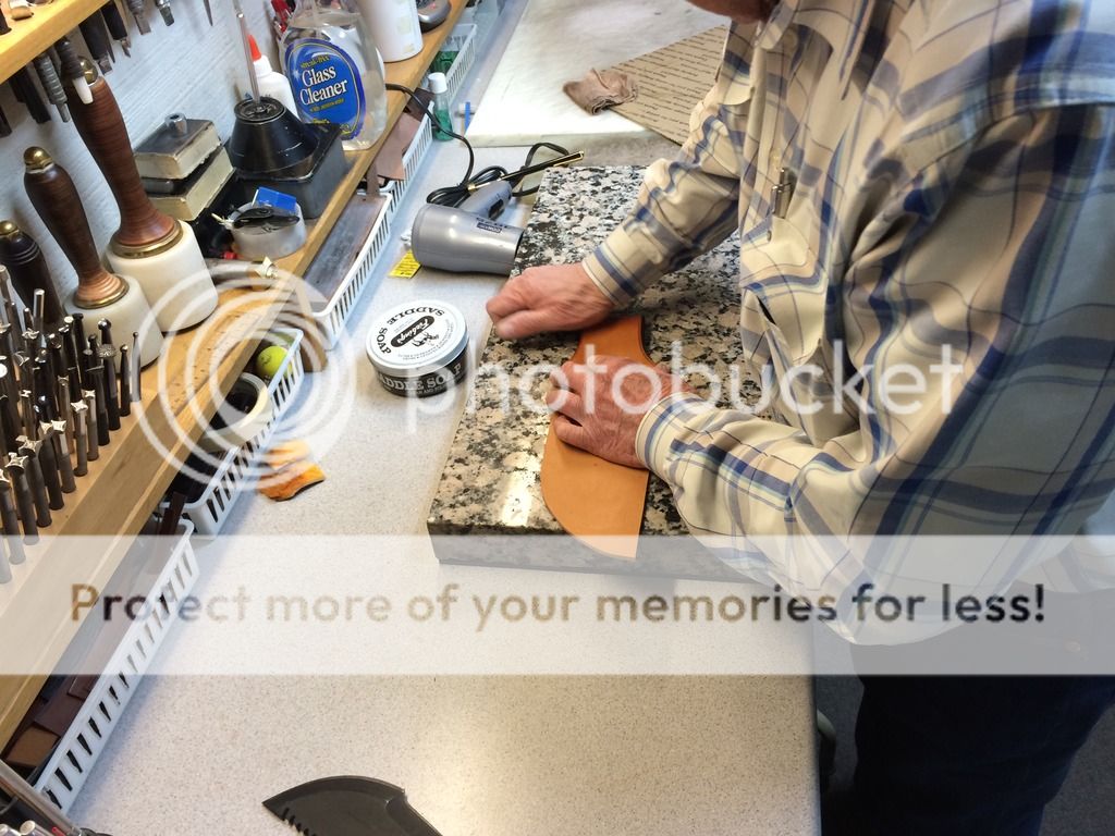

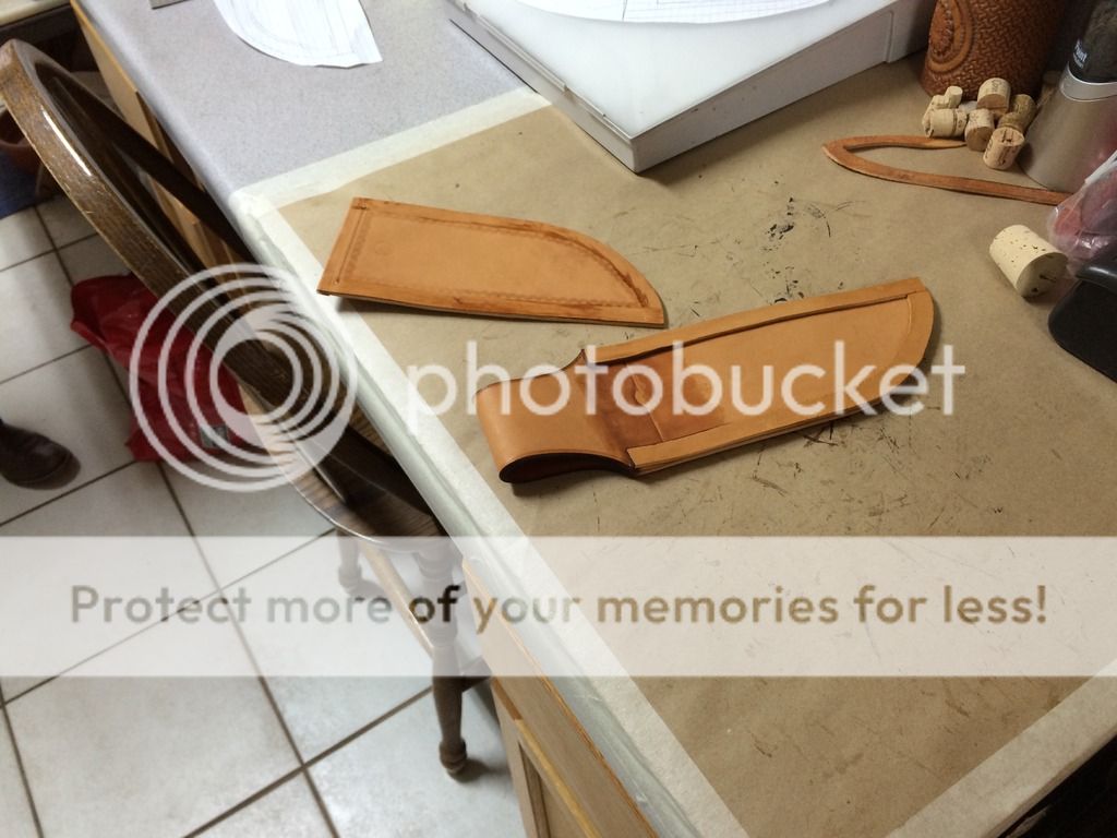

Once the pieces had been trimmed up, he immediately began applying Barge Cement to multiple pieces, explaining how many coats he used and why. He’d then take two steps and have the pieces drying under a small fan. In the blink of an eye, he’d be on another job. Of interest is that he uses three coats of cement, with dryings in between on almost every piece of leather which connects to another piece. He also hammers the pieces together, removing any possible pockets and really creating a single piece from many. At first this seemed way overboard, but will result in a sheath likely able to stay together without even any stitching. It also results in what would seem a total moisture barrier between the outside and inner layers. This is genius IMHO. He essentially created a leather laminate offering unseen protection against rain and sweat.
A little more trimming.
Mr. Long prefers the belt loop to fold outward, away from the body toward the knife. This makes for a nice, clean sheath back. Every part touching the wearer’s side is smooth. It also adds a bit of elegance. I’ll add that at every step of the process, Mr. Long adds a touch of this elegance to his work. Also, as he works with individual pieces, he does small things like finish the edges, or oil the sheath mouth during construction. He explained it’s quicker and easier to do small things like that before the sheath is put together. Having done it the other way, I’ll add that the small details which really make a sheath “pop” are sometimes impossible to do (or do correctly) at the completion stage. Here, he is folding the loop to make a crease, after wetting the fold.

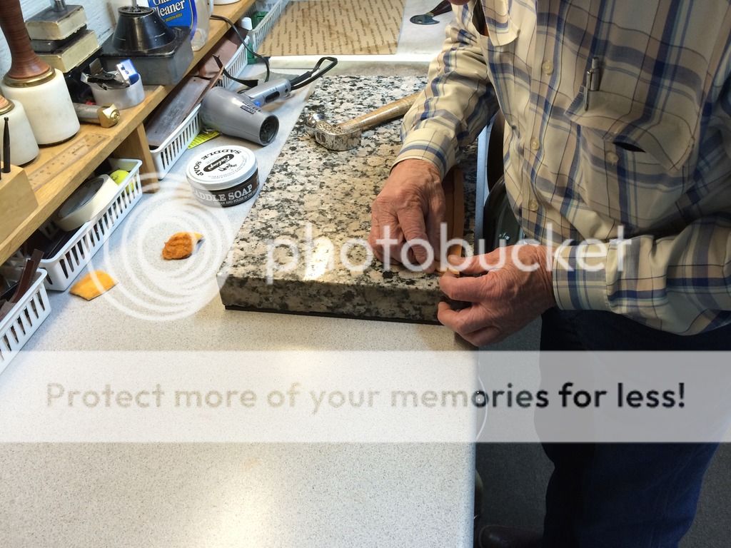

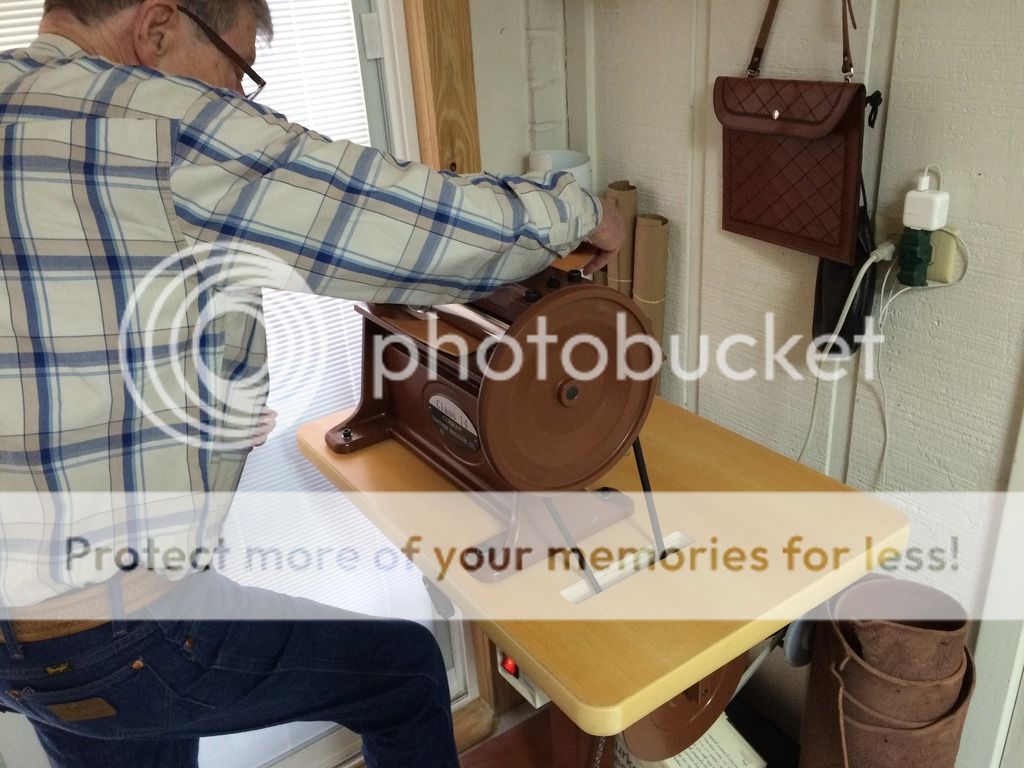

The liners get a pass through the splitter, keeping and using only a thin piece of the top grain, which he stretches tightly. Mr. Long makes his sheaths svelte and trim, not only making them stylish, but making even a large knife sheath appropriate for “sash” carry, of which he is a fan.
The fold-over liner gets stitched, post cementing.

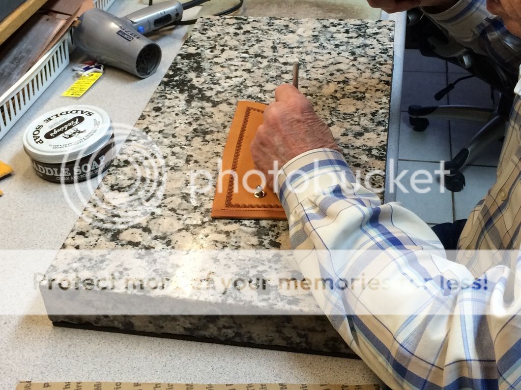

A stud was added for sash carry and to offer several simple and temporary retention options, if desired. Though with this depth and fit, one would have to be doing gymnastics or fall down a mountain to need extra retention, but the option is there and that’s nice. Here, a stitch is given to the top of the front piece.

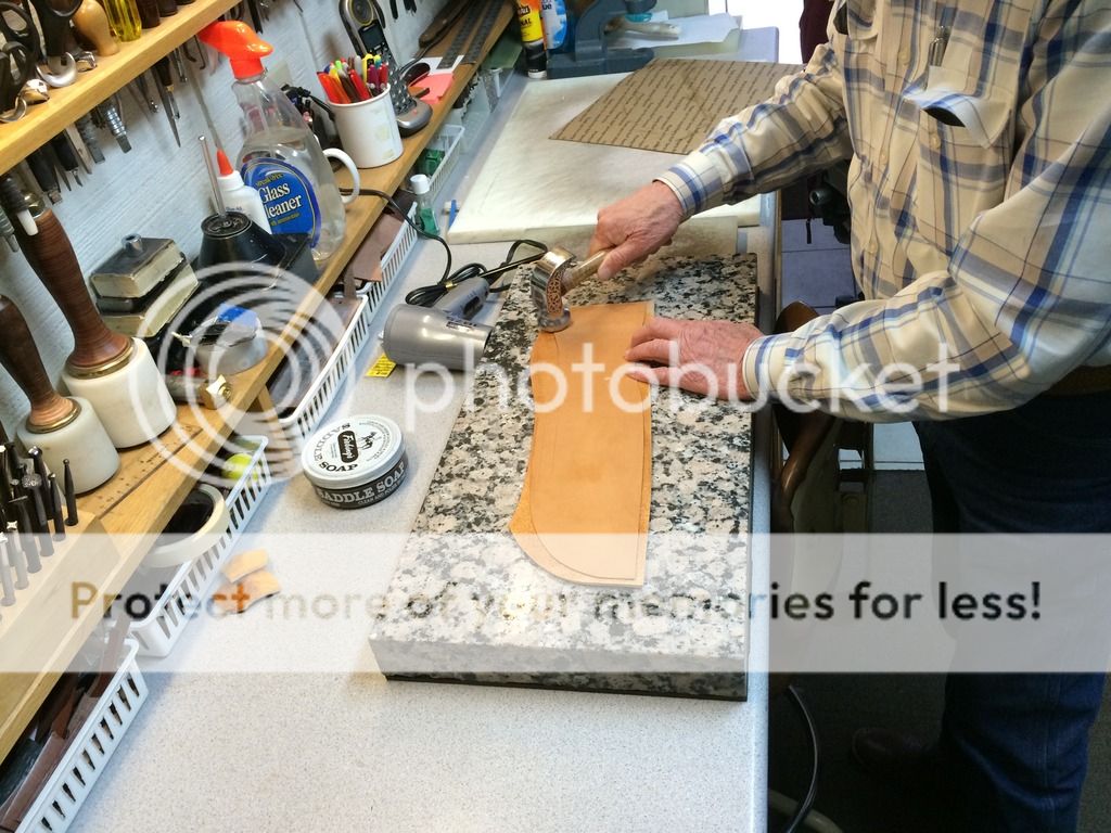

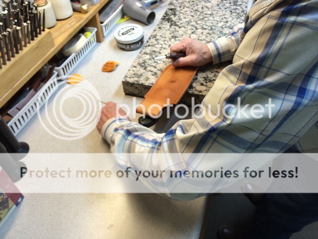

Mr. Long didn’t wish to send me out the door with a plain sheath, so he first used a swivel knife to cut a decorative border. Next, he boned the cut, with a piece of real bone no less! He then applied a simple border stamp, adding unassuming elegance. This sheath would be a home at a mountain man rendezvous, a Tracker Pack get together, or a Sunday afternoon BBQ. I asked why he cut a decorative line, since we already had a shallow groove to use as a guide. His reply was “a picture is worth a thousand words”. He grabbed a piece of scrap and demonstrated what it would look like without a cut. The stamping was not quite as strait and didn’t set as deep. I was beginning to see what makes a Paul Long sheath a Paul Long sheath.

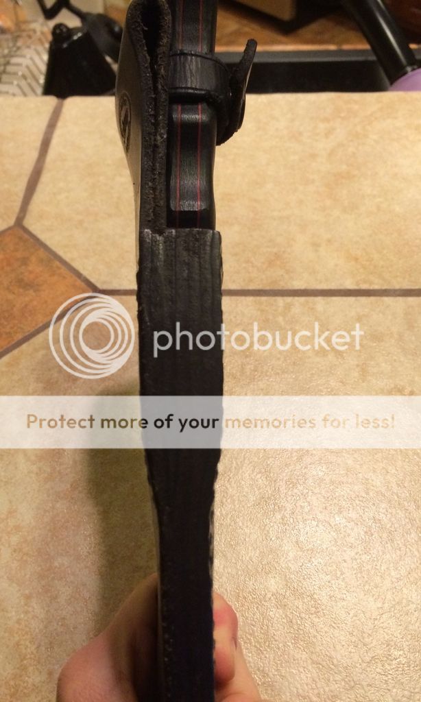

The welt, after numerous coats of cement, is cemented onto the sheath body. Note the single, thin welt. There are many opinions on the proper welt. Thick or thin, single or multiple. All I can say is the end result of this welt design was a perfectly fitting sheath, not much thicker than the knife itself. Having used other methods, I believe I’m a convert to his style. The results were too functional and beautiful to question.

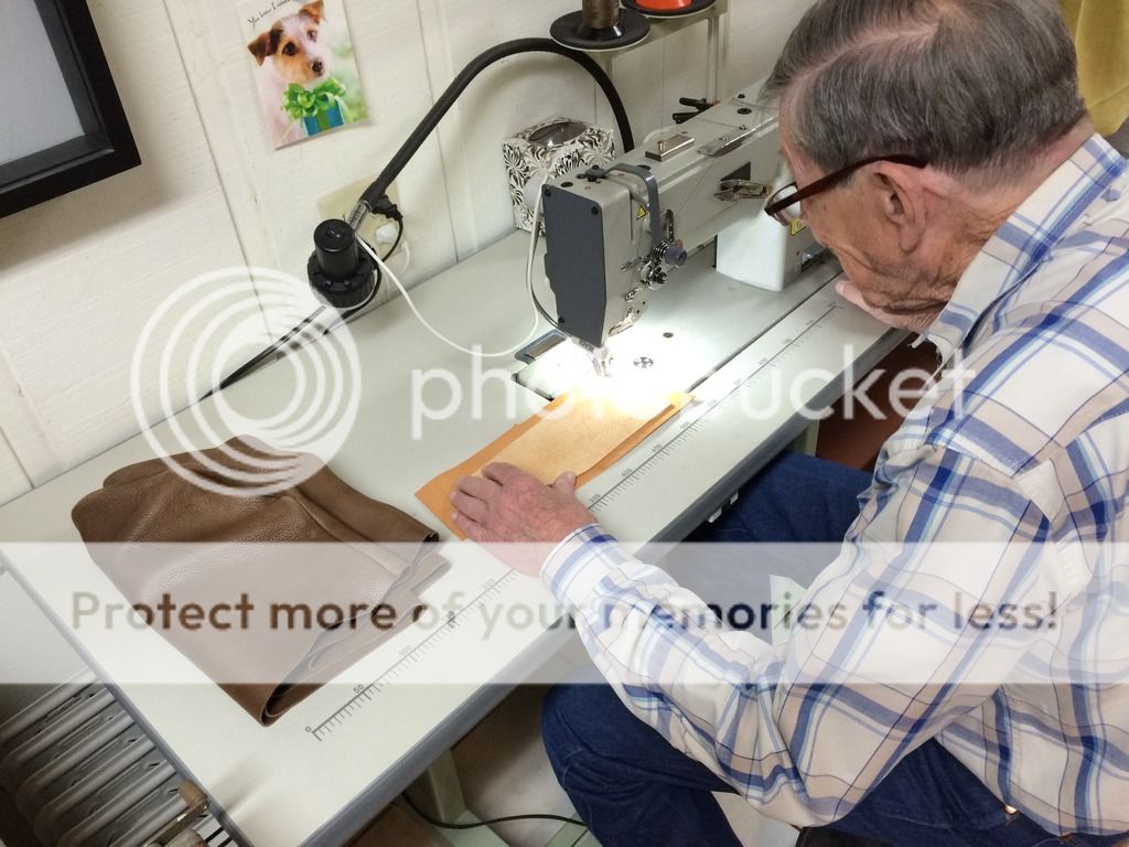

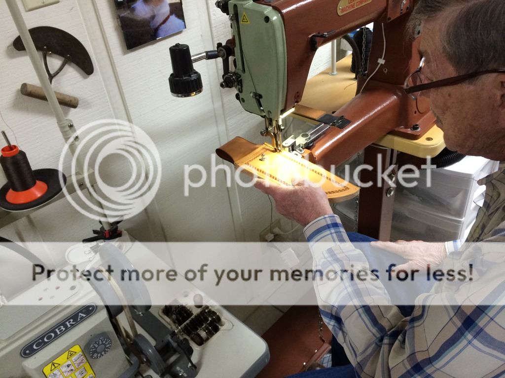

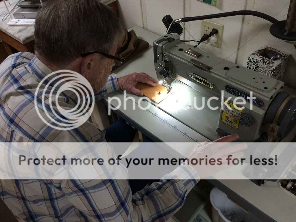

Mr. Long has two sewing machines, a lighter weight and a heavy weight. The lighter weight machine was used to sew the liner to the outside piece at the top. For construction, the big boy comes out. Mr. Long explained he recently received some brown thread and wanted to see how it worked. I thought the natural leather (which I adore) was perfectly accented by the brown thread, instead of the usual white.
The edges were rounded with an edger.

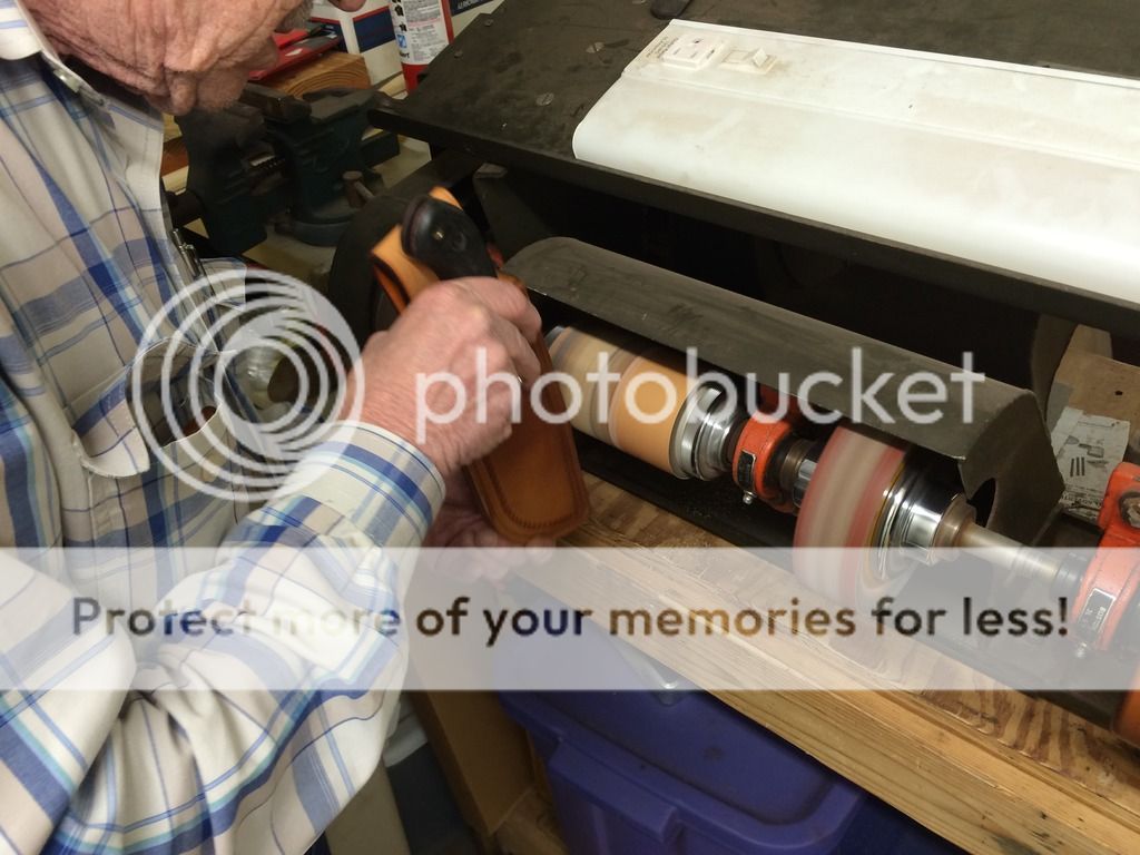

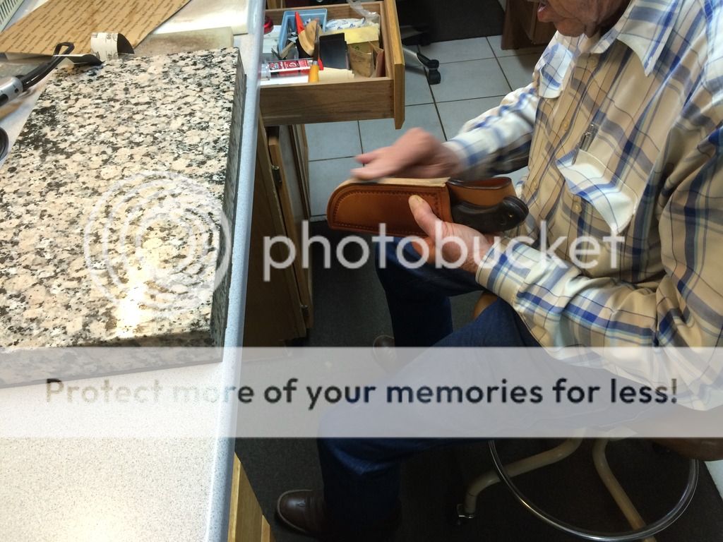

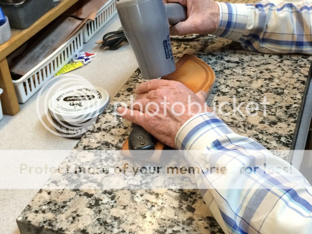

Then the edge and welt went through many steps at the grinder and by hand. First, Mr. Long used a grinder at 50 grit then went back to the shop. I believe he was applying Saddle Soap between sandings, but he was moving faster than I could keep up…and I’m about half his age! Then he hit it with 100 grit, back to the shop, then it was sanded on a worn section of 100 grit. At this point it was already getting a highly polished look. And it was smooth as a baby’s butt!

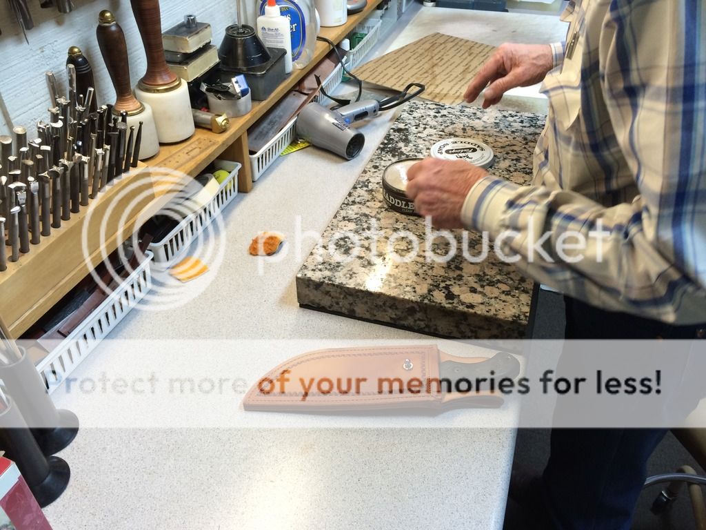

But, we weren’t done. Next came the 220 grit hand sanding, followed by Saddle Soap. Then a final polishing was done with a piece of worn bed sheet. He had that edge as smooth as glass when he was done. Then came the edge dye. Unfortunately, we polished the edge too smooth and not all of the dye took. He explained that a little roughing up with sand paper would open it up to accept the dye, but I chose to keep it as it was. That beautifully polished edge looked great and would be tough as iron.

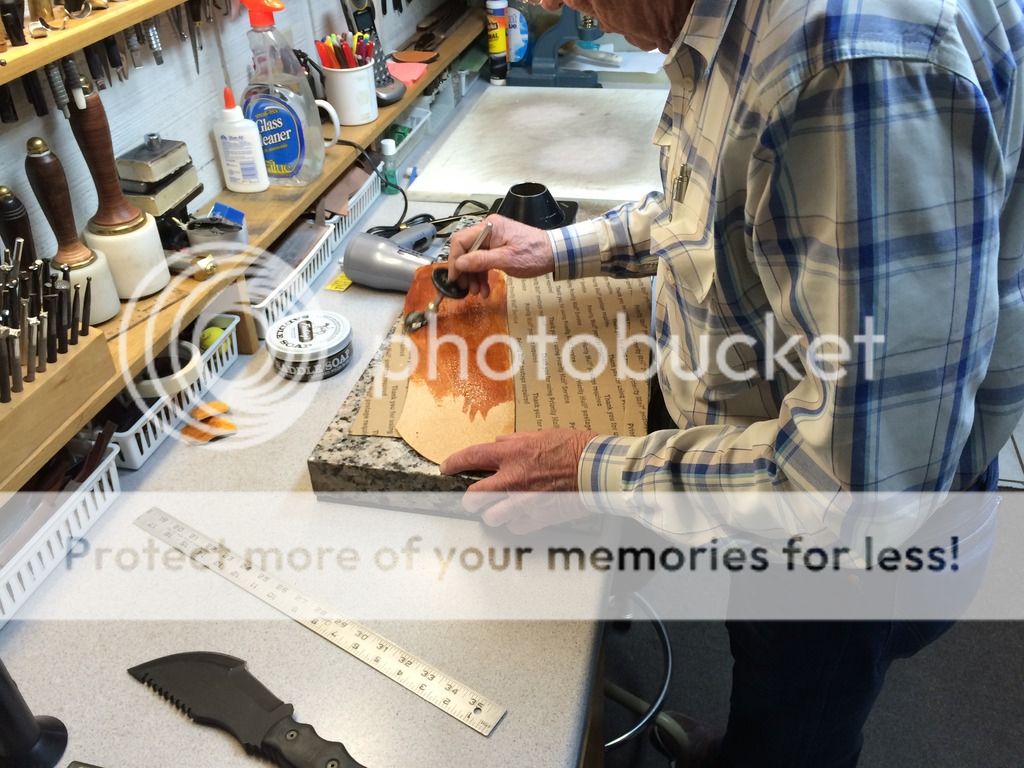

Here, Mr. Long was demonstrating the technique for “lifting” or removing inadvertent marks. Anyone working with leather knows these gremlins well. I didn’t know this trick of wetting and messaging them out. Then the hair dryer sees more use. It’s a handy tool.
I missed many steps. Mr. Long would grab something from his cabinet, swab it on, then it was back on a shelf before I could snap a pic. IIRC, at times he used neat’s foot oil and finished by applying a touch of a lacquer substance over a thin layer of stain. Then it got to dry under the fan and allow the stain to even out a bit.

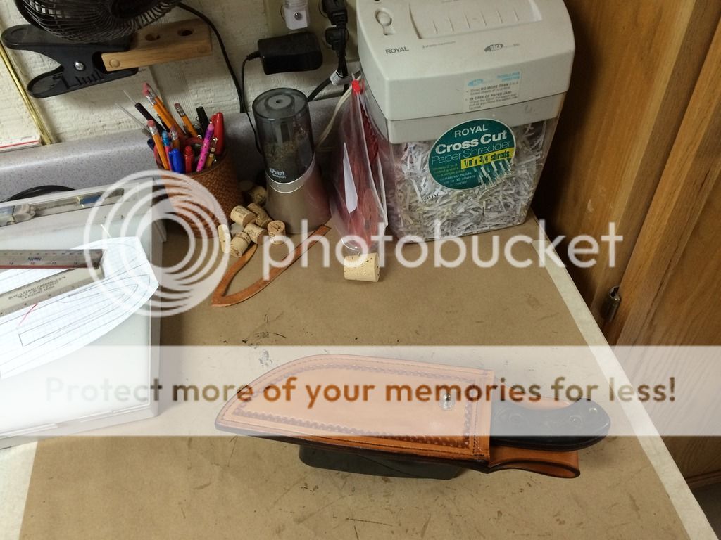

The end result of all this was a thing of beauty. The sheath fit my Tracker perfectly, just as Mr. Long had promised. From the perfect fit, to the nicely finished edges, to the elegant design, I had a perfect sheath. I’m still in awe of it. I love the way it’s just thick enough to hold the knife, but thin enough to show the wonderful fitting job and sensual lines of the design. Slipping my Tracker in it felt like putting a hobo in a tuxedo! As a side note, I believe I have the only Paul Long sheath ever made for a Tops Tracker. It makes me want to buy a Beck, just so I can get a Paul Long sheath for it! Words cannot describe how I feel about this sheath. I just love it. The fact I watched it being created blows my mind.

Just a quick word about three applications of Barge. I thin my Barge to about the consistency of of warm pancake syrup. It's really fairly runny. I do this to get maximum penetration on the flesh side of the leather so that I am bonding much deeper than just surface to surface. The second and third applications then build up and make for a sure bond. Generally after about two or three hours curing the leather will tear before the bond breaks loose. I learned this technique when making saddles and it works well on just about anything that needs to be stuck together.

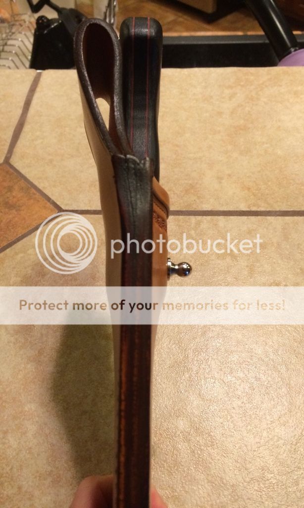

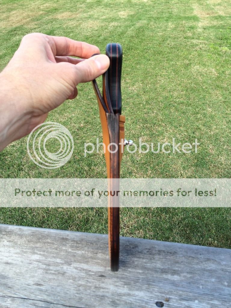

I hope y'all don't mind, but as I find aspects of this sheath which really catch my eye, I'd like to point them out. I mentioned in the original posts that I was surprised by the single, relatively thin welt Mr. Long used. I have continued to be impressed by how good it looks and how slim it feels. Below are two photos of sheaths for the same knife. The black sheath came with the knife when I received it. It is a custom sheath, but never really impressed me. The edge photos demonstrate how the black sheath used multiple welts to build the mouth. I actually counted seven (!) layers at the mouth. Since the handle doesn't set within the sheath body, I'm not sure what purpose this serves. Mr. Long used fitting to accommodate the deep handle placement. As his lining is split quite thin, I consider it and the outside piece one layer. The entire thickness of this sheath is essentially three layers deep, with the skived belt loop adding a slight "ramp" for the sheath mouth. IMHO, this produces a more attractive sheath which, while longer than the black sheath, feels a bit lighter. Again, I hope I'm not boring anyone, but these techniques have really impressed me and I'd like to share this with everyone.
Notice the incredibly thick mouth, which sets below the handle. If anyone can tell me the advantage of this, I'd appreciate it.
This sheath uses a narrow edge/welt to form around the handle.
