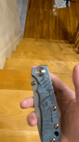

Yesterday I received my plain jane stonewashed SHF, and I wanted to thank all those you recommended it. This is the first time I’ve spent so much money on a knife, and I have to say it is AWESOME! It fits perfectly in my hand, and I can’t stop smiling when I’m handling it.
The only issue I have is….the one-handed opening is EXTREMELY stiff. I’ve never experienced it before. This is a brand new knife, I have strong hands, and 50% of the time my thumb can’t swing the blade open. I’ve tried pushing the thumb stud at different angles with varying success, but the knife fights me regardless.
Is this a common issue with this model? Will it break in over time? I don’t ever fiddle with knife pivots so I’m really hoping to avoid doing that. I know this is a pretty basic problem to have, but like I said I’m in uncharted territory here. Any input would be great!
Mine was like that and it did lighten up a lot with use. I believe it’s an issue with leverage due to the location of the thumb stud. My SHF is smooth but still a little stiff to open but definitely easier than when NIB. Try a little oil and different angles to push it out. Sitting watching a movie and working the action will speed up the break in process.
Mine was difficult at first, but after about 400 or so openings and closings, it smoothed out to the point that it flicks open easily, and is drop-shut. This is the only bronze-bushing knife I've ever had or even held that does that, and the pivot is where it's supposed to be, not loose in the slightest. My CRKs I've owned for years and opened thousands of times couldn't dream of being as smooth as my SHFs are.
Also, actually look at your hand when opening the knife to be sure you aren't inadvertently applying pressure to the lock bar when opening. I've had that issue before, and had to learn to adjust how I held the knife when opening it.
Have you tried pushing straight up along the frame? I know people have had a similar issue with the Umnumzaan.
IMO this is the only correct way of opening frame lock via thumb stud - pushing straight up.

Echoing the others who have said make sure you’re not putting pressure on the lockbar and sliding upwards, but with one additional note: the SHF has a divot in the scale that directs your thumb in the direction it’s supposed to go. Should ease up after a couple dozen openings.
Also, if you’re not used to framelocks and/or strong detents sometimes it just takes time to get your thumb used to it.
Mine was very stiff as well when I received it. After struggling past the initial 'break in period' with not much luck, I made a quick pivot adjustment loosening it up just a tiny bit. With this bit of adjustment the action is now perfect. Was able to achieve without negatively affecting centering or introducing any blade play.
