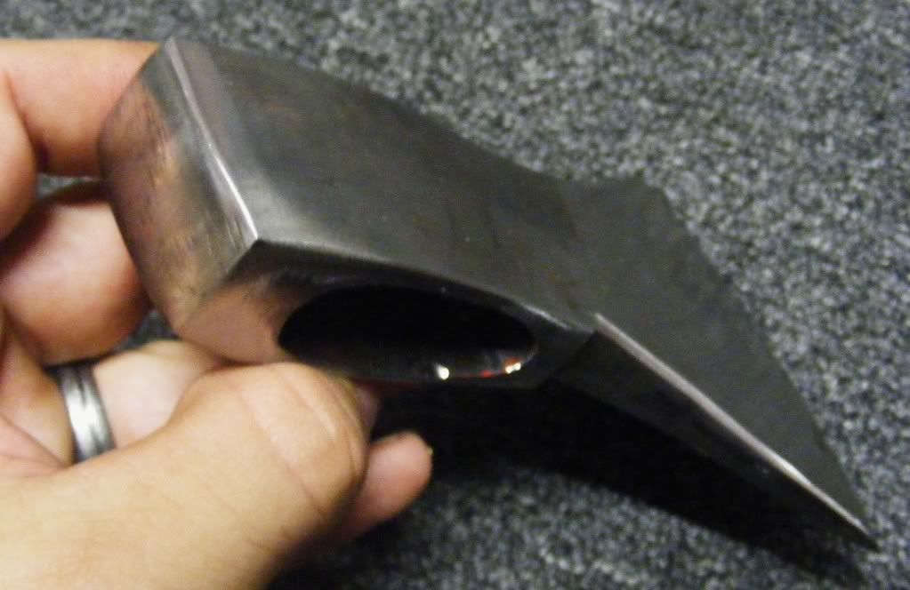

I know the first thing I should do is to smooth out the inside of the collar and fit the handle nicely.
My question is this, I bought a 30 inch handle today and wondering, which of these three hawks would you put this handle on? Or would you cut the handle to a different length?
Next question should I cut the hammer poll off the Rifleman's hawk and if so would this change your answer about the handle.

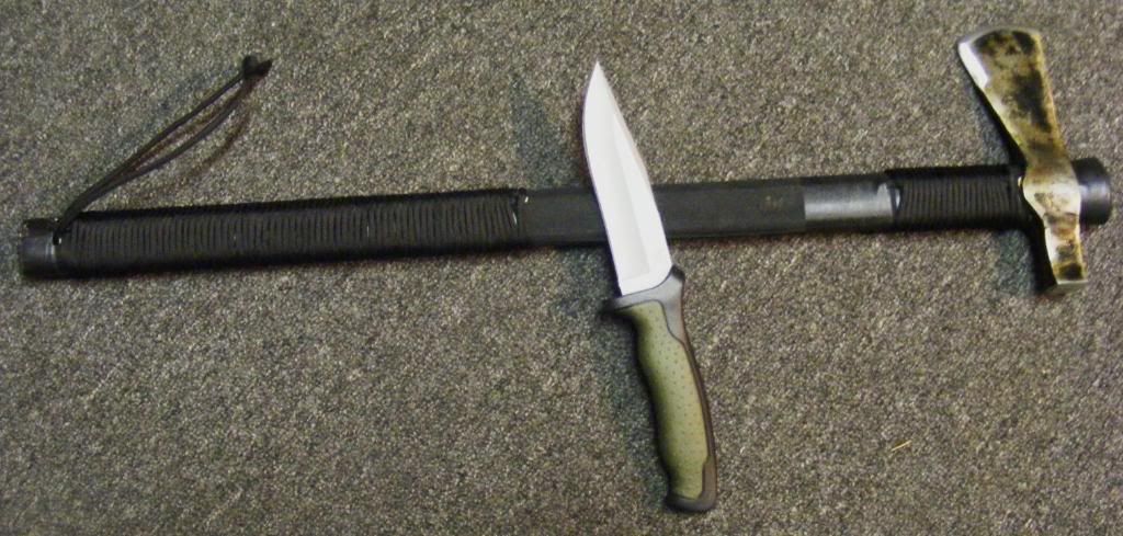

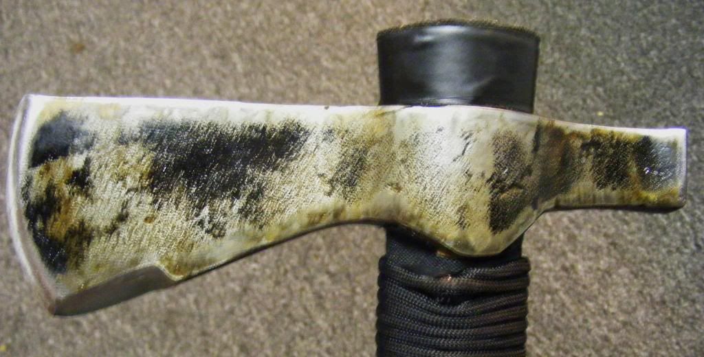

The Trail Hawk is nearly perfect for a tomahawk. If the cutting edge were maybe an inch longer, it would be perfect. I put the 30" haft from a War Hammer on mine and cut it down to 24" so it works well for me.
With the War Hammer for size reference...
I ended up convexing mine and adding a 1" sharpened edge underneath the primary edge. Stripping the head an adding a mustard patina gives it the look of an old, slightly rusty tool without having any rust on it at all.

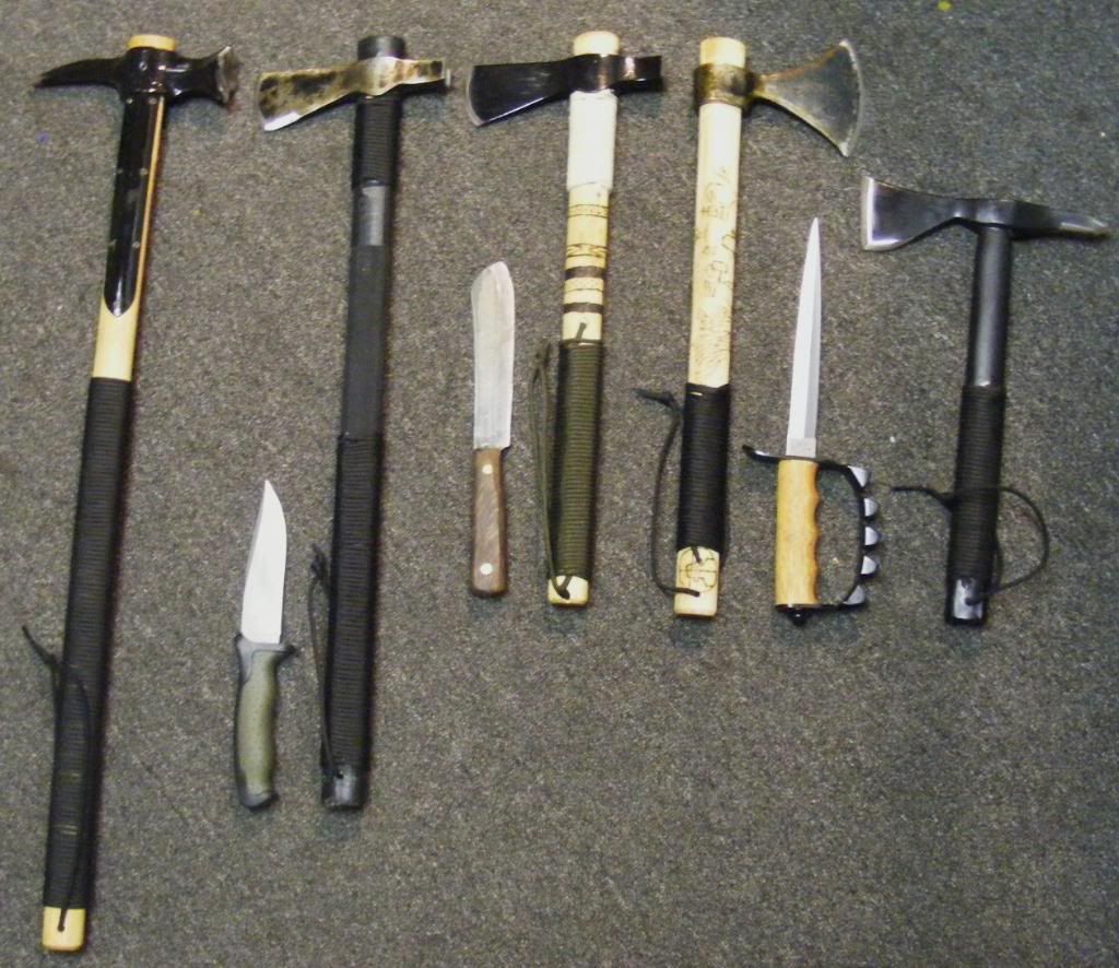

The Rifleman's Hawk is an ideal camp hatchet, and serves as a secondary defensive tomahawk. It's not for breaching or throwing in my opinion, although it's capable of either one. I'd leave the poll on and put a 22" haft on it.
(The Rifleman's Hawk is wearing a 30" handle in this photo.)
War Hammer, Trail Hawk with 24" haft, Trail Hawk, Norse Hawk, Vietnam Tomahawk.
